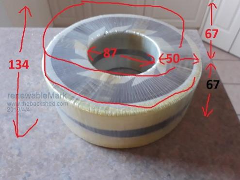

I have just completed 3 layers of secondary on my core and write from experience here.
I would be very happy if the final hole size stays north of 50mm diameter.[/quote]
In theory we should arrange things so that primary and secondary each use up half the available area of the hole. It never quite works out like that in practice, but its something to keep in mind.
Now an 85mm hole has about 56.75cm sq area available.
And a 50mm hole about 19.63 cm sq area.
So your secondary takes up roughly 37 sq cm area leaving only 20 sq cm for the primary.
That is not good !
I think you need to be a bit less generous with the mylar, or find a way to flatten each layer within the hole.

Thanks Tinker and Warp re wiring.
Using the pumped up balloon while curing seemed to really work well on the bigger toroid.
One other thing we can do is separate the spot weld on the inner of the core, unwrap some material and add it to the outside. I'll never get it as tight though.
If that is done will it change the calculations? It's the same amount of material but it will be different dimensions.

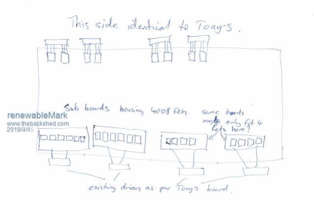

So that brings us to how it will all go together.

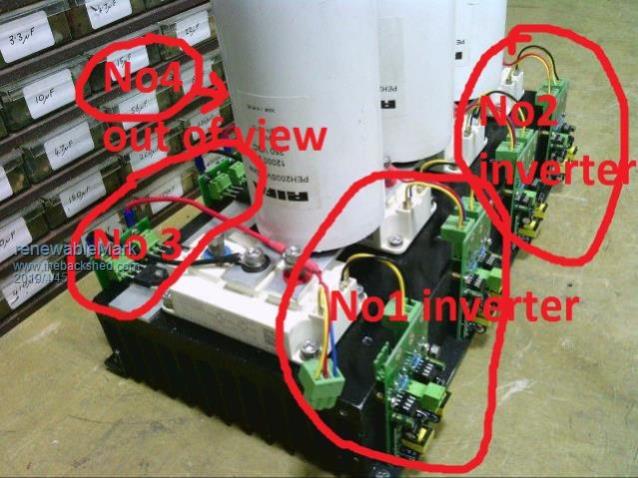

With Tony's design using higher voltage the IGBT's are suited but at 48v the 4008's will be a better option (Tony's advice)
So if you look at Tony's machine he has 8 little fet/igbt driver boards.
The igbt's are plugged in and the fets are simply screwed directly from the driver board.
The idea I had since fets will be required was on the side where the igbt's are we could make a pcb that houses multiple 4008's.
How many will we need?
In the design it will need to accommodate the big caps, Tony advised provision for 5 would be wise and perhaps just use three to begin with to see if that's sufficient.
Poida, that would all work with the Warp control board, but will that hardware suit your arduino driven design?
Can a setup be made that we can use both control boards on?

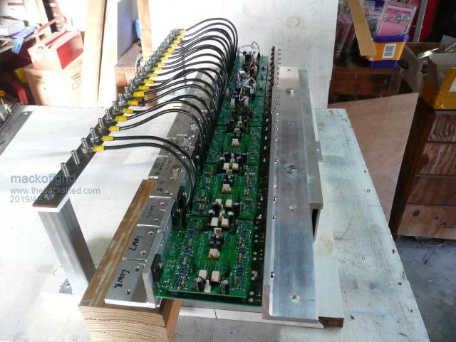

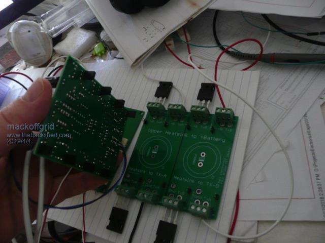

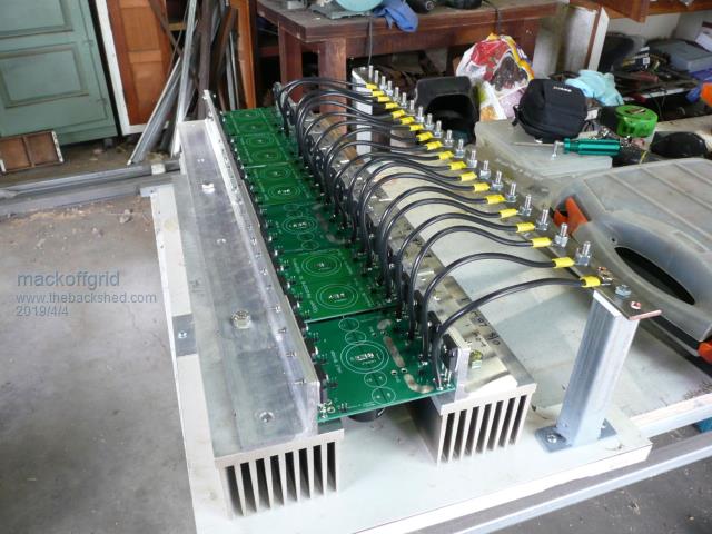

Mark: I have one solution, I think Tinker is doing something else?
I have modular Half bridge pcb and Full bridge PCB (100mm x 100mm). These pcb have no electronics on them apart from the FETS to maximize copper. Their driver is another pcb that plugs on top of them.
Which goes together like this. (the little drive pcbs are not plugged in on this photo.
I have put capacitors underneath.
Then with the driver pcbs plugged in.
The top heatsink connects positive battery to all the FETS.
The bottom heatsinks are sliced up to suit transformer legs.
I have used 4mm2 wire (one per FET) to connect to the negative buss.
The PCBs are on my Github if anyone is interested.
https://github.com/mackelec/StepInverter
I'd be interested if there are other ideas out there.
Yes it will, less core cross section requires more turns, but we also get a larger hole which provides more room.
Klaus's concerns are quite valid, so we need to look into this a bit more.
As you have already just fitted four layers of 1.6 wire to your larger core, can you measure or estimate how much that reduced the hole size ?
Now that primary wire I suggested has an O.D. of 7.25mm I have some of it right here in fact.
In a perfect world we can fit 24 turns onto the first layer, then 18 on the second, 12 on the third, and 6 on the fourth, leaving a 7.25mm hole in the middle for one extra wire.
So 24 + 18 + 12 + 6 + 1 = 61 turns. A perfect wire bundle !
And that requires nine wire diameters or 65.25mm.
It should all pack through a 70mm hole with a bit of grunting and swearing.
Now the sixty four dollar question is, are we going to end up with a 70mm hole after fitting the secondary ? And if not, how much of the inside of the core do we need to remove.

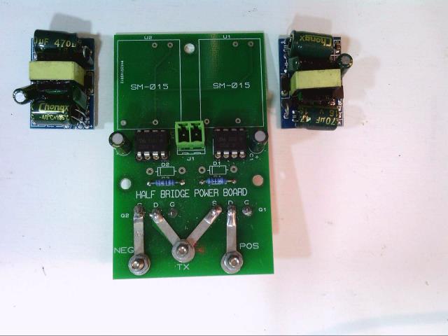

Posted: 10:42pm 03 Apr 2019

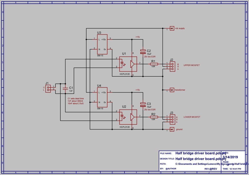

Eight of these would be all you need to get started.
Fairly primitive, but it is what I am using right now.
Eight boards will get you a fully functional working inverter but of limited power output initially.
I will e-mail Gerbers to anyone that requests them via e-mail.
I cannot attach Gerbers to a Forum post or a PM, so it will have to be by e-mail.

Just measured my 6kw core, that had 4 layers added to the ID.
It started at 100mm and ended up at 80mm.
That was with the full 128 turns all fitting on one layer each without having to go over themselves to complete the 128, they all fitted in side by side on the same layer, even the last one.
So if the 104 turns all fitted in side by side on one layer, including the 4th winding it should in theory reduce the ID from 87 to 67mm
Warp, at what voltage do you suggest to use IGBT's? I am currently harvesting lithium 18650's and contemplating my overall system voltage.

I'll hack one up on perfboard I think. Maybe even use IRS2004 half bridge drivers, to switch the optocouplers, instead of 74 series logic. The 2004 takes one input and generates complimentary output with deadtime and can drive 130mA, more than enough
for the diodes to light up.
I intend to run MOSFET based full bridge switches, with isolated DC supply for low and high sides. Many run at non-ground level references, so might as well bite the bullet and get a dozen of the cheap isolated converters Warp used.
Edited by poida 2019-04-05

Posted: 03:29am 04 Apr 2019
You will need eight half bridge boards and sixteen (!) of those small isolated supplies. Its not too bad though, all of the electronics including all seventeen small isolated supplies draw a combined total power of five watts with all the opto isolators running. Anything extra above that is just transformer magnetizing current.

Warp, could you point me to a link where to buy the isolated supplies?
