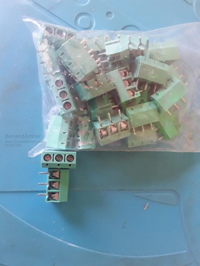

Monkey see monkey do
If I see or read a really good idea and I can afford it
I jump on it
Apparently these will come in really handy for meEdited by BenandAmber 2019-03-29

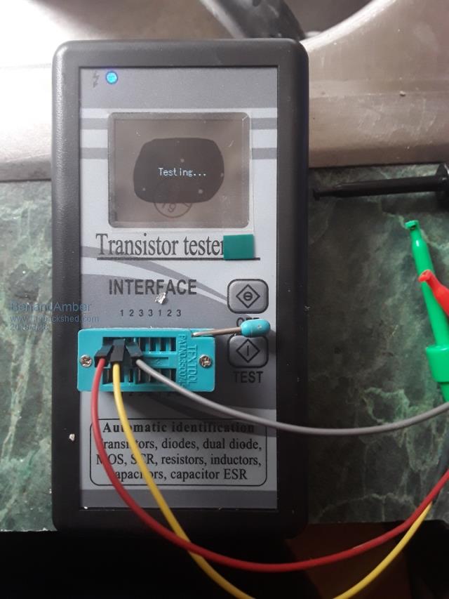

Another thing I'll be needing when mosfets come in I bought this off eBay for under twenty bucks it's very light feels very cheap made but it seems to work well
I was pretty impressed that tells you the pinout tells you the voltage capacitance and tells you what kind of component it is
I'm not understanding how the mosfets work
I'm getting confused with the source and drain
It don't take much by the way
I'm going to look for a class or two on mosfets to take
Then I'm going to get started right back on this little board
I want to make sure that I get it up and running right and have a good understanding before I go to the big boardEdited by BenandAmber 2019-03-29

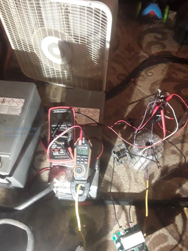

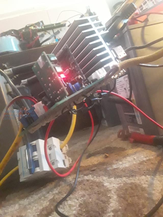

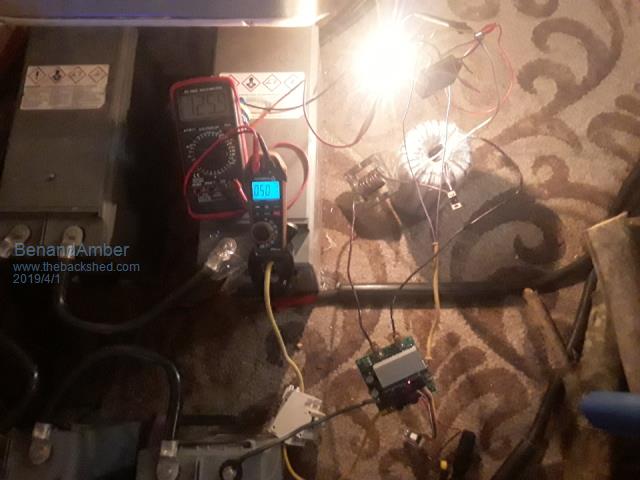

Success
We changed out irf p 2907z to hy4008
We put 14 gauge wire overall input and output traces soldered it all in where no bare wires showing
We are using the 15v tvs zener diodes that the one and only alsome Poida instructed us to do along with all the other modifications he suggested
poida wasn't the only one that we got good advice from and we appreciate all of you guys and gals that gave us good advice along the way without all you guys this wouldn't have been possible for us
We really like this forum and the good people on it and hope 2 have more successes in the future and maybe one day get good enough to give a little advice ourselves
Peace love and good health to all

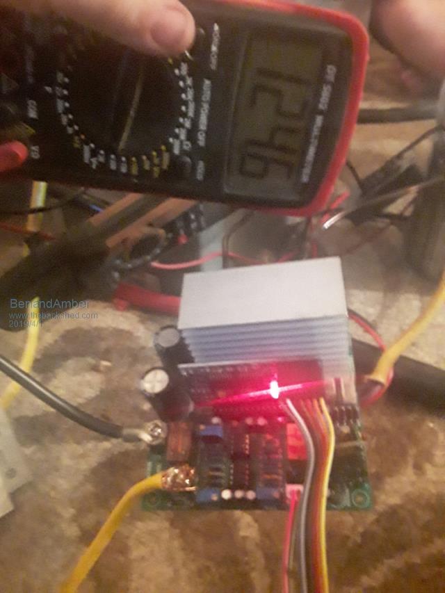

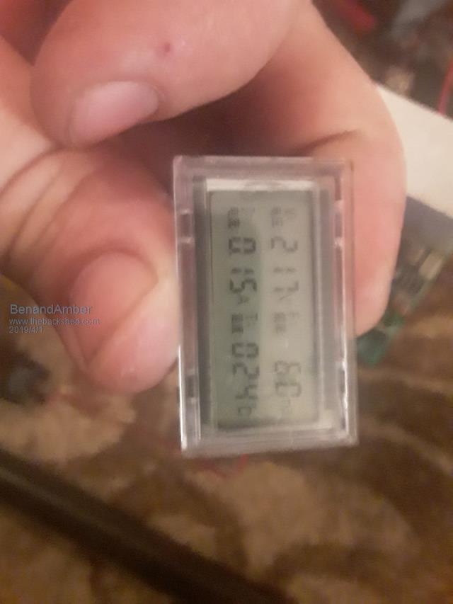

Running a light
Running a box fan
This is the little tiny not worth buying screen that comes with EGS 002 card
none of the information on it is the same as my multimeters the temperature and Hertz is right
my voltage is a little high I need to set it down a little bit more 126 volts at end of testing
the idle current is below half a amp o.39
the temporary inductor filter makes a
funny noise
I didn't run it very hard tonight
I did let it run for a couple hours
During testing the mosfet stayed room temperature without a fan on themEdited by BenandAmber 2019-04-02

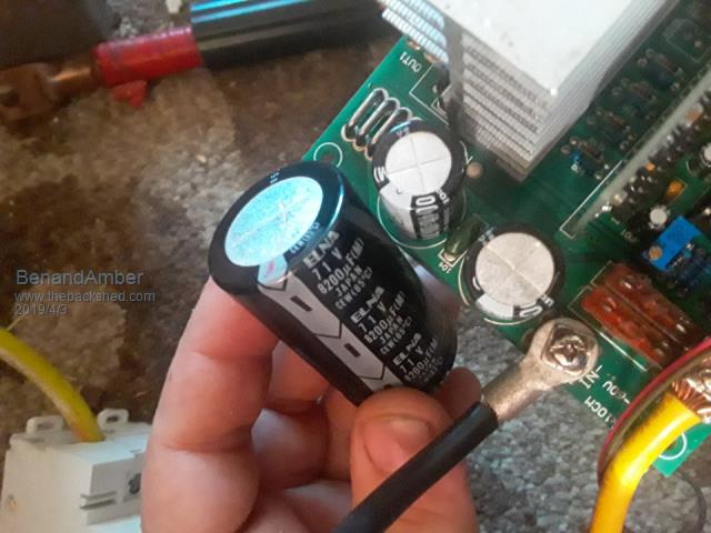

Now a new question
I have a capacitor i only have one of them it is 8200uf
would it be okay to add this without taking the other two little capacitors off
or should I take them off i only have this one bigger one
there is a little tiny ceramic capacitor in between the other two tiny capacitors on the board thay are 470uf

I don't think it would be good to run this at 20 amps120v all the time
but the little board does it and doesn't
complain
the mosfet do get pretty warmin just in 3 or 4 minutes of running at this high of amps
with just a hair dryer around a thousand Watts they barely get warm
The only thing left to do now is mount in the Box it goes in
when I get all that done I'll post pictures
