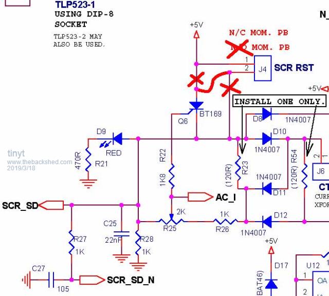

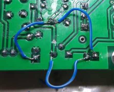

It is very hard for me to see if the trace at the J4 pin was cut. Please confirm.
If the simulated AC current is zero, I think there should be no voltage at the scr gate and cathode. Here is the schematic section with the intended mod in red.
I am still checking my mod instructions for errors.
Edited by tinyt 2019-03-19

Tinyt,
my bad. I did not do that other trace cut.
It works perfectly.
I really must pay attention to my instructions more often.
If the switch is left open, the inverter can be restarted manually
but the SCR protection is not enabled. We need to source a decent quality
NC PB.
The drawing above shows what we need, thanks for that.
I could not get my head around it when looking at the original schematic.
It still is 0.16V at the gate with zero input to J6. This is not a problem since the SCR triggers at about 0.83VEdited by poida 2019-03-19
poida
Joined: 02/02/2017
Posts: 1507
Posted: 03:12am 18 Mar 2019
I think the 0.16V might be coming from SCR_SD_N which is a 5V source from nano1 pin D6
This flows through R27 (1K) then R28 (1K) to ground.
at R27-R28 node it will be 2.5V, maybe, then this goes to the R25 trim pot then the wiper takes some through R22 to the SCR gate.
The current drawn by the J6 input from the 0 - 5V signal test is only about 0.5mA
This is a tiny load for any current transformer to deal with.

Posted: 03:19am 18 Mar 2019
  poida said   I think the 0.16V might be coming from SCR_SD_N which is a 5V source from nano1 pin D6
Thanks poida, I did not look at the overall schematic were that voltage is coming from.

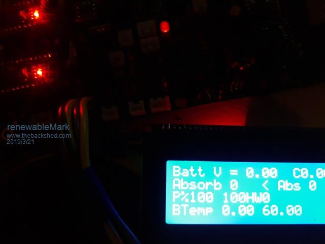

OK got the machine running with full fets and caps, no bang, ran blowheater and shed air con, perfect wave.
Can't get LCD to work. previously did
Tried the lcd in another device and it works fine.
I included lc 57...library.
Cheers Caveman Mark
Off grid eastern Melb

renewableMark
Joined: 09/12/2017
Posts: 1679
Posted: 05:02am 21 Mar 2019
Yes that lcd went in the bin.
Machine runs properly so the code is in the nano's ok
LCD lights up, it works in the mad control board so it does function.
I beep tested sclsda lines and they look fine.
Updated usb drivers so got me stuffed.
Cheers Caveman Mark

renewableMark
Joined: 09/12/2017
Posts: 1679
Posted: 07:05am 21 Mar 2019
Yeah the machine works fine so far, haven't given it any real curry, only 2kw load so far.
The shed ac didn't stuff the wave up like to 8010 did, so that is very promising.
I don't want to let it loose on the house till I get the lcd working though as it needs the parameters monitored.
Edit, I give up, re installed arduino software started from scratch, same result.
Initialise arduino lcd lights up, arduino flashes a few times and lcd goes blank.Edited by renewableMark 2019-03-22

renewableMark
Joined: 09/12/2017
Posts: 1679
Posted: 09:27am 21 Mar 2019
Tried the mad gti nano in the nanoverter board, that works, gives out a screen, so the wiring is fine, something in how the sketch is being put on there, got me stuffed.
Poida, I might need to to burn an arduino for me.
Cheers Caveman Mark

renewableMark
Joined: 09/12/2017
Posts: 1679
Posted: 03:43am 22 Mar 2019
Thanks Tinyt I tried that but didn't work.
I can load the mad gti software onto the nano 2 and the screen displays correctly with three different screens, there must be some difference in the sketch that allows the Mad one to work.
