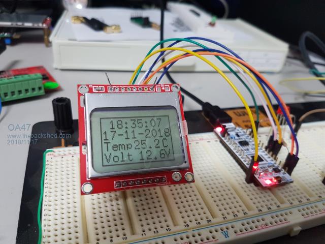

Peter, just to report in, the 5110 display running on the L4. Works a lot better when you re-read your post and realise it is supported on the 2nd port.
I didn't disconnect the LED on the CLK pin 26 and was wondering if you thought it would hinder the operation?

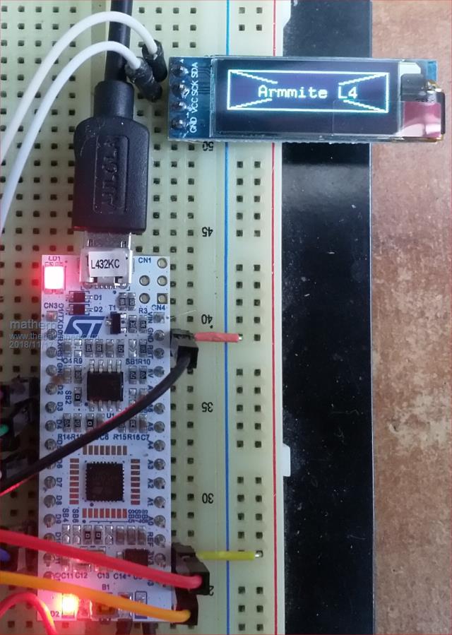

2018-11-17_203330_ArmmiteL4.zip
  Quote  Works a lot better when you re-read your post and realise it is supported on the 2nd port.
Sorry - should have been clearer - all displays use SPI2, the LED doesn't seem to cause a problem
  Quote  With any newer version the L4 will not run when the USB is unplugged.
Haven't made any changes that could affect this - wouldn't know how. Please try both the hex and bin in the attached using ST-LINK and/or mbed and see if there are any differences
  Quote  Its nearly there. I used the included driver but need to send one more initialisation instruction as seen in the fixme sub below. Once fixme is run it behaves pretty well.
Don't understand this as the correct code is in the source. I've got a display on order so will diagnose further when it arrives
I2C_Send_Command(0xAE);//DISPLAYOFF
I2C_Send_Command(0xD5);//DISPLAYCLOCKDIV
I2C_Send_Command(0x80);//the suggested ratio &H80
I2C_Send_Command(0xA8);//MULTIPLEX
if(Option.DISPLAY_TYPE==SSD1306I2C)I2C_Send_Command(0x3F);
else if(Option.DISPLAY_TYPE==SSD1306I2C32)I2C_Send_Command(0x1F);
I2C_Send_Command(0xD3);//DISPLAYOFFSET
I2C_Send_Command(0x0);//no offset
I2C_Send_Command(0x40);//STARTLINE
I2C_Send_Command(0x8D);//CHARGEPUMP
I2C_Send_Command(0x14);
I2C_Send_Command(0x20);//MEMORYMODE
I2C_Send_Command(0x00);//&H0 act like ks0108
I2C_Send_Command(0xA1);//SEGREMAP OR 1
I2C_Send_Command(0xC8);//COMSCANDEC
I2C_Send_Command(0xDA);//COMPINS
if(Option.DISPLAY_TYPE==SSD1306I2C)I2C_Send_Command(0x12);
else if(Option.DISPLAY_TYPE==SSD1306I2C32)I2C_Send_Command(0x02);
I2C_Send_Command(0x81);//SETCONTRAST
I2C_Send_Command(0xCF);
I2C_Send_Command(0xd9);//SETPRECHARGE
I2C_Send_Command(0xF1);
I2C_Send_Command(0xDB);//VCOMDETECT
I2C_Send_Command(0xA4);//DISPLAYALLON_RESUME
I2C_Send_Command(0xA6);//NORMALDISPLAY
I2C_Send_Command(0xAF);//DISPLAYON
Edited by matherp 2018-11-18

The option list for LCDPANEL SSD1306I2C32 shows a couple of extra characters. Could these be causing the code not to match the if(Option.DISPLAY_TYPE==SSD1306I2C32)
condition.(They are not ## but something shows up. Did not show in the post so I added ## to show where they appear)
option list
OPTION LCDPANEL SSD1306I2C32##, LANDSCAPE
Gerry
F4 H7FotSF4xGT
Posted: 01:19pm 17 Nov 2018
  Quote  Could these be causing the code not to match the if(Option.DISPLAY_TYPE==SSD1306I2C32)
Well spotted Corrected here:
2018-11-17_231911_ArmmiteL4.zip
My display just arrived and works with this release

Frank,
I have used OPTION LCDPANEL N5110, L,11,10,9
So my interconnections are
Connection L4 5110 MMBASIC
SPI_CLK (D13) 7 PIN 26
SPI_OUT (D11) 6 PIN 28
DC (A4) 5 PIN 11
RST (A3) 4 PIN 10
CE (A2) 3 PIN 9
GND GND 2
+3V3 3V3 1
Here is the CODE
' Program to test Nokia 5110 LCD on ARMmite L4
' Option LCDPanel N5110,L,11,10,9 set on command line
SetPin 6,AIN
Dim T$, D$, I, Tmp,V
CLS
Box 0,0,83,48
T$=Time$
If T$ <> Time$ Then
D$=Date$
V= 12.6 'Pin(6)/11.1 'resistor divider between Vin and GND
Tmp=25.4 'TEMPR(22)
Text 10,1,T$
Text 2,12,D$
Text 3,23,"Temp"
Text 36,23,Str$(Tmp)
Text 70,23,"C"
Text 3,34,"Volt"
Text 41,34,Str$(V)
Text 72,34,"V"
End If
Loop
And if any of the Aussie shedders need a 5110 display quickly, Jaycar stocks them as:
XC4616 64X48 DOT MATRIX @ $19.95
Edited by OA47 2018-11-19

  matherp said   My display just arrived and works with this release
I still have a little mystery with mine.
OPTION LIST displays OK and the fix for attempted printing for x<0 is good.
I could not get it to work without fixme. It turned out I only needed the
I2C OPEN 400,1000
line so the rest of setup is good.
It seems like the SSD3306 driver will use I2C as is, if already open.
I was not using any pullups, so added 10K to 3.3v. This seemed to not make any difference,the driver does not work unless I open the I2C first.
What speed is the driver opening the I2C bus, what value pullups, if any, do you have?
Gerry
F4 H7FotSF4xGT
Posted: 08:45am 18 Nov 2018
One more try.
2018-11-18_184313_ArmmiteL4.zip
  Quote  What speed is the driver opening the I2C bus, what value pullups, if any, do you have?
400K, none - the chip applies internal pullups
disco4now
Joined: 18/12/2014
Posts: 1162
Posted: 10:20am 18 Nov 2018
  matherp said   One more try.
Yes that has got it now!
Thank you.

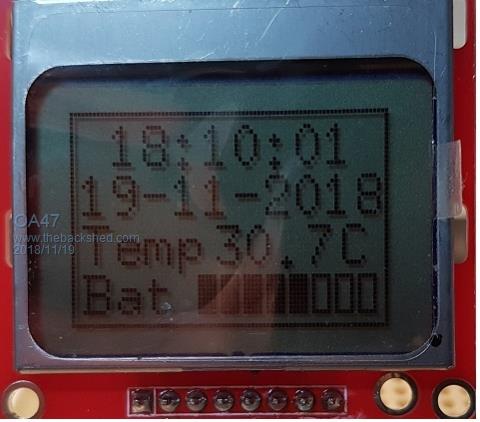

As I intend to battery power this project, I thought the display needed a battery bar-graph. I can post the code snippet if anyone is interested.
