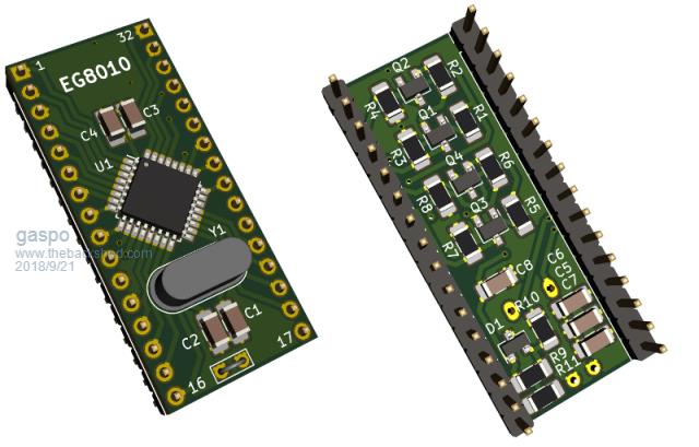

Wiseguy, added TL431 and a combo through hole/SMD crystal. I do not think there is more room for anything else. Attached are all necessary engineering files for manufacturing.
2018-09-21_223224_EG8010-adapter-files.zip

There is no need for cutting. PCB makers like JLCPCB let you panelise smaller boards onto the 100x100mm PCB with V-cuts between them. You just snap-off the boards from each other and file the edges a bit.
JLCPCB charge about $A30 for 10 100x100mm PCBs with 2-5 days DHL shipping. You can fit 10 adapter boards onto one PCB - so about $3 per 10.
I could order and post it if more people interested or you can pick it up if in Perth.
Gerbers with more GND vias.
2018-09-22_003535_eg8010-adapter-gerber.zip Edited by gaspo 2018-09-23

Hi Gaspo,
Looks a nice adapter board for keeping any shoot through under control.
Yes please, I would like to purchase a few boards from you to test. I am in France.
I am doing 3 OzInverters at present, and never had any problems with my boards, but as 'Warpspeed' has mentioned there are many variable's at play.
But I can see that this adapter board Modification may be an extra sweet solution to any possible problems in the future.
Thanks to you and 'wiseguy' for a sensible discussion.

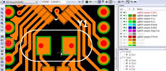

Nice work Gaspo. One comment if I may. Looking at the footprint for the crystal, it seems that the top copper pads are rectangular and a bit too large. They are also exposed.
If the crystal is packaged in metal, the bottom metal case of most of them extend too close to the pins. If the crystal is soldered with its bottom flush to the pcb surface, the case can short the pads together. Maybe make the top pads into small anular rings (as small as possible) or make the top solder mask cover the top pads up to the drill holes. No need to change the bottom pads. Just my suggestion.
Edited by tinyt 2018-09-23
Posted: 09:22pm 21 Sep 2018
Excellent work there Gaspro.
The safest solution to the crystal problem is to fit an proper insulating spacer between the crystal and the board. These are readily available at very low cost.
Best way might be to buy a bag of these spacers and provide one with each circuit board. These are particularly good as they are nice thick ultra tough nylon, not just something stamped from an ultra thin plastic sheet:
https://www.ebay.com.au/itm/100pc-TQ-06-Crystal-Oscillator-Insulator-Washer-11-2x5-0x1-0mm-PG-HC-49S-HC-49-/130871999210 ?hash=item1e78943aea
Edited by Warpspeed 2018-09-23

For those wanting to take advantage of the better quality Vref supply, the TL431 part needs a minimum of 1mA to regulate to spec so Pin 17 of the adaptor board will need to be connected to the 12V line, the 5V line supply on pin 17 is a no go if using the TL431.
A series resistor of 5K1 gives a current around 1.3mA - I would suggest though to use a 3K3 and have a spare 1mA for the input current of Vref which does not seem to be defined on the EG8010.
Thanks Gaspo job well done - I was unsure if you were just offering the layout to the group - if you are happy to continue on that is great. I do want to get back to my own design. I must be a tight wad I was going to get the boards from PCBWay I believe they are $5 for 10 off 10x10cm boards but last time I asked for a quote on V-grooving it was like $60 more. Thanks for the information about JLC.
As it appears to be getting closer to manufacture I will take a more serious quick look tonight - I have commitments all day today.

  tinyt said   Nice work Gaspo. One comment if I may. Looking at the footprint for the crystal, it seems that the top copper pads are rectangular and a bit too large. They
The reason for the square top pads on the crystal is that both the SMD and the HC49 packages can be used. I have these SMD crystals that I want to use.
You can solder HC49 crystal so there's some gap between the board and the metal can or use some kind of spacer as Warpspeed suggested.
Wiseguy, I have no problem ordering the boards as I also would like to get the improved adapter board. I will keep couple of PCBs and send remaining 8 to others.
I could order more if there is greater interest.
JLCPCB offer free panelisation if done by them. I like their ordering page where upon uploading the zipped gerbers it will show you the board in the online gerber viewer.
Clockmanfr, I can send to France but you'll need to bear the cost Australia Post. The 3 PCBs are about 100g.Edited by gaspo 2018-09-23
Now I understand. Another option is if using the SMD, solder it at the bottom or if using the HC49, solder it at the top.
If the top pad is unchanged, use spacer per Warp or temporary shim when soldering. Or if the top pad is changed per my suggestion, no need for extra part.

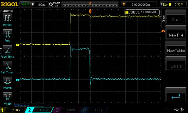

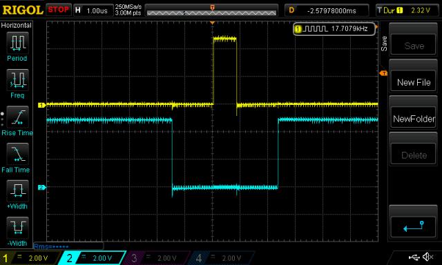

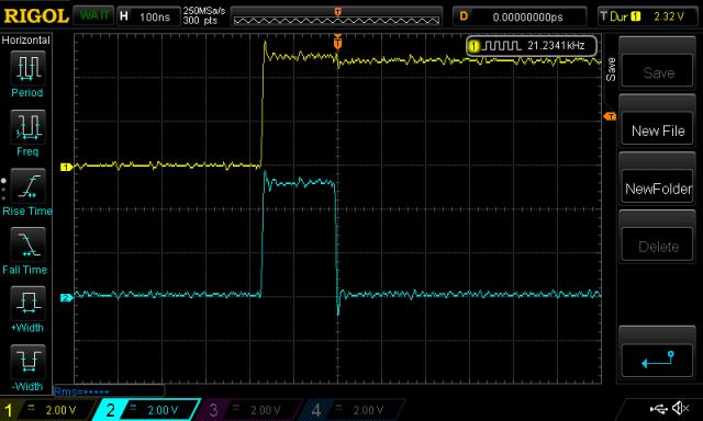

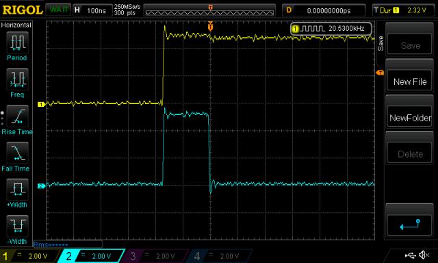

This is just a follow up for Tinyt:
I had a look at the problem with all 4 dead time settings.
Here are the 4 DSO captures of the same event, being resume after over temp.
in order they are:
500ns
300ns
1us
1.5us
I see no difference in any of these.
I confirm the dead time setting of the last one with this:
See the 1.5us dead time either side of the yellow pulse high.
