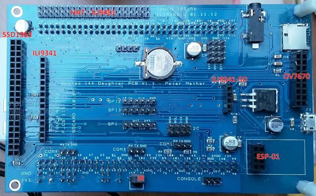

I plugged a 4.3" SSD1963 LCD into the H7-144 backpack. It makes for a pretty display. Unfortunately, I haven't been able to run GUI CALIBRATE successfully. It gives me the target, but does not respond to touching and releasing with a stylus, no matter how long I hold it.
Here are my options:
> option list
OPTION AUTORUN ON
OPTION LCDPANEL SSD1963_4, LANDSCAPE
OPTION TOUCH 112, 56
OPTION SDCARD 110
Do I have something wrong? Of course, soldering error or bum LCD are possible.
disco4now
Joined: 18/12/2014
Posts: 1162
Posted: 02:47am 24 Feb 2019
The touch for the SSD1963 would be the same as ILI9341
OPTION TOUCH 56,123
The ones you show are the ones for the HAT header and the ILI9481
F4 H7FotSF4xGT
Posted: 02:53pm 24 Feb 2019
Thanks, that did it. But I'm confused again (it seems to be happening a lot). I thought the HAT header was the 40-pin, double-row header, and that's the one the SSD1963 display is mounted on--not the 14-pin header for the ILI9341.
Anyway, all good with respect to this display.
