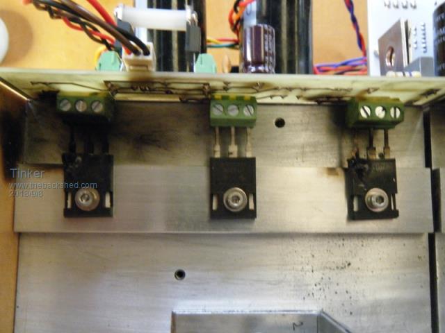

This is what happened: Big bang, bright flash and fire. The most spectacular blow up yet .

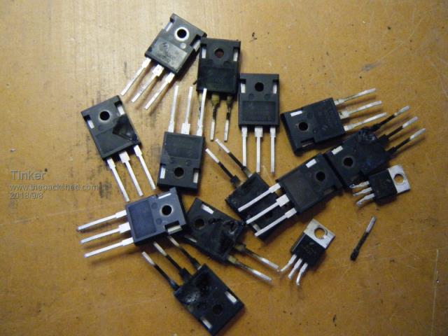

All of the 12 mosfets self destructed, the ones at the low side caught fire by the time I disconnected the power.

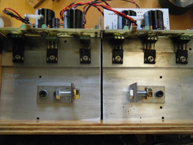

This close up shows that the screw terminal idea works well for a blow up but the terminal got too singed by the fire so three of them require replacing. That was the only solder job I had to do, the PCB had no damage and cleaned up nicely.
Two of the totem pole transistors (TIP42C) also shortened on the low side but as these are on screw terminals are easy to replace.
Here are the casualties:

[quote]that the screw terminal idea works well for a blow up but the terminal got too singed by the fire so three of them require replacing.[/quote]
It seems to be the exploding legs that burn the screw terminal blocks. If the legs are kept original full length, the mosfet body is a fair distance from the terminal block.
Anyhow I had this idea of buying some fairly thick wall teflon high pressure tubing and slipping a short length over each mosfet leg. That should contain the fire and smoke and protect the terminal block and heatsink somewhat. The protective metal shield is a good idea too.
So I ordered some 2mm bore 4mm od teflon tube from e-bay, but what arrived were five integrated circuits instead that I did not order. When stuff arrives from China its never certain which seller it came from, so I could not be sure which order had been screwed up.
Somewhere in the world there is probably someone that ordered some real time clock timer chips, but instead received a small coil of clear tubing.....
This is what I ordered: https://www.ebay.com.au/itm/1M-PTFE-Teflon-Tube-2mm-ID-4mm-OD-For-1-75mm-Filament-3D-Printer-RepRap-FT-/142771980470?var =&hash=item213ddf88b6
I have just ordered some more.Edited by Warpspeed 2018-09-10

Today I found that 9 out of the 12 gate diodes also blew, I had used IN4148's there and they worked fine.
Have not yet tested the gate drivers or the EG8010 outputs to see if they survived.
Warp, The HY4008's had the full length 'legs'. Its the source leg that melted off at the mosfet body on some. It would have got hot enough for the plastic housing of the terminal to start smouldering where the 'leg' entered. I'm not sure if a teflon sleeve would help there as I think the 20A terminal rating was exceeded by a fair bit briefly.

I am very pleased about the physical attachment of the mosfets in my inverter. This certainly makes their replacement soooo much easier than you lot of the solder them in brigade. The charring of 3 of the 12 terminals I did not foresee and I will try warp's teflon sleeve idea since I have some here.
The PCB has no charring/ burn marks whatsoever.
