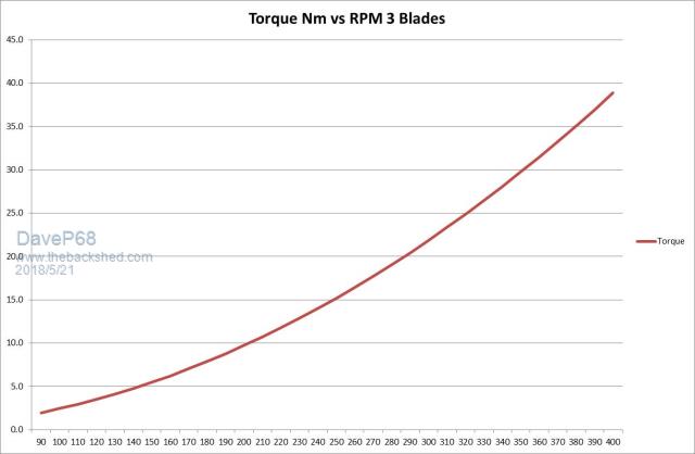

This is a graph of Torque vs RPM on a set of GOE 222 blades 3 m diameter TSR 5.7
Note the Torque range is from around 2.5 Nm all the way up to 39 Nm. I suspect your blades will have a higher TSR of 7 to 7.5 so upper RPM will be around 500 with Torque being about 25 Nm.

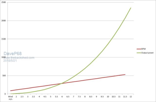

Here is another graph of Wind Power vs RPM, note the RPM is linear and the power follow the cube law of the wind speed.
This is exactly what MPPT is trying to achieve.

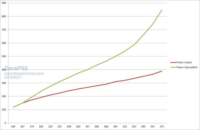

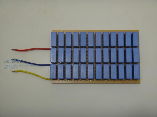

On a separate note you asked about how to boost the power output of F&P stators. This can be done using resonance capacitors and is best done on at high voltage to keep the capacitor size to a minimum.
Capacitors I've used in Delta mode, 3 sets of 6 uF (12x 0.47 uF) AC rated at 305 V.
A graph of the difference in power output with them added 852W at 375 RPM and without 390 W at 375 RPM.
The resonance capacitors over double the output power by increasing the working voltage. They also over double the amount of torque the stator can take.
There is a small drop in output efficiency but that is of no concern at they only operate at high power levels where there is power to burn
At low to medium power levels the stator efficiency remains > 80 %.
There is a catch, if the RPM is able to go to high and go past the peak resonance point the Torque will start to drop off again.
The idea is to always stay on the low side of peak resonance which can provide up to a 2.75 times gain in power. Plenty of head room to stay safe anyway.

Your cap system, is that something similar to what is on here, or quite different?
https://www.thebackshed.com/windmill/articles/GordonsCapMod.asp
These caps you connect to the 3 phases of the stator, before the rectifier I am guessing, and are connected all the time yes?
I wont do this immediately, but it sounds truly awesome how you are making the most of this.
Are they something like this?
https://www.aliexpress.com/item/Free-Shipping-10PCS-NR3010-180M-18UH-3010-SWPA3010-SMD-Glue-inductance/32785406144.html
You have them wired in Delta you said? Can you take a photo of the back of the board? Very interested :)

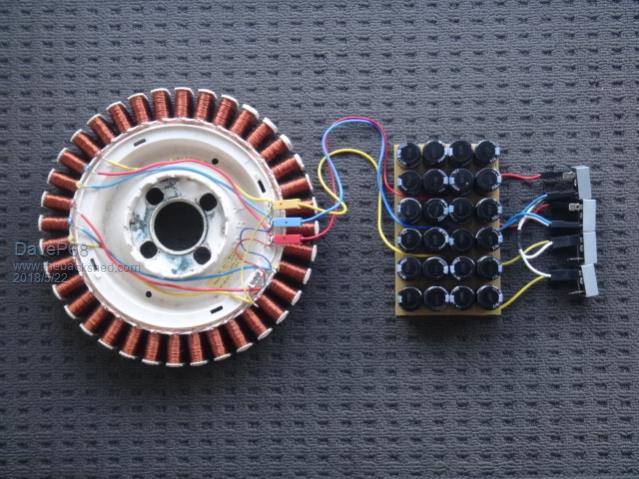

The wiring isn't in a ring as per your drawing, that's only done on Star configurations not Delta.
the Delta wiring per set "each of 2x poles" loop from R-B, B-Y, Y-R. Then each group of 6x sets of 2 coils is then "all wired in parallel" to the termination point.
Carefully look at the picture and it will become clear to you.

Here is a photo of a 2x6c wired in delta connected to a capacitor doubler.
Sorry it's low resolution again but the wiring R-B, B-Y & Y-R should be more obvious.
The drawing you have looks correct just very hard to see the blue wires combining the 4 groups of 3x poles.

I don't used capacitor doublers anymore. The drawback of capacitor boublers is the extra system loss due to how they work. The loss at best is 15 % but typically more closer to 20 %.
Don't get me wrong there is a place for capacitor doublers when using them for direct battery charging.
The resonance capacitors provide a much better power output improvement along with amazing extra torque. The efficiency drop is in the range of only 5 % sometimes even less. One other big advantage is they almost follow the wind power curve with the way they start to produce lots of extra power for only a modest increase in RPM.
Resonance capacitors are best used in high voltage AC mode connected to a MPPT inverter charger of Grid Tie Inverter.
I've test resonance capacitors on a 1x12p Delta stator into my dynamic brake circuit and extracted around 900 W at 400 RPM. This same circuit has been modified to provide MPPT which is exactly what you are trying to do. My circuit has run with a 28 ohm resistor very close toe the 240 V 29 ohm element you also have.

Add resonance capacitors into the equation and this changes everything that I've stated above, but the increase output power that they provide can't be over looked.Edited by DaveP68 2018-05-24
