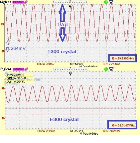

Phil over at the PICAXE forums has received two of my clone modules, and has tested the crystals - they are stunningly bad......
An extract from an email that he sent me:
[Quote=Phil from PICAXE forums]28.5MHz and less than half the amplitude of the signal across the “T300” crystal![/Quote]
Please visit the PICAXE thread for an image he has posted comparing the genuine with the clone crystals.
I have asked him in an email if I can repost his image here, because you can't get the full-size image from the PICAXE forums, unless you are logged in, and many members here won't be members of the PICAXE forums. As soon as he says that is OK, I will re-post his image here.
EDIT: Permission granted from Phil to re-post his scope image, so here you are:
For a crystal that is supposed to be 30.000MHz, this is not good.... Edited by Grogster 2018-04-28

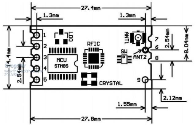

@ MicroBlocks - Here you go:
I cropped this image from one of the listings on AliExpress.
