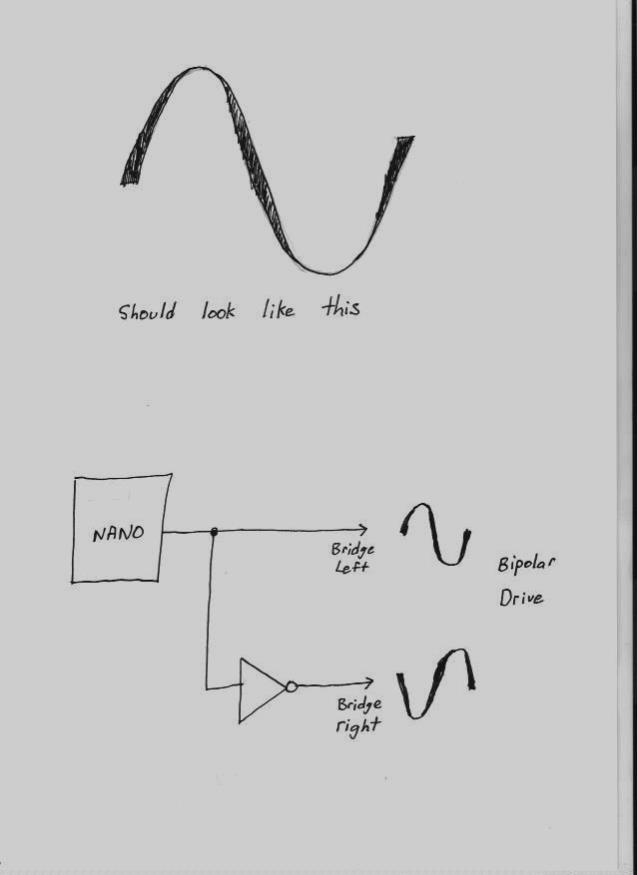

Bipolar PWM should look like two full complete sine waves but 180 degrees out of phase at 50Hz.
What comes out of the bride will be two complete sine waves each of half the total final amplitude. The main feature of this is that the transformer is driven with a pair pure clean uninterrupted sine waves with very little harmonic distortion.
There are none of those freakish violent phase reversals at the zero crossings.

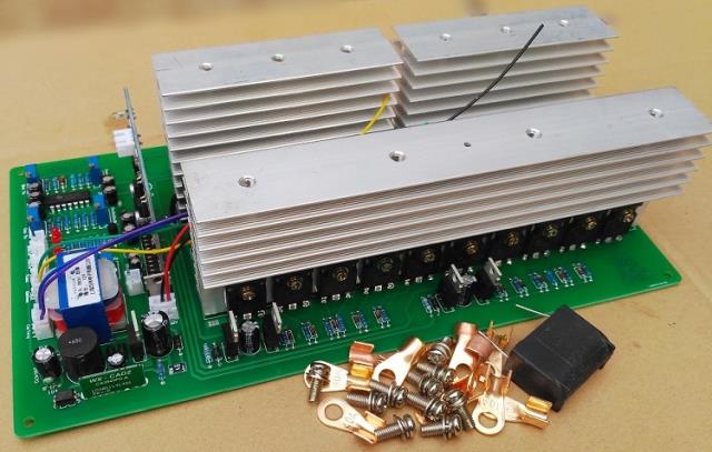

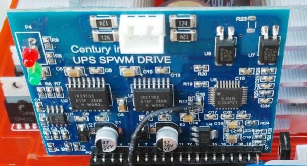

There is another SWPM chip used in LF inverter board design.
I first saw it when Madness (or maybe someone else) pointed out the
Aliexpress product that uses a totem pole driver for the gate drives.
This board here:
What I find interesting is this product has the facility to sync up to mains.
I suppose that is what the two LEDs are for. One for inverter function (on/standby/error) and the other for mains sync. The 3 pin white connector on the top is where mains voltage to sync to is fed. Note the 2 opto-isolators, used to give good HV isolation.
The chip is marked "SJNB" and "C180F21"
I can't find any crystal oscillator, maybe it uses an internal osc, disciplined by
mains freq?
Typically for an Aliexpress listing, you get different pictures of different products, all representing the same thing that is on offer.

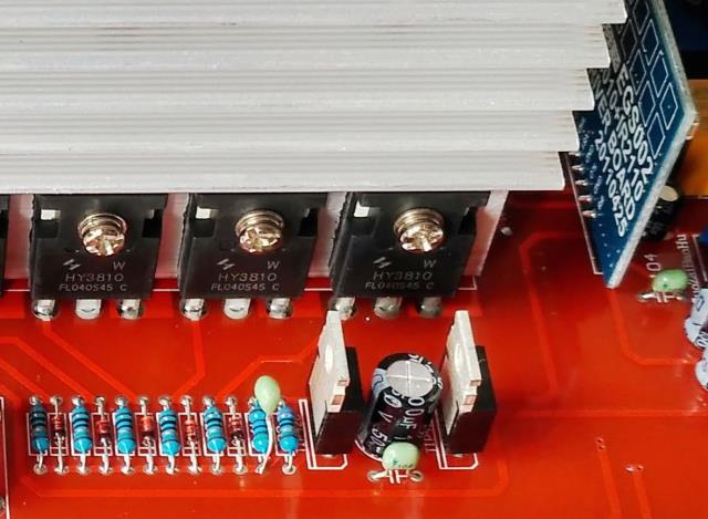

Note the close up of the totem pole drive shows an EGS002 driver card.
It also uses HY3810 switches.
Anyway, mains sync function is out there. I wonder if anyone can dig up some info
on the chip?

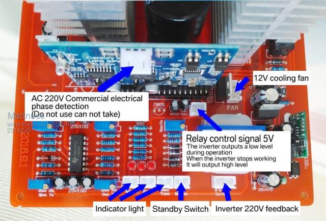

Posted: 09:16pm 08 May 2018
I am not so sure about the mains syncing, maybe it works with EI transformers. The photo below is from a different seller of the same PCB.
It says do not use the phase detection. Board is listed here.
Posted: 11:43pm 08 May 2018
Looking at just the pictures, that mains syncing board appears to be a direct plug in replacement for the original EGS002 board.
Also, the Chinese seem to be learning from us.
They are suggesting a much reduced design flux density of 1.2 Teslas for designing the transformer, instead of the more usual 1.6 to 1.7 Teslas used for normal commercial mains transformers.
And they are even suggesting adding a 45uH choke to reduce idling power.

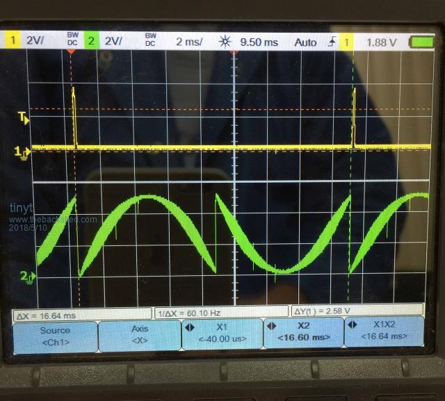

I am still playing and learning from POIDA's code (pre-modified for 60Hz):
To find out if it can sync on an external signal, I added the following in setup:
// MOD: added the following 2 lines
EICRA = _BV(ISC01) | _BV(ISC00);
EIMSK = _BV(INT0);
And also the following:
ISR(INT0_vect)
if (pcount < 50) // Arbitrary window.
{ TCNT2=126; // Reset as if
pcount=0; // Timer 2 overflow
TCNT1=0; // happens
I used a pulse generator set to 60Hz repetition rate and fed its output to the INT0 pin of the NANO and monitored the SPWM output of OC1A of the NANO. I get this scope capture. Yellow is pulse generator and green is the SPWM (scope is bandwidth limited). Scope is triggered on the yellow trace signal.
The green trace is locked steady with the yellow trace.
For reference, I disconnected the INT0 connection and video clip captured the scope. It shows the no sync condition.
2018-05-10_050530_OC1A_Output_NoSync.mp4.zip

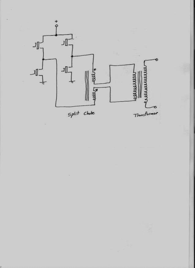

It changes to a normal sinewave after the choke.
Posted: 10:01pm 09 May 2018
After the choke(s) each end of the primary winding is driven by a whole complete clean unbroken sine wave that will have very low harmonic distortion.
No savage violent transitions at the zero crossing points that can excite kinks or wobbles in the transformer.
Posted: 11:35pm 09 May 2018
Two completely separate smaller chokes will work fine.
In some cases a single larger "split" choke may be preferable, but the two windings absolutely must be connected the right way around for it to work.
