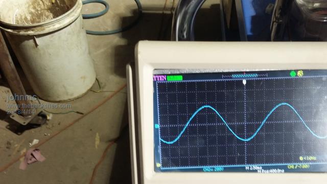

Posted: 01:54pm 14 Apr 2018
Good Day All

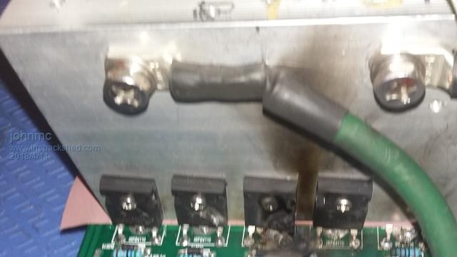

Still no inverter but i have managed to destroy over 100 HY4008 50 odd ir2010
20 odd EG8010 and numerous PCB boards the last effort of a soldered in place FETS and cpacitors
So power board number 3 has screwed replacement of Fets and power capacitors
The inveter will create a sinewave with a standing current of 1 amp (50w)but this is with restricted battery supply.
when the inverter has the main battery bank 1000 amp hr at 48 volts supplied even with a small load of 500 watts this will blow the power fets .
The fet driver voltage is 17 volts there is no noise from the transformer .

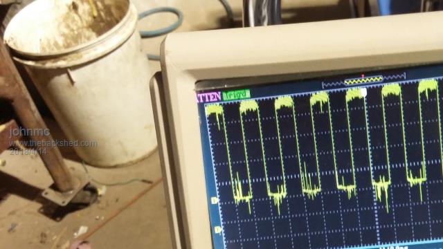

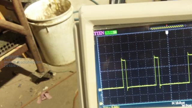

The following wave forms are taken at the power board high side fet gates but no fets fitted to the power board
highsde Fet fitted
low side and with fet fitted
With out the fets the low side wave is nice and square.
Cheers john
