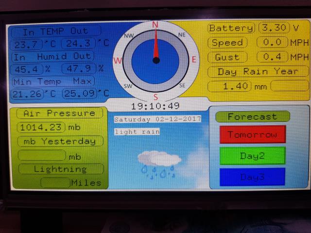

Posted: 07:13pm 02 Dec 2017
The result of all the above - now showing the correct weather icon and description for today (and the rest of the days once programmed)

Posted: 12:09am 03 Dec 2017
That's great news Lewis, glad it is running.
I am still away but will look at the printout that you posted (which I asked you to do) in case it gives any clues. Would be good to see if we can understand what was happening even though it now works.
