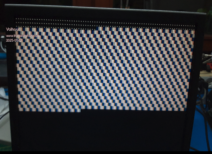

@Peter,
RC22 on genuine RP2040 VGA design 2 with WII Classic connected to GP14/GP15.
Just opening the WII classic, and then printing 1 dot on the screen every 100ms.
In this picture the pico is dead and needs power cycling to revive.
It is not fixed. Sorry.
Edited 2025-05-06 05:57 by Volhout
Posts: 12176
Posted: 09:28pm 05 May 2025
  Quote  It is not fixed. Sorry.
I've just run for 3 hours without issue so I'm happy it is now OK and then anything else is probably electrical. I don't intend to look at if further.
Edited 2025-05-06 07:31 by matherp

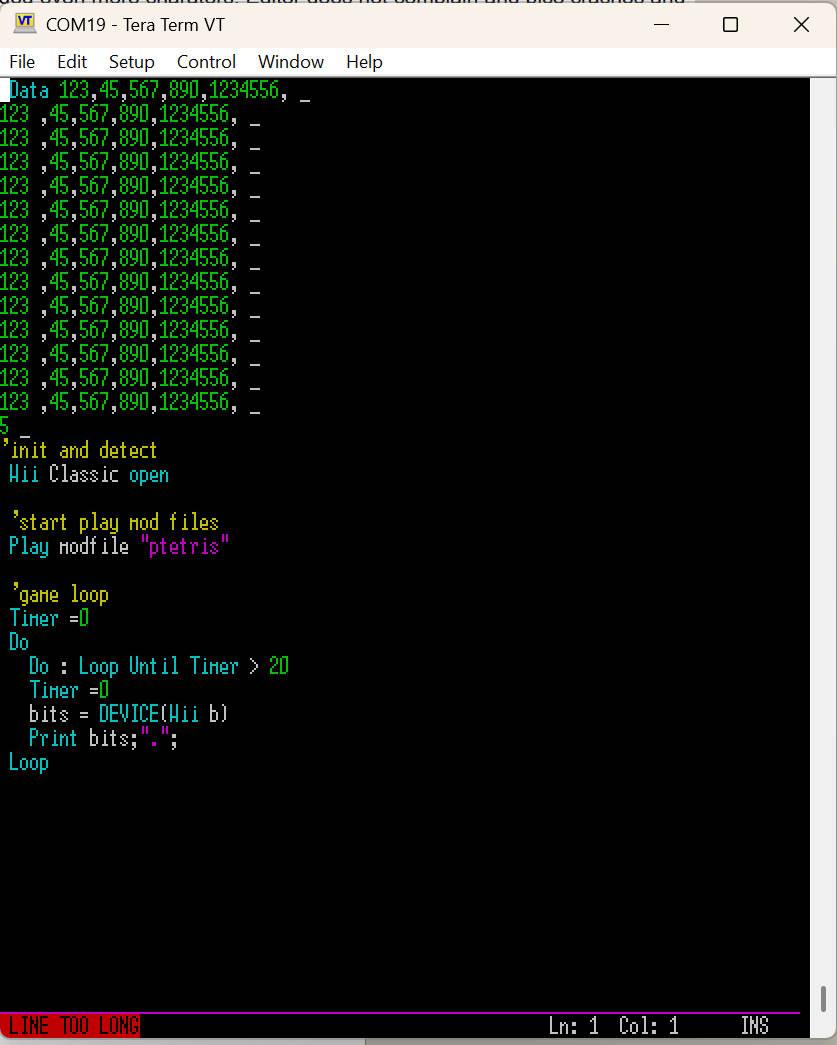

  Quote  I took the broken code added some lines and went back to the line and added even more charaters. Editor does not complain and pico crashes and cuts lines I added
Did you update to RC22? This was an issue in the first version of the continuation code but was supposed to be fixed in RC22.
See image of the editor when I press F1 or F2
Note though, without continuation lines it is perfectly possible to break the editor by using the manual trick for creating long lines to make on > 255 characters and in this case the extra length is picked up by the code that saves the file to flash and truncates the save at that point losing data - this has always been the case.
