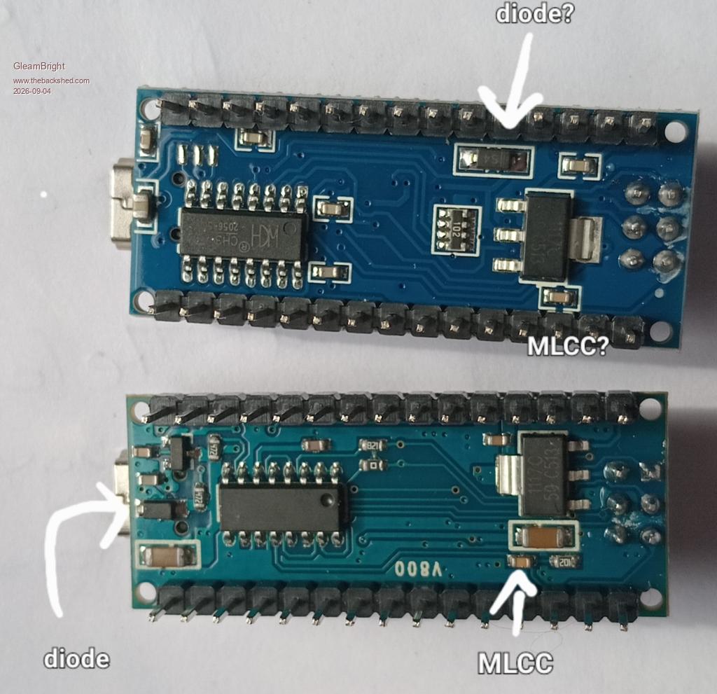

Referring to KeepIS' post on page 8 of this thread re: removal of diode and capacitor from nano board rear side. I received two slightly different nano designs, one of which I (think) I've identifed the diode and capacitor. The other one at the top is less clear. Anyone want to have a stab at identifying the relevant diode and capacitor?
Soon to attempt firmware downloads ahead of commencing the build.

EDIT: Made an Error with the two boards shown
There are two types of the SECOND board, one does not allow you to disable the +5V supply, and it looks like that is the board in the photo.
Sooo! the second board is NOT correct. However removing that CAP does disable the Nano reset problem (checked), use it for the LCD displays or for poidas Saturation tester.
Just out of interest, I extracted the +5V pin on the USB socket and that obviously solves the +5V problem (same as removing a diode), but it's not feasible for most.
A final thought, in my inverter I have a small adaptor cable from the USB socket on the Nano to the Cabinet front panel for a tablet or PC if a Menu Setting needs to be adjusted. You could simply disconnect the +5v wire in that lead, if you had a few of those boards that would at least solve that problem.
The First Board?
I don't have one exactly like that? The Cap and Diode can be in very odd places on some boards. Measure from the reset pin to the cap, one side should be connected to the reset pin. Removing the Cap at least removes the reset issue.
As a refresh:
1: The Diode isolates the USB external +5V from the Nano controller.
2: Cap removal stops the USB Port from resetting the Nano controller on port connection and when connecting to a Serial program for setting the Menu options.
Edited 2026-09-04 14:37 by KeepIS

Corrected previous post, slight difference in the boards that I missed the first time I replied

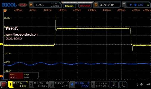

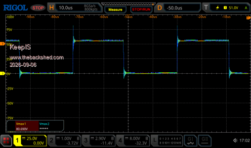

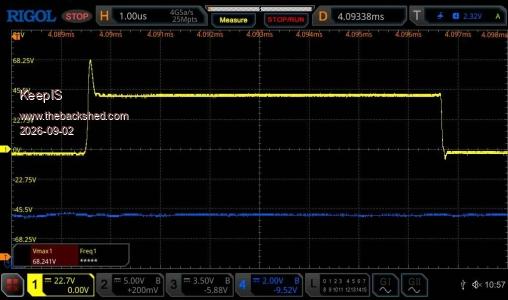

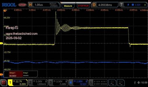

  KeepIS said
Below: No HI-Side beads Unloaded and 1,800uF, same with 30,000uF total CAP Bank.
A bit surprised to see the Vds overshoot.  Don't remember it to be quite as large in your past builds.  Wonder if it affects the gate drive waveforms.
  KeepIS said
Below: No HI-S Beads - Unloaded 38,000uF
Is this really unloaded? That's quite a bit of ringing for unloaded.
  KeepIS said
Below: HI Side Beads added, already had LO-Side Beads, 800W with 38,000uF total CAP Bank.
Nice to see the beads really work.

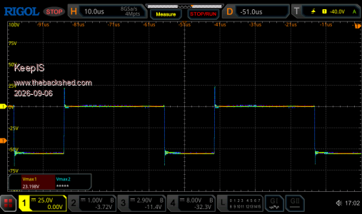

Like I said in the post, worst case I could find, it depends on exactly where in the waveform you zoom into, again, this is a test setup without the massive capacitance of a LiFePO4 battery, and no 0-gauge or 00-gauge cables, just 15A resistive connections to the DC supply, the ESR of these test caps are not as good as the 120000uF CAP Bank sitting across the supply in the Main Inverter. Most times, ringing in the test unit is just those normally short, fast decaying 2 to 3 cycles apparent in some parts of the SPWM envelope.
Random captures from 2023.
Edited 2026-09-06 13:59 by KeepIS

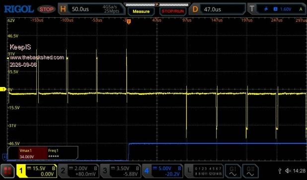

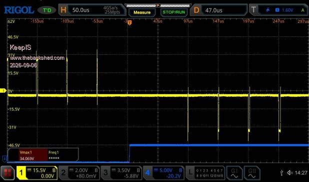

FYI: After correcting the 1/2 Sine array: The result around Zero Crossing.
Old Code: Versions Version 8.2 and earlier. Optional Dual Version 1.5 and earlier:
Corrected Code: Version 8.4, Optional Dual Version 1.7.

  nickskethisniks said  The ringing will allways be there, switching is done so fast this is inevitable.
The beads are the only thing I tested that completely removed the ringing BUT with the side effect of introducing one big spike that gets higher with higher current. And that raises the question if higher voltage mosfets should be chosen to cope with that, although the energy of the spike is very low and Keepis his inverters don't seem to have problems after 1-2y of testing, only time will tell if this is also after 10-15y.
Putting some resistors over the beads, this somewhat reduced the spikes with a few volts but not really worth the trouble.
To observe the spike as per Keepis pictures there does not seem to be an avalanche event on the Mosfet drain as the spike would be clipped (flat topped) at the beginning of avalanche.
I did some back of the envelope calculations for the spike energy in the Keep is picture, width of pulse ~ 50uS, height 50V I used a current of 2A and the energy is ~20 milliJoules (mJ), if I increase the current to 20A it is only 200mJ. The transistor rating of avalanche energy is 2829 mJ whilst using a supply voltage of 64V and an inductor of 500nH (which must have had a significant volume). The inductance of a typical ferrite bead is around 600uH ana max current 3A, but its energy storage given the minute volume is also very small and it would be well saturated above a few amps.
Given that the voltage spike drops by half with a 15 ohm resistor across the bead means a current of ~ 3A occurred. Using the formula for Avalanche energy, J=0.5xLxIxI it works out to around 10mJ - IF the FET actually avalanched. I suspect the little voltage glitch was possibly swallowed by the circuitry's FETs internal diode reverse recovery/forward on time, maybe the Fet Capacitance & series bead had a resonance spike?. I am confident that needing higher voltage FETs or wondering about internal damage over time are non events.
Maybe a fast diode or two (in parallel with the bead)) might still have enough HF impedance to stop oscillation as well as kill the spike?  If I wasn't digging up  stormwater pipes to find a leak and root entry now I would do it myself.

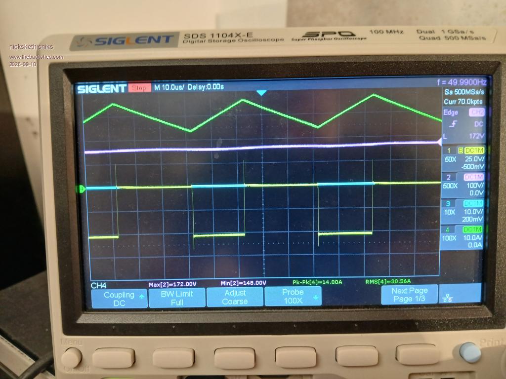

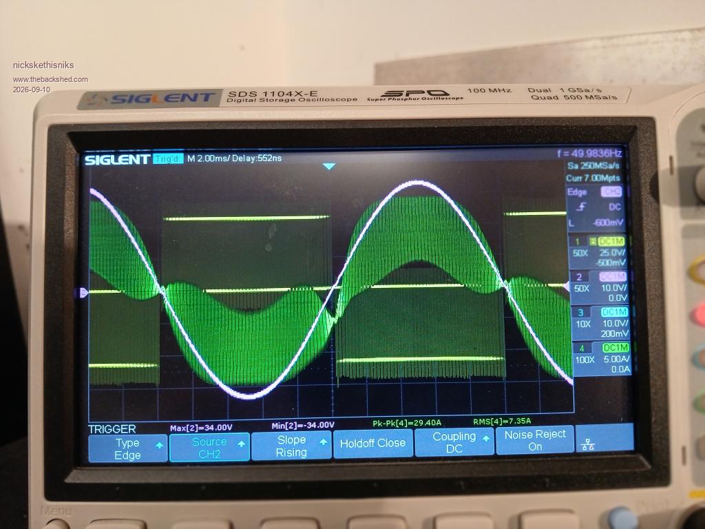

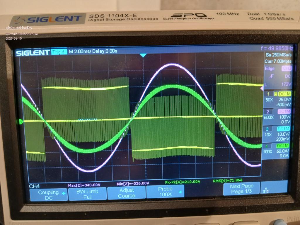

Like always I'm heaving so much projects in so many fields. But here is my test bench, as you see I've populated 4 powerboards with 16 mosfets and 2 smaller 8 mosfet boards.
I use some RC terminals to easily swap boards if needed
Currently on the test is a setup like described by keepis and wiseguy. HY5608 1R2 gate and beads on all legs of the drains, but the only addition of 10R resistors over the beads to somewhat surpress the peak. Oh also 1W dcdc converter on the low side drive, they are ready to be removed by 2W versions.
It has 8 x 5600uF caps and powered by new LF50k cells.
The inductor I made is a triple stack MS-301060 cores with 14 turns, actually 2 times 7 wich makes a nice symetrical layout, but acting like a single winding. So in theory 50uH unloaded, it halves with about 100Arms.
I still use the 7.7 firmware version, I understood the latest is best arround zero crsossing.
This is scoop picture with +/-2200W load.
Yellow trace is, H-bridge output, green is current  between inductor and transformer. H-bridge output looks a bit hairy but zoomed in (think only at 1000W but not much diffence with 2200W) it is all ok.
I need to mention, mosfets are not yet cooled   , they don't care with 1000W, I even ran it at 2200 without much heating up, but did not ran it for more then 30s like that, 1000W sure no problem.
When using 3R6 gate resistors without beads or others they already warmed up a bit under 200W, so I suspect some cross conduction. Maybe I should prepare a new thread for my findings.
Edited 2026-09-10 18:46 by nickskethisniks

This picture is taken with a 150W load (bulb), when the hum is present you see the current behave different during the zero crossing, it's allways happening at the same time in the period. When the hum is away I get a normal zero crossing of the curent.
Yellow: output bridge, pink: output transformer, green: current between inductor and transformer.
Currently I'm using 2u2 on the ouput, scoop picture was taken with 1uF, now, with the 2u2 the hum is less and the effect of fading in or out is much slower. In the output itself you can't actualy see something.
