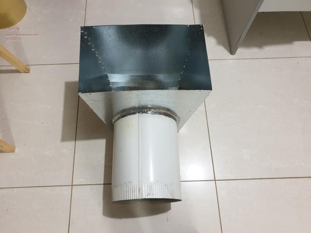

  Quote  Have you worked out how you are going to get the ducting in through the Roof Roger?
I think the decktite would be the usual way a penetration like that is done.
I hadn't really, though I liked Tony's idea of making my own out of copper. In fact I wondered about picking up an old copper tank from a water heater and cutting the material out of that. May be time to add panel beating to my list of skills.

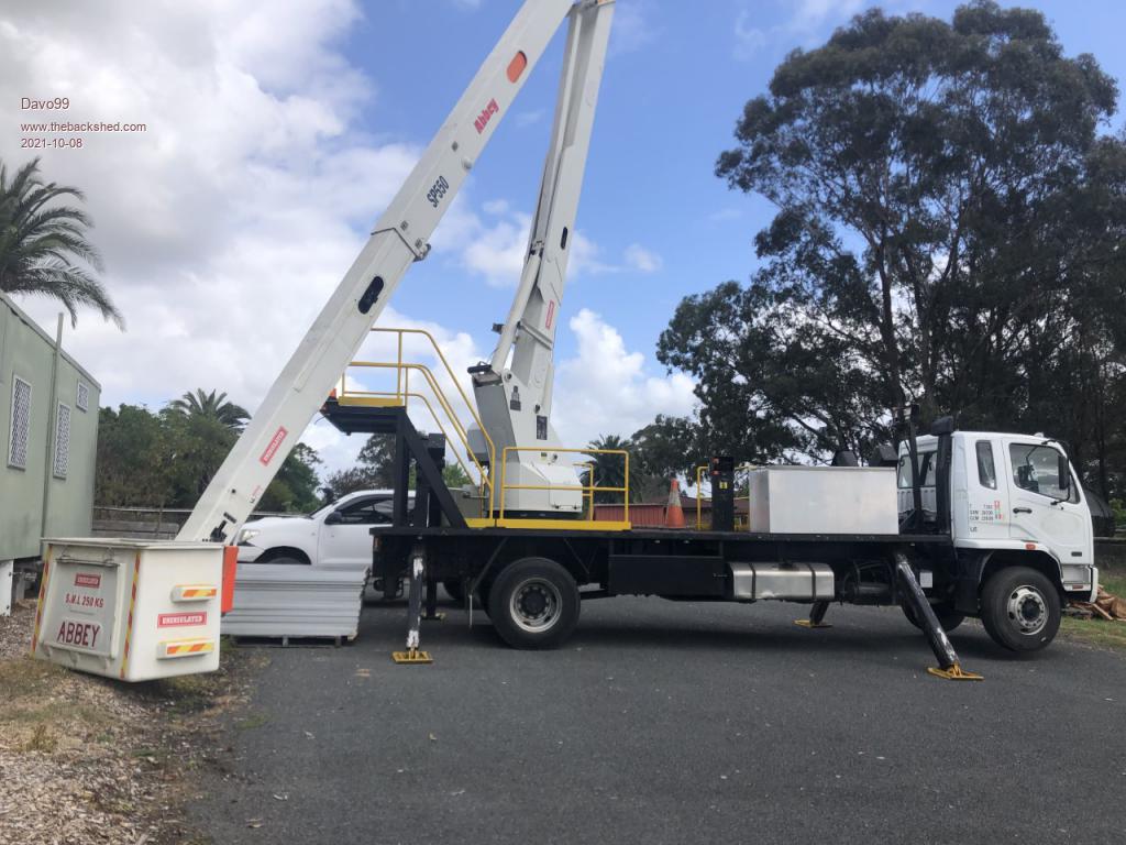

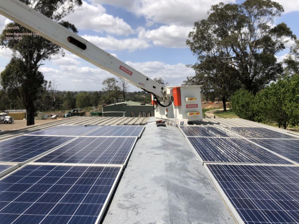

Of course if I hired a crane with a big enough reach to place the completed unit on the roof, that would be great  ...

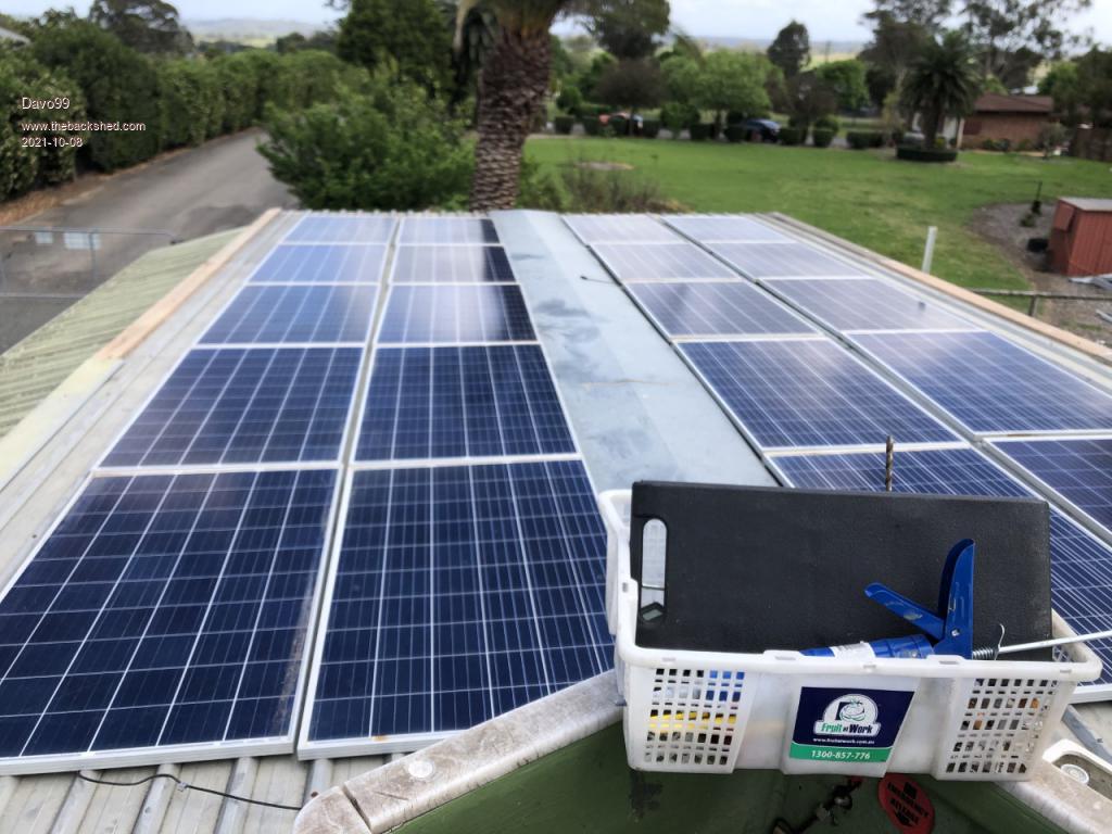

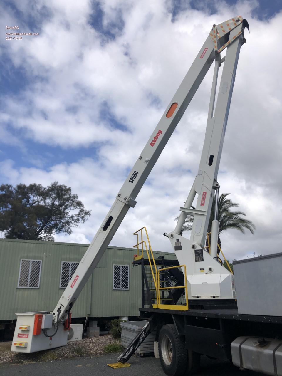

After the guy with the panels went away hopefully nevber to be heard from again, I went to my mates to do his solar setup.
He said he'd leave a Lift out for me but this was not what I was expecting.....
Oh yeah, all good and well for a bloke that's scared of not so heights.
Put some panels in it and took it up.  There are a lot of things that sensible people are scared of that don't worry me in the slightest but I was really wishing I put in a pair of spare Reg grundys. Of course the thing swings and sways and I gaurantee I was white as a sheet.
I got a bit used to it after a few lifts but to say I was comfortable or enjoyed it would be a dead set lie.  I took the thing up to give about a foot over the building for clearance and that was it.
Mate came back after a bit and I said what happened to the bloody forklift? He said I thought you'd have more fun with that.  I said a heart attack is what I nearly  had not fun!
Got the panels Laid out but had to stop. The roof was so hot I was literally burning myself. Got a couple of blisters on my hands which are quite painful.  I'm going back early in the morning to finish off. Just have to finish putting the other half of the brackets on and the DC wiring up there.
For me it may not have been the height as much as having the Boom up above me and being  levered out into space.  They have a pretty wide swing when you do get up  and it was that hanging there feeling that got me. On a fork  I don't think I would have worried  But the size of this I think also threw me. Geez I'm a pansy. Probably never went more than 18 Ft up if that.
I'm sure real men would enjoy it and want to take it all the way up but not this little cup cake.  If you get a lift  Roger and you are in any way height wary, get a mate or an operator with the thing.
Don't look like much from the ground up but from up there down and swaying in the breeze, feels like a mile.

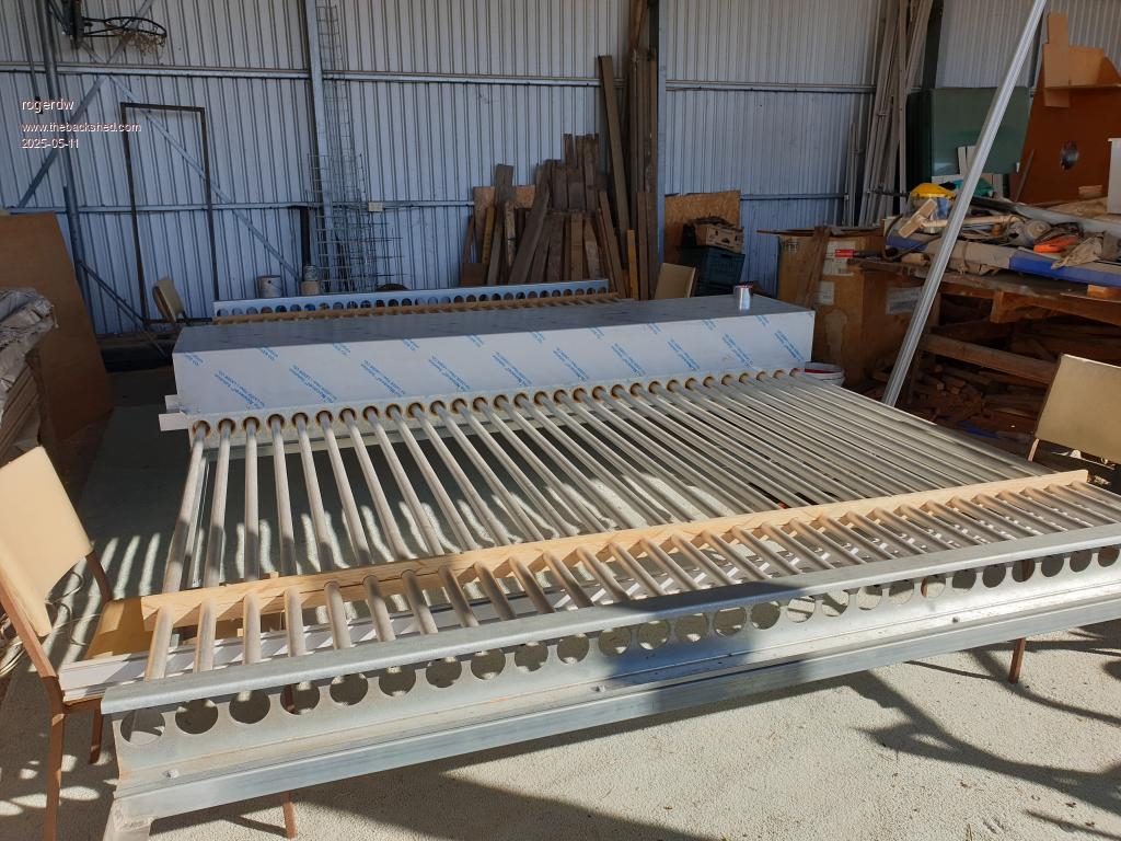

Well, after a three and a half year break I thought I should update this thread.
Unfortunately I set this project aside as I spent a lot of time getting the Warpverter going and then installed  ...  and that has been running nicely for the last 14 months.
Using the excess solar power to run extra resistive heating has been awesome  ...  though unfortunately our ducted aircon has died  ...  so I can't use that for heating. I would have expected that to be far more efficient again, than resistive  ...  but I'm baulking at the idea of spending $8,500 to replace it. Gotta save up for that.
Anyway, the original prototype air heater is heading into its 5th season and still does a great job, despite having one broken tube and the plastic tube manifold partly collapsing due to me turning it on on a hot day to see how hot the output would be. That was a dopey thing to do.
If I hadn't three quarter built this thing already I might have just installed more solar panels  ...  but for a change in my life, I'm gonna finish another big project that I started.

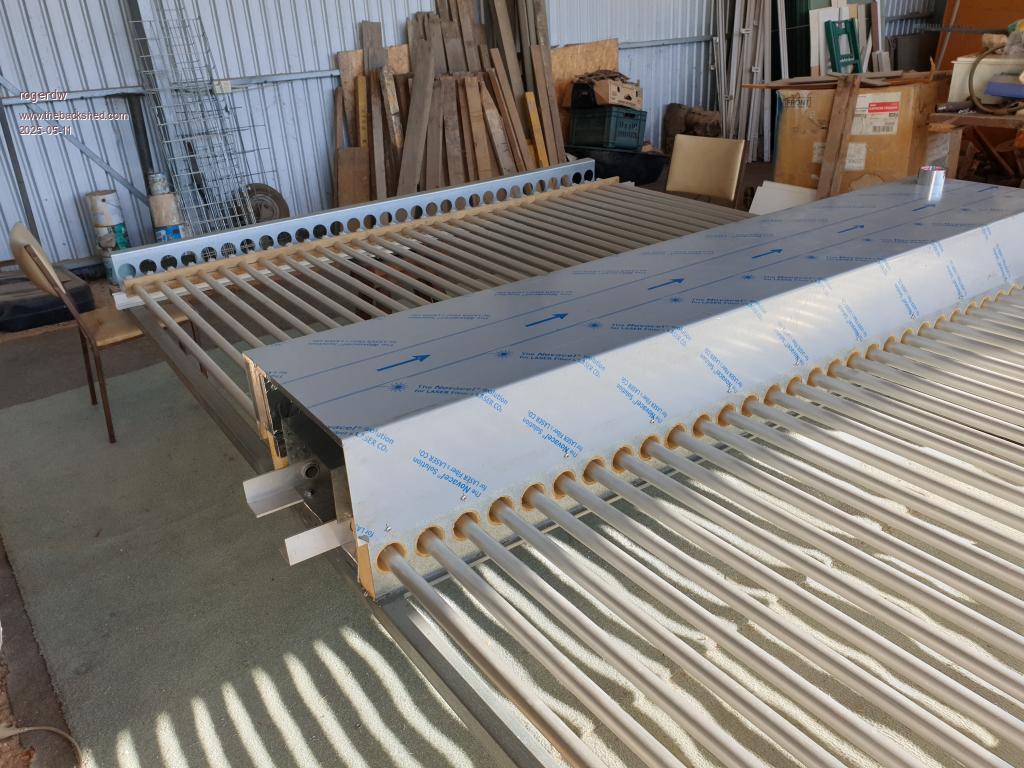

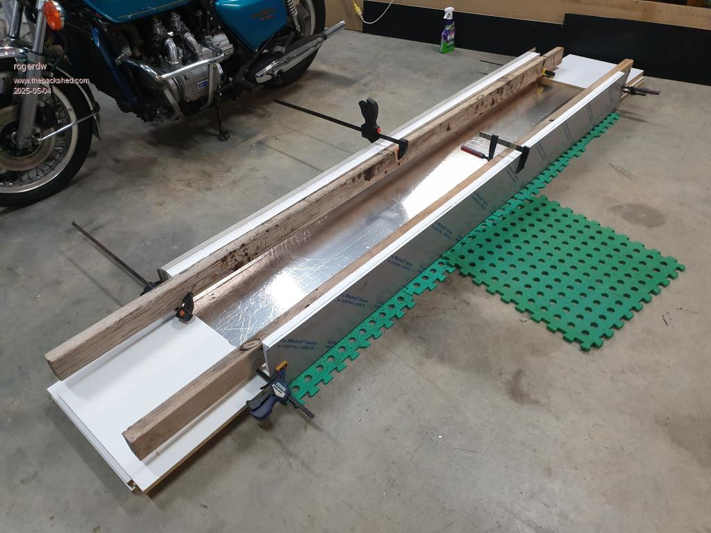

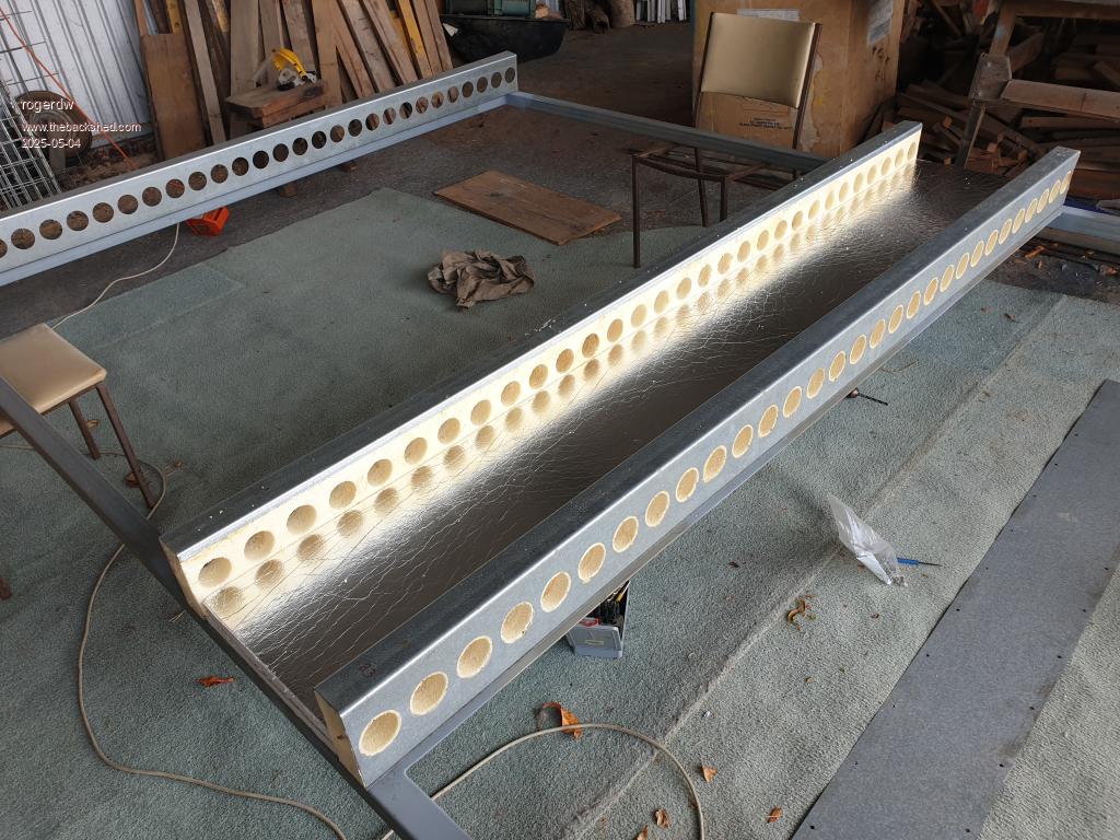

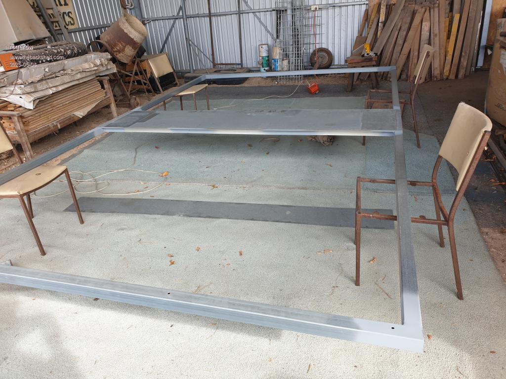

I cleared some space in the leanto shed and scored some free reject carpet to work on  ...  and dragged it over to work on it.

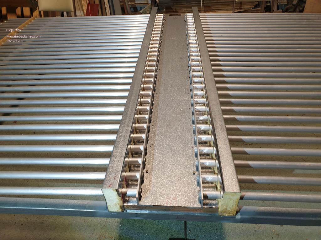

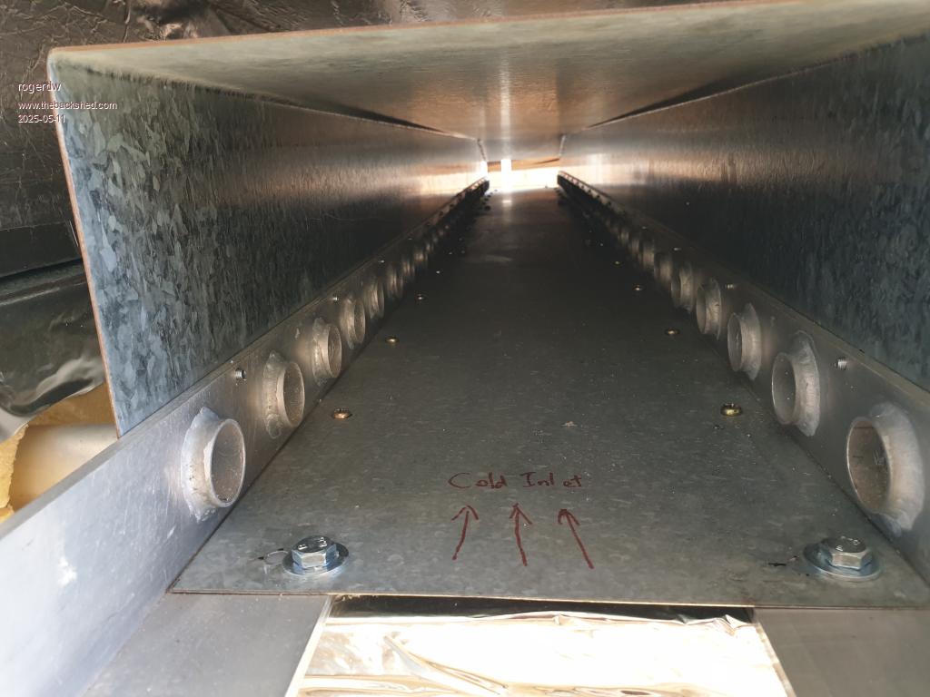

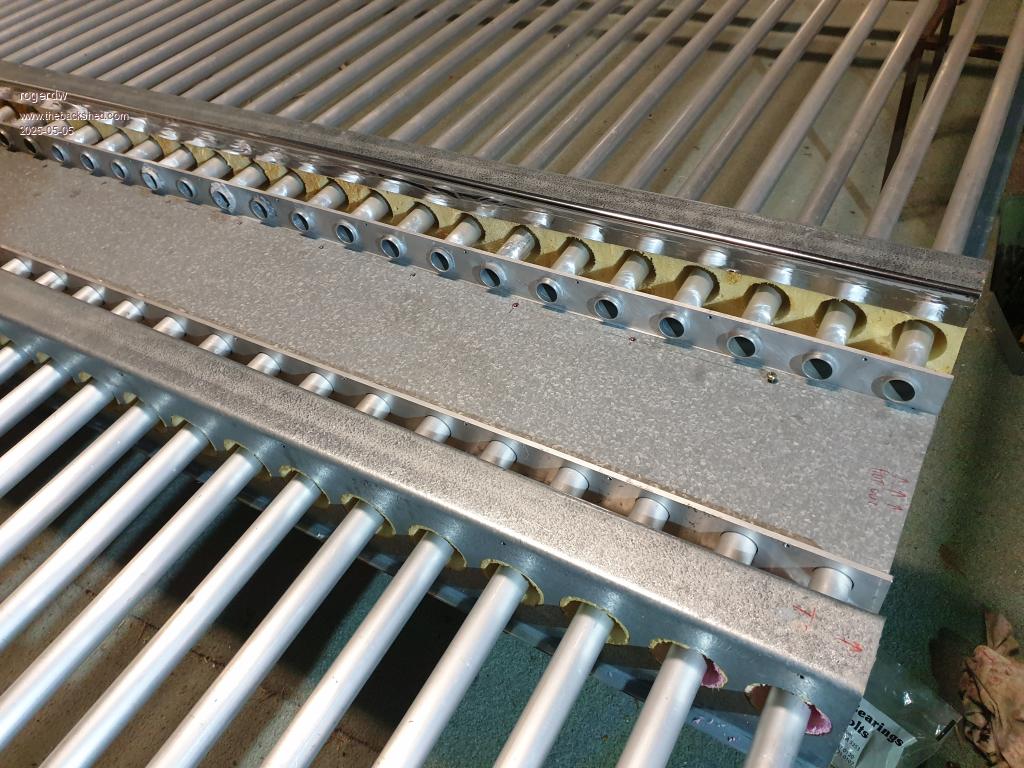

The c-section that the tubes plug into, needed some way to have an airtight seal. I decided to fill it with expanding foam, using plugs to create clearance for the tubes once it set  ...  but that didn't work.
Once I saw how easy it was to work with after it set, I just filled the complete c-section  ...  and after it set, used a holesaw to drill out each hole. That worked extremely well and the glass tubes have a nice tight interference fit over a couple inches. That also centralises the tube and keeps it away from the steel.

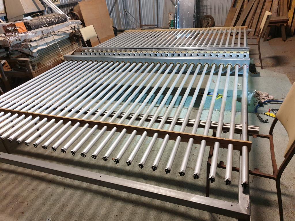

While you can see pictures of the complete unit in previous pages, it was only a dry run assembly and I had to pull it all apart so I could seal it up air tight and water tight.
I also spent some time on the roof checking exactly how it would fit  ...  and discovered that if it was 200mm longer, I could just reach another two rafters. That would give me 8 mounting points at the top and 8 at the bottom, rather than just 6 top and bottom. So I welded an extension on each corner. I had been adding up individual weights and saw it would be close to 300kg when it is finished  ...  so the more supports the better.
I will get a roofing expert to check things out to see what roofing timbers might need extra struts.

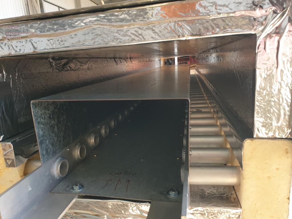

I've drilled and tapped the steelwork to fit the outer manifold  ...  and mounted the tubes for one side. The next step is fitting the tubes for the remaining side.
You can see I have some foilboard insulation on the base and have also added that to the inside of the outer manifold to keep as much of the heat as I can. There are two layers, one 20mm and one 25mm thick  ...  which keeps the inner manifold at the right height and makes the tubes exit in the centre of their holes.
It is manufactured from a fire retardant foam (FR-EPS) with aluminum foil directly laminated to both sides.
The 45mm thick foam inside the outer cover sides, rests on the top of the c-section, so the weight also helps seal the manifold and keep the heat in.

I built a prototype with 18 tubes which works really well, so thought I needed to build a proper one. This will have 60 tubes.
The 18 tube one would put out up to 5kW of heating power on a good day just using a 45 watt fan pushing air through it  ...  so the new one should be good for 15-20kW of heating power. Fan will probably be 175w, so a pretty good COP.
Obviously it only works on good solar days exactly the same as solar voltaic  ...  but here in SA we get lots of sun during winter, so it performs well.
One huge advantage over just fitting more solar panels is that it is such a small area for the power involved. 9.84 m2 for ~20kW  ...  but 20kW of voltaic would need 102 square metres  ...  10 times greater. (500w panels 2.25m x 1.14m x 40 = 20kW)
I've had to stop and think if these figures are correct or not. Theoretical power of the sun on earth is approximately 1370 watts per square metre  ...  so my new 10m2 collector should only reach 13,700 watts if 100% efficient  ...  not possible  ...
...  but then these tubes can collect from all the way round, with reflections from the sides and even underneath with a reflecter surface  ...  so maybe they are not too far out??
Cheers,  Roger

I've made a bit more progress and fitted the tubes on the other side.
And drilled all the holes so I can bolt the tube manifolds in place. I'll grab some more bolts tomorrow so I can finish that off.
The next step will be to bolt the inner manifold cover in place, which will be a little tricky as I haven't left much room to access them. Might have to find someone with little hands to get them started, then use a stubby screwdriver to nip them up.
Edited 2025-05-05 23:45 by rogerdw

Thanks Aaron and Pete. It's a pity I stopped working on it seeing it was so close, though the time spent on the Warpverter was worthwhile.
I originally was going to drag all the bits up and assemble it on the roof  ...  but with all the cutting and shutting and modifying to assemble it on the ground, I figured I'd just do it the once and then pay the local crane place to lift it for me.
I haven't checked for a price yet  ...  so if it's too ridiculous I might have to rethink my strategy.
The 60 evacuated tubes weigh 132kg alone, though I will take them up seperately once it is on the roof. No point taking chances with smashing them.
The rest of the unit weighs 159kg so far, with a couple end shrouds that haven't been built yet, to add after.
I extended the ends of the frame 120mm to reach an additional two roof timbers so there will be a total of 16 attachment points to spread out the weight over 8 rafters. I still need to get in the ceiling and work out whether or where I should add any extra struts  ...  though each mount only needs to support about 19kg.
The cold air comes in on the left hand side and exits on the right.
The centre cover is stainless steel, so once it's on the roof I can remove the protective cover. Probably get complaints from the local aerodrome about the reflections.
The other end of the inlet manifold has to be closed off yet.
Edited 2025-05-11 11:09 by rogerdw
Cheers,  Roger

Well I got a quote yesterday. The guy charges $250/hr which sounded ok  ...  but then he says he charges a minimum of 2 hours. So it's gonna cost $500 to get it on the roof. Mmmm.
The funny part is, he is the guy I bought the tubes from in the first place. 160 tubes for $100. I guess I cant have it both ways.
Of course it's not finished yet, but getting closer.

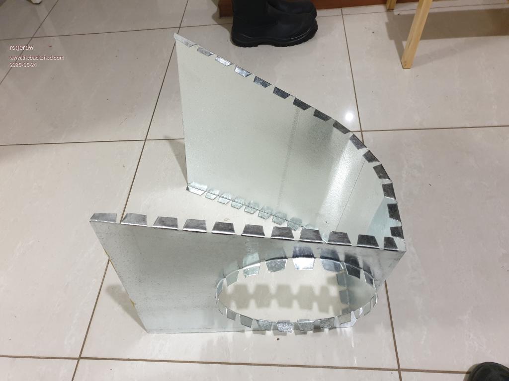

I've never done sheet metal work before so this is probably all wrong  ...  but it looks like it's going to work.
This is the hot air outlet and will sit inside another larger shroud with the gap filled with fire proof expanding foam, to retain as much heat as possible.
Then need to make the cold inlet manifold. Same size duct inlet (250mm) but smaller rectangular outlet.

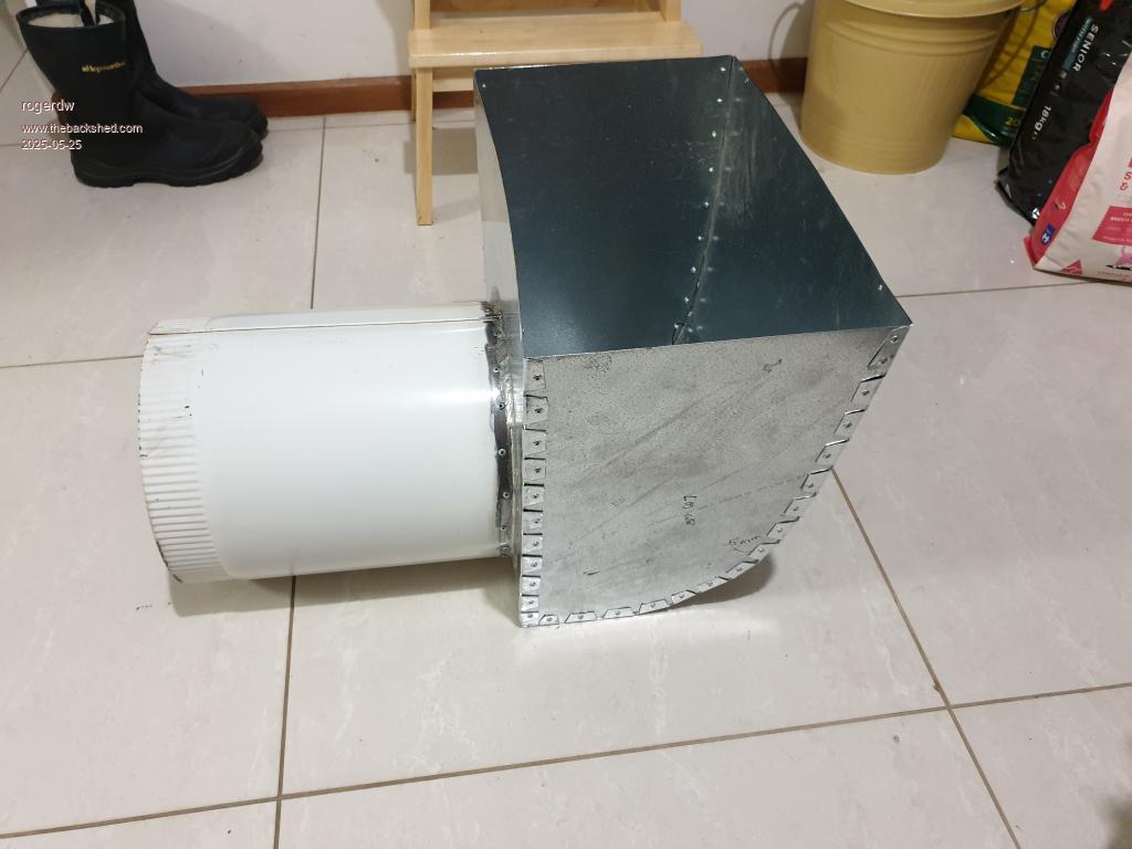

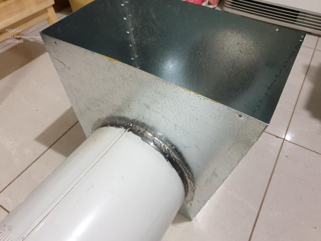

I made some more progress today. Even used some of the reclaimed solder I posted about in the other thread.
I've riveted everything and just soldered the duct joint. The rest I'm gonna cheat and use roof and gutter silicone.
Cheers,  Roger
