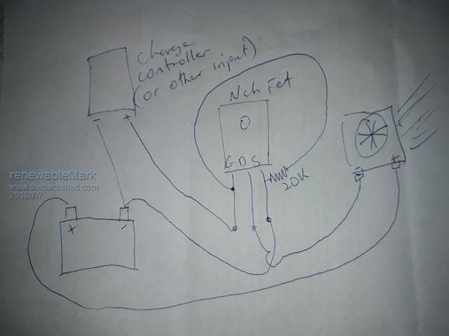

Sorry Mark probably my fault the resistor goes from Gate to Source the 2 outside legs.
John I bet you still remember how sharp the Hydrogen bang is.

Nah Mad, that was my fault.
Third time's a charm.
I wish we were able to edit posts, those previous drawings are wrong and confusing, and I just worked out you can't report your own post to get them deleted.

Posted: 10:45pm 06 Jul 2018
Just to confuse you a little more, you don't have to but probably a good idea to include a 47 Ohm (or close to it) resistor between the + output of the CC and the MOSFET gate.

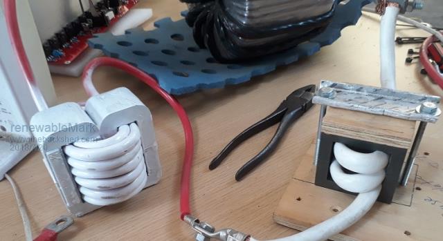

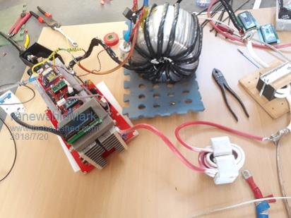

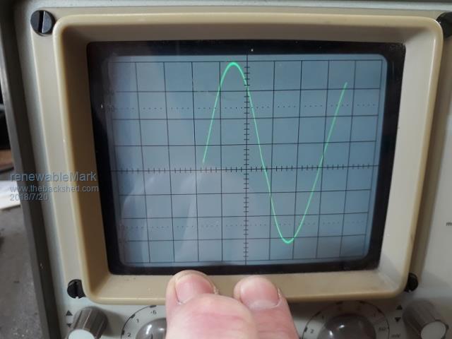

Had a fiddle with the choke I did with Warp the other day.
I put it in series with the 2x stacked ferrite.
Got 0.6A No load draw, pretty happy with that.
Nice clean wave.
NO hum from torroid at idle or any load.
BTW when I just used one ferrite it hummed really bad, two ferrites and still hummed but not too bad, the difference with both ferrite and big iron core is amazing, you can't hear the torroid at all.... nothing.
I could have tried it without the ferrite or less winds but hey, if it aint broke don't fix it.
Time to cram it in a box and hook up to the transfer switch plug on house.
The one that is painted white is the aerosharp one, it's made from two of the bigger ones stacked side by side and glued/clamped together. They tend to give nasty friggin metal splinters the little rotters so I painted the little dog so it wouldn't do that.
Why both? I remember Poida was saying the ferrite cleans up high frequency mess so I added it to the iron core that won't saturate.
Warps calculations and testing showed that the double stacked ferrite (4x halves clamped together)saturated at 40A.
The Iron core was well above 100A, not sure how mugh higher as he couldn't test any higher, but it had no signs of signal altering, could be 150?? so I'm well above any load I'll ever place on the machine.

Posted: 07:22am 20 Jul 2018
Looking good there Mark.
It should run much more happily now that it has a decent non saturating iron choke, and the transformer has been tuned to 75Hz.
Well done!
Posted: 07:31am 20 Jul 2018
Nice job there Mark. I confirm your findings with the choke core splinters, ouch .
My non saturating iron core choke, like yours, saturated at 130 Amps with 18 turns and a 2mm gap.You could perhaps guesstimate the figures for your choke from that.
Also confirm your findings about using two chokes. See my post later today, I'm using a different ferrite choke.

Posted: 07:41am 20 Jul 2018
Marks choke has 12 turns but the gap is much smaller then yours at around 1.1mm.
We first tried 17 turns with some junk wire and it went as straight as an arrow to 70 amps without the slightest sign of saturation. Then my tester that only has 50amp mosfets in it, blew up.
17 x 70 is 1,190 ampere turns. With only 12 turns it will do 100 amps easy, and probably a lot more. The smaller gap actually works very well, that choke had 125uH which is pretty good.

Posted: 09:30am 20 Jul 2018
With your case Mark, fit the heatsink so it is vertical when the case is mounted in its final place.
Have a fan blow in air from the bottom, right at the heat sinks.
Maybe another fan to extract the air on top, could be controlled independently.
Try not to have the heat sink sideways. I did that with inverter #1, a converted powerjack which fitted easier into the Aerosharp box this way.
It has 2 fans blowing air in, sideways, and 2 fans exhausting air. In summer they ran just about all the time.
That is why I went for the bigger home made enclosures. The 3 fans for them (1 in, 2 out) rarely come on in Summer and I have yet to hear them running in the Winter.

Posted: 09:53am 20 Jul 2018
Thanks Klaus, yeah I have 2x aerosharp cases side by side,( like Mad did) the powerboard with heatsinks will be vertical with a pull push fans top and bottom, the other side is the same with torroid, filters and chokes. 4 fans all up.
I had it laid out ok before with just the one choke, might get a bit tight with the extra one now.
