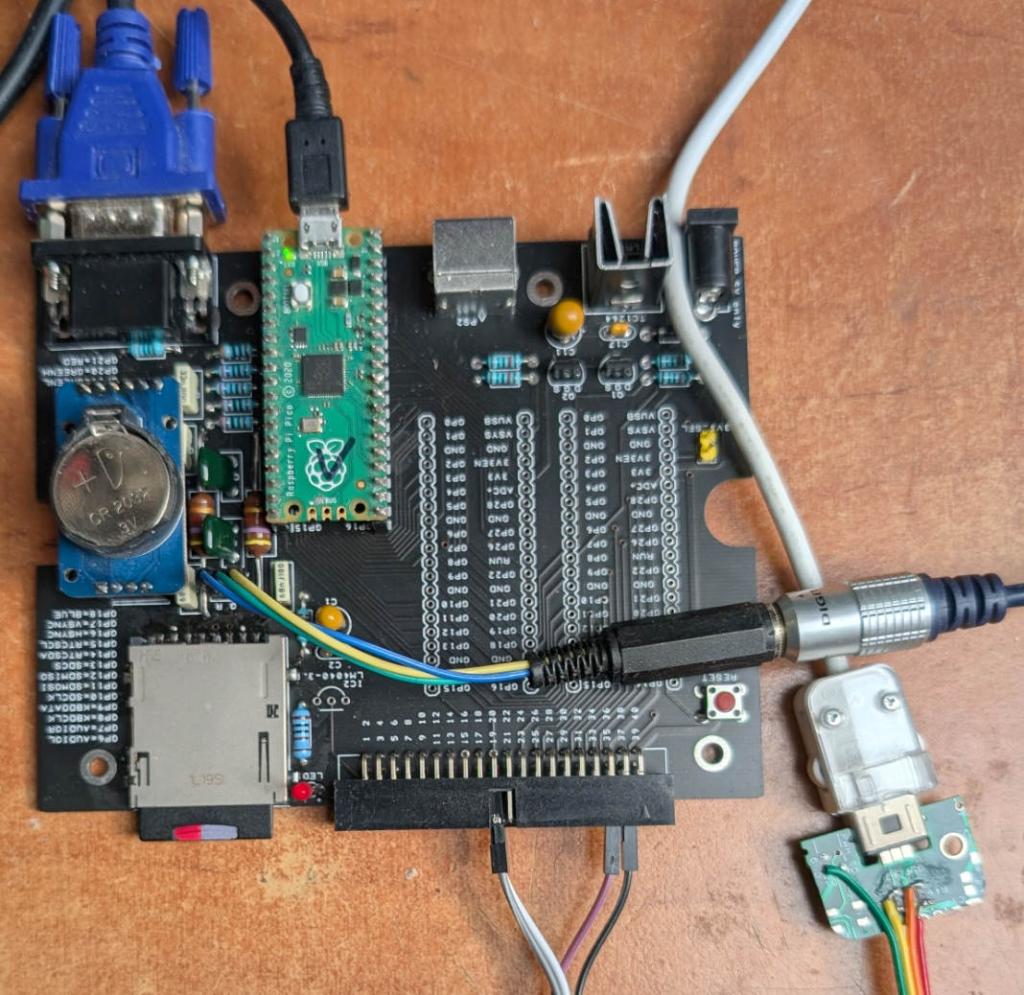

We knew this was going to happen.  Your test program doesn't crash for me. Running on a "genuine" vga design 2 board. The only difference is that I'm using GP14,GP15 for the system i2c and have the RTC module plugged into the board.
Have you tired different CPU speeds? Can you correlate the crashes with the mod file looping round? Can you run the test on and RP2350 to see if it makes a difference?

@Peter,
I can also duplicate it on the VGA design 2. Connecting the WII classic to GP14/GP15, with the RTC placed and using V6.00.02RC21.
It only takes more time. In all cases, the screen is filled with dots (the code prints these), and the final character before the crash is always en "E", not a dot.
Please let the code run for 20 minutes, and check for silence (sound stopped) and an "E" on screen.
