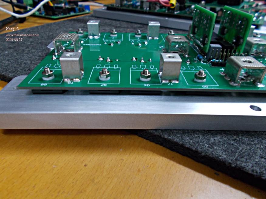

I tested a 3mm deep hole in the top of the HTB under the FETS, recessed screw through the bottom, and a nut on the top, the nut is pulled into the hole and held in firmly as the corners of the nut bight into the round hole, perfect.
The recess hole is smaller than the blank plastic relief in the FET Heat tab, the Nut pull nicely below the surface of the Bar under the FET, clean, no ridges or high spots.
Lay the Power Board over each HTB and it drops into place, put an insulating washer on the split LO side Bar screws and a Fibre or Metal washer over the HI side BAR screws, spin the nuts on and tighten, and there is a ton of clearance below the CAP boards, again off-the-shelf M3 nuts and bolts.
When tightening the nuts, we are not so worried about over tightening onto a Silicon insulator, this is only true for what I call, "Live Bar mounting" of the FETs, IE the Drain connection to the FETs are connected to either +53v terminal (Long BAR), or TX1, TX2 terminals, Short (split) LO Side Bars, as no small single FET silicon insulators are used.
When the bars are tightened down on to the Silicon insulation MAT on the Main Heat sink, the load is spread across a large area, 10mm thick 40mm wide Bars, and I have found that there is no need to reef down on those, it's not a small critical mechanical interface like the Heat tab of a FET, there is a lot of thermal mass protection in this configuration.
So tomorrow I take these to the CNC guy and get the changes made for the final Heat Transfer Bars, I hope to include mounting for temperature sensors as well. Price should be way below the effort to do them manually, and it's so dam quick when everything just fits.

NOTE: "Live Bar mounting" of the FETs is no longer recommended as it bypasses the Ferrite Beads. As this thread continues, further testing revealed that the Beads should now be kept in circuit, this simply means using insulating heat transfer sheet under each FET when mounting the FETs to the Heat Bar.

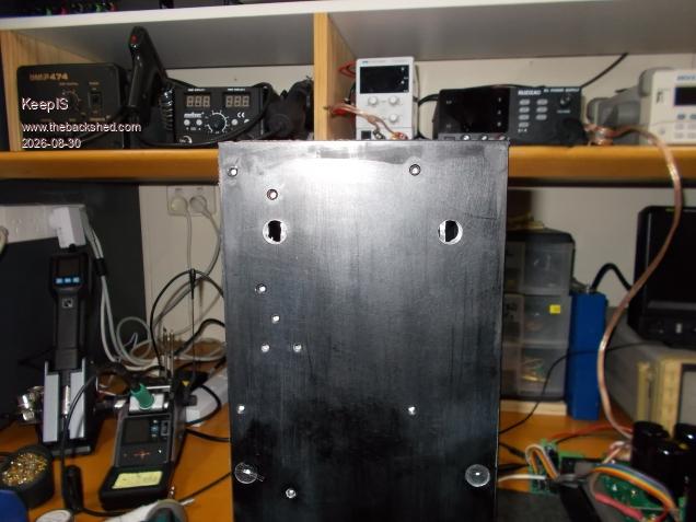

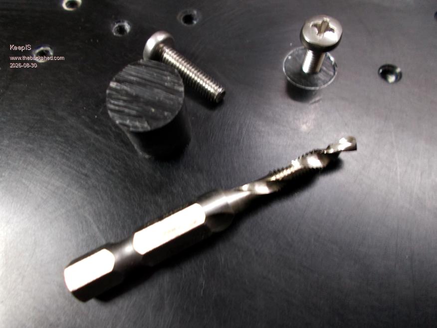

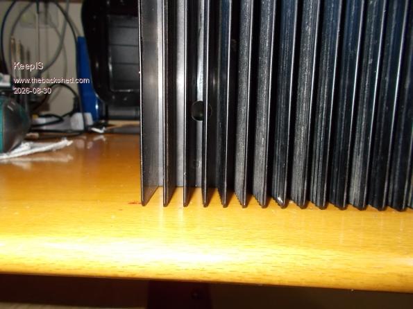

Saved a heat sink with holes in the wrong place, right where I wanted to mount the rails, and a damaged mounting hole that had to be drilled out. I found this is so quick to do, literally takes a few seconds to drill 11mm holes with a small Drill Press, drill press preferred so that holes are 90° to the surface.
The plugs are a form of Polycarbonate rod, had them laying around for years. They were driven in with a hammer and hardwood block you could also use a big vise and press them in, finish with them slightly below the surface.
For initial testing I didn't glue them, I tried to pull one out by tapping an M4 thread and a fitting to act as a stud puller, M4 screw tightened to where the screw driver was stripping the Head of the screw, but it would not budge, left overnight - no movement.
Now it's so easy to tap with those cheep Chinese combined Drill and Tap bits meant for an Impact driver, takes about 6 seconds for an M4 tap. If you somehow manage to break a bit, it only takes seconds to drive the insert out from the the FIN side and pop another in.
So I rescued a couple of old heat sinks (getting scarce now), and as a plus, if you decide to use FETs mounted directly to the Heat Bars, now there is no need to use insulated hold down screws as the mounting screws are already insulated by these inserts.
Which is where the idea initially started, while staring at a damaged Heat Sink, I was about to bin it for another project but decided to try this instead. BTW the Power boards must be mounted in exactly this position on the Heat Sinks to fit into the
existing Dual Inverter Housing.

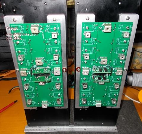

I've been testing two Power boards, one board with the HI Side FET beads effectively paralleled by the FETs by being mounted directly onto the Heat Bar, the other board with all FETs separated with individual FET Insulating pads.
Mike (WG) is correct, the results are definitely in favour of keeping the Ferrite beads in operation. Under some load conditions, there can be a few cycles of ringing in the waveforms on the trailing transitions, and there was a very real reduction in that ringing under various load conditions with the Ferrite beads operating correctly.
When I first tried ferrite beads a few years back, they did not reveal the results that I've noticed today, yes, there was a slight ringing reduction but that appeared to be overshadowed by the inductive kick of the beads, however, these beads are ones that I have not used before, they are slightly smaller that the originals I used, and I was looking at the same waveforms locations back then as well, this could have had an influence on the results.
In setting this up, I found that I really like having fixed FET retaining screws in the Heat Transfer Bars, it makes it so easy to drop all the FET insulators on in a few seconds without any of them moving when the board is placed over the screws and gently lowered onto the silicon pads, this keeps them perfectly aligned even without a smear of heat transfer compound.

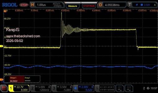

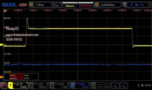

Posted: 02:14am 02 Sep 2026

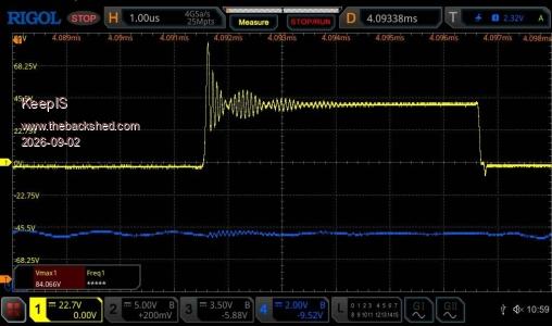

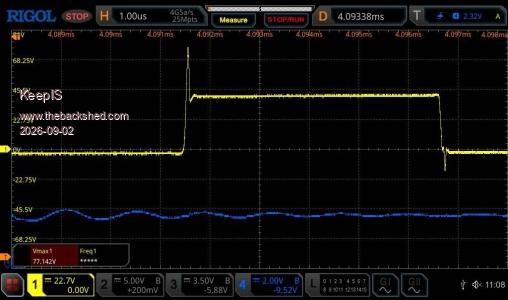

A few DSO captures to follow up:
The ringing shown here is with the test inverter setup, this it the first time that I've had a high power pure resistive load from 700 watts to over 4kW and a 1.2kW adjustable power supply to utilise some of this load testing.
As this is a low power toroid due to quite small primary (Input) wiring, and low current cable supplying the power BUS inputs, there is plenty of scope to see some worse case ringing from this setup. The part of the waveform with the highest ringing component was selected.
Capture with Differential Probe across HI-Side main Drain & Source PCB terminals.
I first tested a board without any Ferrite Beads on the HI Side, then paralleled the Drains to confirm there was no slight change when doing that without beads. There was not.
Note: The power board without beads also has bare FETs, even at 800 watts with some cycling up to 1kW, the tiny FET heat tabs remained stone cold.
Below: No HI-Side beads Unloaded and 1,800uF, same with 30,000uF total CAP Bank.
NOTE: Keep in mind that I'm focusing on one part of the waveform, no ringing here, does not mean there is no "slight" ringing evident (without beads) in other parts of the envelope when unloaded.
Below: No HI-Side beads 800W and 1,800uF total CAP Bank. The worst ringing I could force out of it.

Below: HI Side Beads added, already had LO-Side Beads, 800W with 38,000uF total CAP Bank.
Edited 2026-09-04 11:00 by KeepIS
Footnote added 2026-09-05 10:36 by KeepIS
I may not have explained the last DSO capture fully, which shows the Test Inverter under 800W of load with HI-Side Beads working correctly, by using FET insulating pads between the FETs and the HI-Side Heat Bars.
Except for the change in Duty Cycle due to an 800W load, the Last Image looks like the first DSO Image, that First Image shows the Test Inverter setup running Without a Load, and the Image is the same with, or without HI-Side Beads, UNDER NO LOAD conditions, there is no ringing in the test inverter setup under NO load.
This Last Image shows that the ringing under that 800W Load has NOW been completely dampened / eliminated by the Ferrite Beads on the HI-Side FETs.
