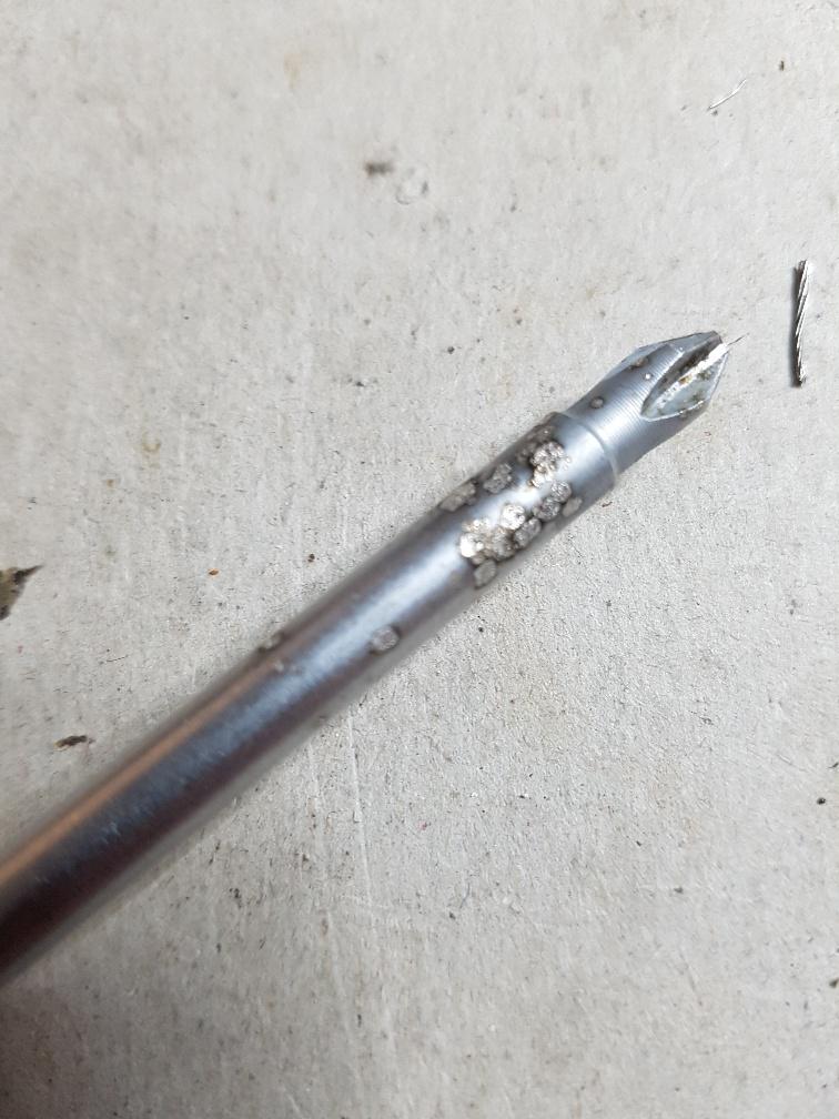

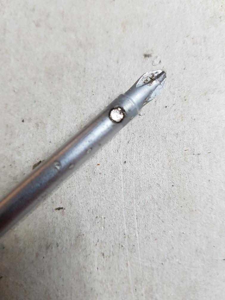

The damage to the screwdriver:
All in the name of science. (as Photinicinduction would say)
Code changes now look for a short and modify the PID loop
whilst shorted. This prevents voltage overshoot when the short is removed.
This is a great start for a home brew big current, big voltage power supply
for the bench and ebike charger.
I want well over 60V and 20 Amps and for it to be indestructible.

reminds me of the time I dropped a screwdriver on a 48v bus bar before the fuses... literally made the section between contact points disappear,  never found it..
and it was a big screwdriver...
lesson learned,  moved + and - much further apart..

Noneya, big current can be impressive.
And when it's DC, it is even a better show.
My only, so far, mistake was to let a nice 13mm ring spanner
short a + and - on a 4 x 200AH SLA bank at 24V. It only just chewed
a little off the side of the handle.
During testing of the above, I had the firmware not looking for short circuit
and just trying to attain the voltage setpoint, while the FET/current sensor thing
was doing it's thing.
I could set the OC protection to about 35 Amps and let the screwdriver graze
a conductor and nearly maintain an arc. 35 Amps at less than 0.5V is not impressive
but it still bites a hole in the metal.
All this and not blowing up 2x nice MOSFETs.
Maybe I could adapt this to be a TIG welder..probably not.

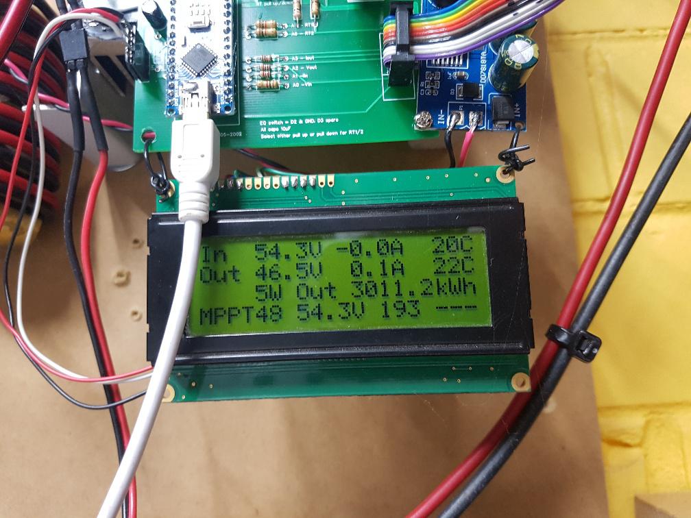

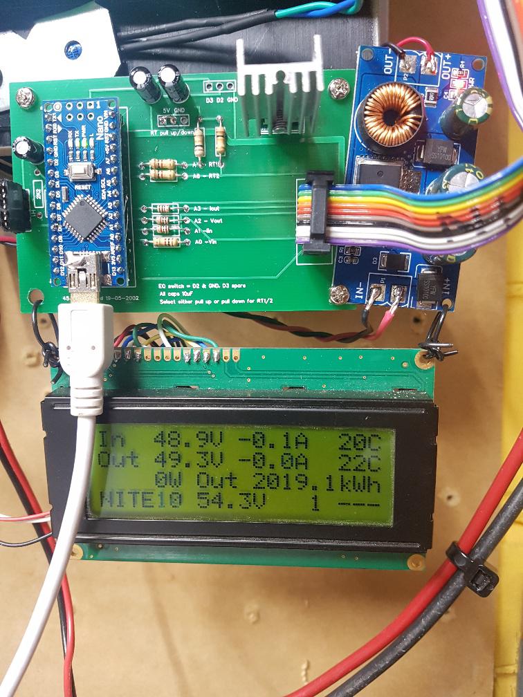

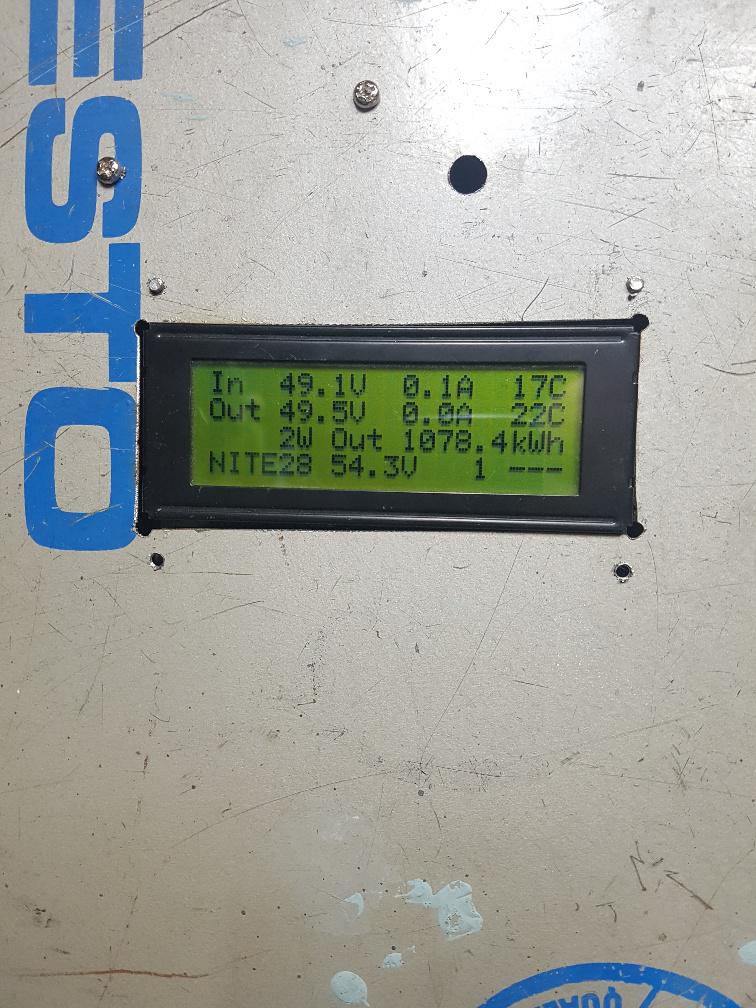

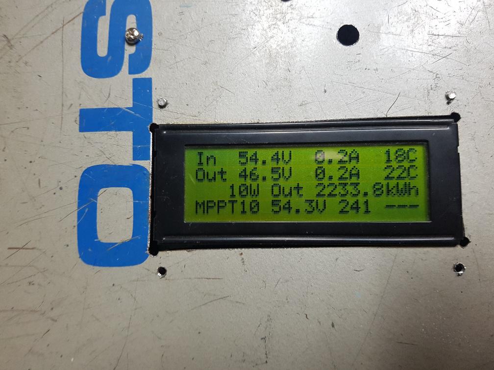

Milestone time again.
I must again thank you all here for your help in developing this project.
I run two of these mppt controllers.
One has a 3kW array facing East
One is 3kW facing North.
The East facing array:
and the North facing array:
They just work and work well.
3 MW.hr of energy has passed through them.
And with an efficiency better than 92%, frequently
in the 95%.
Heat sink temps never more than 35 - 40 C
The North array mppt controller gets to 45 Amp limiting conditions
often, but for short periods of time now it's nearly Summer.
poida

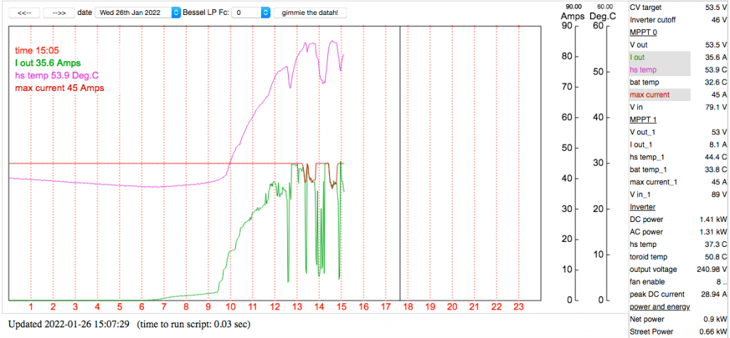

Today it is hot.
the mppts are working well and I have one doing a lot of work
and so the heat sink is getting hot.
I have the output current throttle setting to start at 55 DegC
to reduce output current limit from 45 Amps to zero Amps at 65 degC
It works well. We can see the output limit become lower as the HS temp
exceeds 55 degC and the output current flow suit, never exceeding it.
It's also a bit cloudy so there is not enough power
some times.
data from today so far:
output current is Green
Heat sink temp is Purple
Output current limit is Orange

  poida said  milestone time again
5 MW.Hr from the two mppt controllers.
Both working without any issue
So pleased to see this
HaHa, funny typo, one would think you have a personal power station there .
Your two MPPT's are a lot busier than my single one. It just passed 1100KWh, running with no problems. Back when we had those really hot days the fan came on a few times but had no trouble cooling it while it was charging at 50Amps.
This project was a lot quicker to get going than my inverters were .

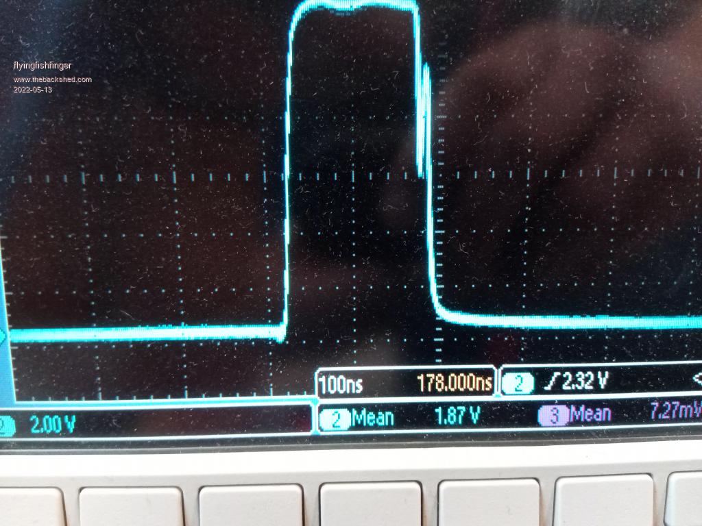

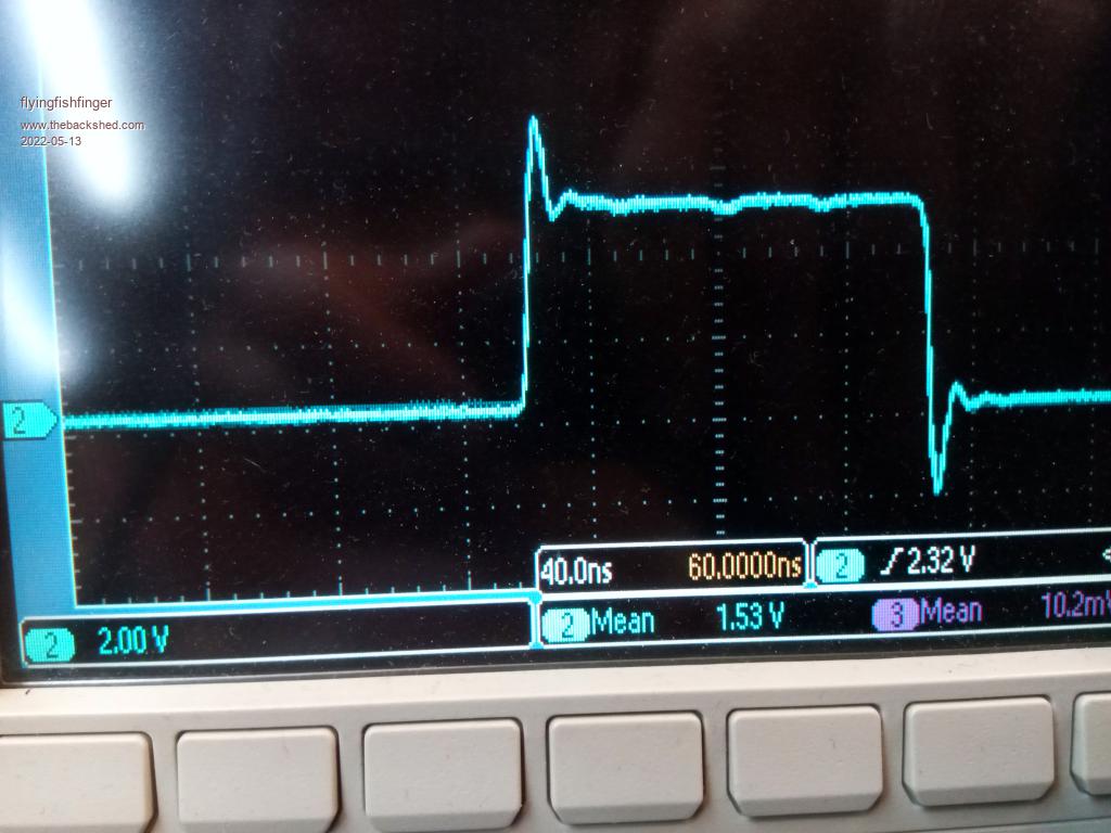

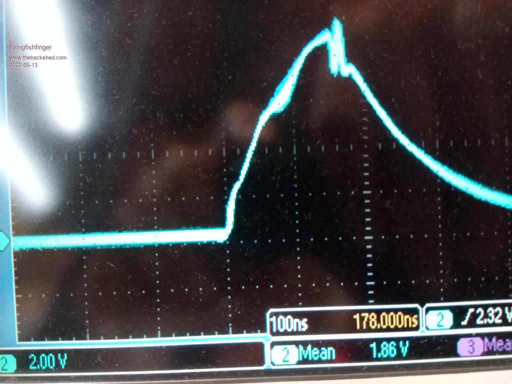

I checked out the PWM waveforms. Out of the Nano:
Output of the optocoupler before series resistor (note different time scale):
Gate of the MOSFETS (after series resistor). This one looks odd, but after reading the datasheet for the FDH055N15A, it's actually not that bad. The normal turn-on delay is 35ns and the turn-on time is supposed to be 67ns....which is about what we see here.
Question: 100ns on time seems very short for this MOSFET. But these screenshots might have been measured with NO load, so having basically 0% duty cycle makes sense for this case. Am I right there?
How do you characterize inductor saturation? Shunt / clip current probe? Will look at it again under load.

Posted: 11:00am 13 May 2022
the values were for my particular boards.
they are not meant for anything in particalur.
I figured others who might use this would use actual volt meters on input and output
and current sensors etc and measure what they find.
This is what you have done already and it's the way to go.
The 100ns on time is not meant to do anything at all just keep running as it were.
This is a minimum PWM width and probably generates very little output voltage.
Typical PWM widths can be calculated from your DCV input and DCV output.
It is the ratio of Vin and Vout
eg.
60V in
30V out
PWM will be 30V/60V or 50% or about 400 clocks or 10us approx.
This is a reasonable working value for PWM
In my case it's more like 75V in, 50V out so it's 50/70 or about 570 clocks
(I've had a few drinks and so the maths could well be RONG)
the waveforms look fine and include some inductance from the CRO lead earth clips I think. This is not a problem.

my intentions for the firmare are:
starting from a discharged battery and enough solar the mppt
will first run at MPPT mode until battery gets to (ABSORB - tolerance)
And then the controller will keep the battery at (ABSORB - tolerance) if it can
for the period defined at ABSORB TIME. IF not enough sun, then the abosrb timer is reset to zero when the battery drops below (ABSORB-tolerance)
so MPPT is only used when there is not enough sun to get to (ABSORB-tolerance)
Float will happen once the battery stays at or above (ABSORB - tolerance)
for ABSORB TIME with no dropouts.
The controller will keep it at (FLOAT - float tolerance) for ever.
But we will always run out of sun so the battery drops below (FLOAT - tolerance)
so triggering MPPT mode which may or may not bring it back to absorb
But since this is night time it doesn't matter if a bit of time is again spent
at ABSORB.
We discharge the battery overnight and it all starts again.
Set your values to suit your battery and situation.
I have something like 3 hours for ABSORB time
It does not get to float very often, only when we holiday and nobody is in the house.
Since the battery is SLA, no need for equalise, absorb will be enough
I could modify the code to switch from absorb to float when
battery is at ABSORB Volts
and
charge current is 1/100 C (eg 400AH battery means 4Amps charge)
and it's been like that for an hour.
May as well go to float.
The firmware is for my use case where there is never enough sun except for 3 months
