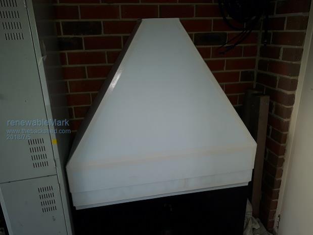

I had to finish the battery/charge setup before I can set up the inverter.
As the battery is in the garage it needed a range hood to vent gasses through to the roof.
Made this out of 5mm coreflute, 2400x1240mm sheets were $25 each (needed 1 1/2).
Going to put 2x 120mm (2 for redundancy) fans at the top, a removable fitting for 120mm pipe on top of hood and a pipe that will go through the roof.
Polyurethane'd a rubber gasket to roof ready for exhaust pipe to be fitted.
Shall I have the fans running 24 hr or time them for day use only when the battery is being charged and producing gasses?
Just thinking I could possibly power them with a small solar panel, that will take care of the timing for me.
Cheers Caveman Mark

Mark, AFAIK the 'gasses' produced by LA batteries is hydrogen.
As this is a lot lighter than air it will rise on its own if given a chance.
As long as the batteries are not in a fully sealed enclosure and the room they're in is well ventilated it should be fine with your hood having something like your 120mm pipe leading outside.
You need room air + gas entering the bottom of the hood for a flow up the pipe.
Not sure about a fan in that, remember, it moves possible explosive gas and you don't want anything that could generate a spark there....

Yeah thanks Klaus,
hydrogen does go boom big time, some of your countrymen found that out with one of their big zeppelins if I recall correctly.
I haven't done an air intake yet, but will have a gravity closing flap on the inside wall.
The fans are brushless so there should be no spark possible (correct me if I'm wrong there), and with 2x fans running it would clear any gasses out fairly quickly so very little would be present at any time.
The vapours given off are also corrosive too apparently. Considering my wife just bought a brand spanking new car I want to be totally sure no nasties are hanging about in the garage.
Cheers Caveman Mark
Off grid eastern Melb

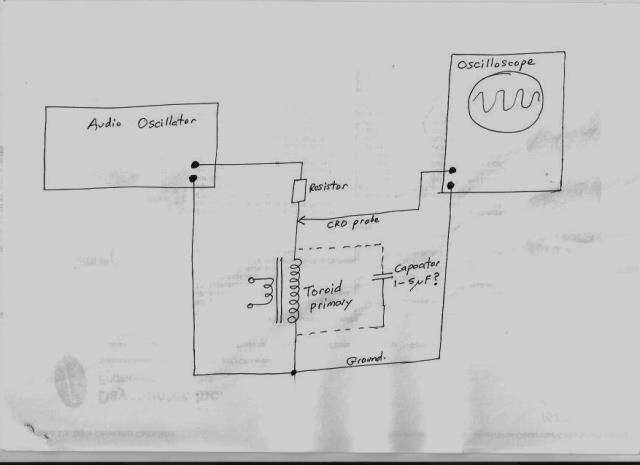

How do you let the transformer and capacitor resonate, how did you test it?
Or do you just calculate it?Edited by nickskethisniks 2018-07-07

G'day Nick,
Tony used a signal generator and fed it through the secondaries and looked at the wave on a cro.
The wave varies as the frequency of the signal is changed.
There is a "sweet spot" where the wave is at it's peak.
With 7uf the frequency for my torroid was 65.
6 uf made it 76hz
But my torroid will be different to every one elses, so don't just go with 6uf.

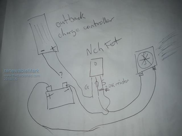

If you change your mind Mark about the fans a N Channel MOSFET with the gate connected to the + output of the charge controllers auxilary and a 20K resistor across drain and source to keep it off when it should be will work. You then connect the negative from the fans to the MOSFET Drain and the source of the FET to ground. A 12V power supply between ground and fans + and your in business.
One those 48VDC - 12VDc converters will work or a 12VDC wall wart will drive the fans with no problem.

So like this yeah?
Where does the neg from charge controller go?
Cheers Caveman Mark

Connect up the secondary through a 1K resistor to an audio signal generator, and monitor the voltage with an oscilloscope. A definite peak in voltage will be found at the parallel resonant frequency.

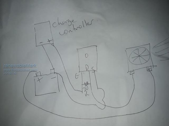

That negative wire goes to negative on the battery, the resistor goes between the gate and source not the drain as per your diagram (I just read my previous post I EFFED up, definitely gate source resistor) . The resistors job is to keep the gate at 0 volts when there is no 12V output from the CC Auxilary, otherwise, the gate will float and have the MOSFET turning on by itself.Edited by Madness 2018-07-07

Frigg, I can't edit or even remove the diagram above.
So like this then?
Like my artistic woosh from the fan?
Edited by renewableMark 2018-07-07
