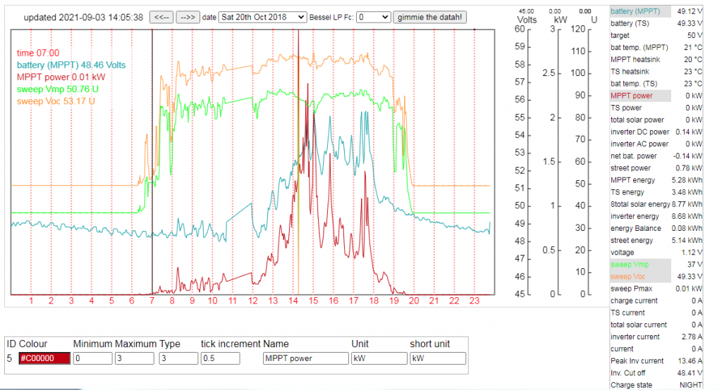

Looking at a solar array's output
For example, it might be 3 250W 35V open circuit panels in series.
This gives about 105V DC output in strong light.
And a battery could be a 48V nominal lead acid battery.
WE need to convert the 105V to 54V for a reasonable charge voltage
for the battery. The buck converter is ideal for that task at the power
levels found with home built systems.
The sun has set now and the array is making only 60 V. and with little current too.
The buck converter can not do it's job without some voltage drop.
I estimate about 1 volt. This places a lower limit on the input voltage for a given output voltage. For the 54V setpoint, I would see no point in even running the
mppt controller if the input is less than 60V. Maybe you could get a few more Watts, maybe 10 Watts out of the 3 panels in series when illuminated with such low light levels. So I disable the converter and wait until the next day.
The firmware checks for input voltage greater than setpoint every 60 seconds.
If it's stopped in NIGHT mode and now greater, it starts up, usually in MPPT mode.
If it was running in MPPT or ABSORB, and input drops below setpoint,
it goes to NIGHT mode and stops the converter

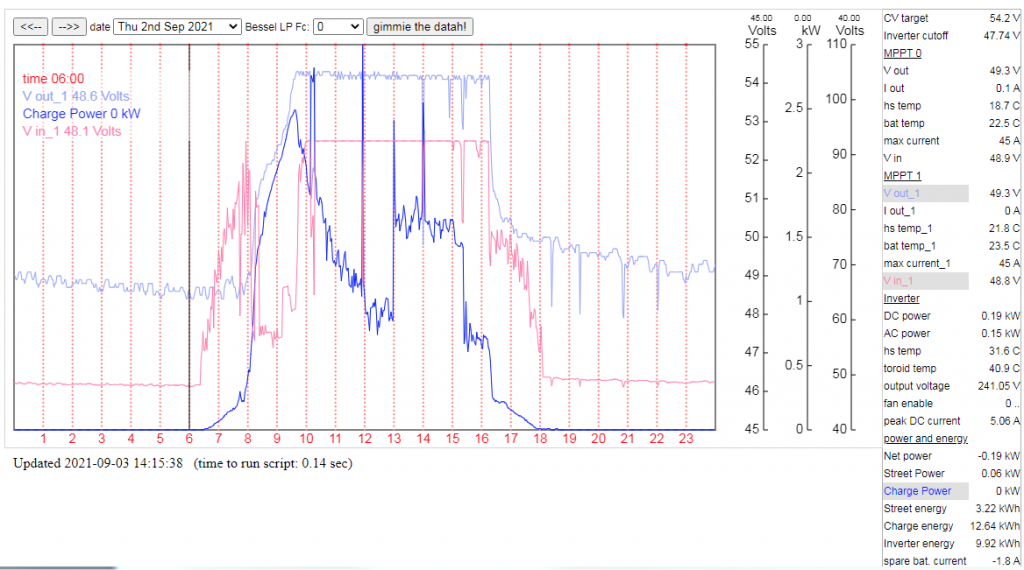

Posted: 11:32pm 02 Sep 2021
What happens is the maximum power voltage never changes much from dark to mid day.
What does change is the panels ability as a current source to supply current.
What the MPPT software does is to increase/decrease the loading on the panels to hold the voltage at the max power point (whatever that voltage happens to be).
As sun power diminishes at dusk the MPPT finds that to hold the voltage up, less and lass current is available. Eventually the duty cycle falls to zero.
As it gets even darker, the voltage falls further, even though there is zero load current on the panels.  It cannot cycle, it just slowly fades away and shuts down for the night.

here is data from the MorningStar 60A MPPT controller I had first
before the home built mppts.
I show what it calls Sweep Vmp and Sweep Voc  (V max power and V open circuit)
They use a different scale than battery voltage.
They are also maximum values found during the mppt sweep.
So it's likely Voc was maximum at the start of the sweep when
very little power was sent out to the battery.
But once the dc-dc converter starts, the input voltage surely drops to
BV - MOSFET/diode drops
During the early morning Voc was 53.17V, battery was 48.46V so let's rock and roll
and make power! The power generated then was 10W.
I think you are examining these borderline conditions, am I correct?
Similarly, data for my mppts is below:
we can see Vin is about 0.5V less than Vout (or battery, same thing) at 6am
when it is still rather dark here.
Note again different voltage scales. The vertical line is at 6am and the exact values
are shown on the left side at that time.
Please ignore the charge power curve. It is the sum of two 3kW arrays,
one not making any power, the other doing most of the work.
I can explain what's going on with this curve but that will be a long story
and we can't have much interest in that right now...
My mppts will be checking every minute at all times if Vin > Vout.
IF so, do the mppt scan and run the converter
If not, wait a minute.

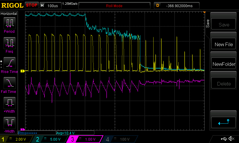

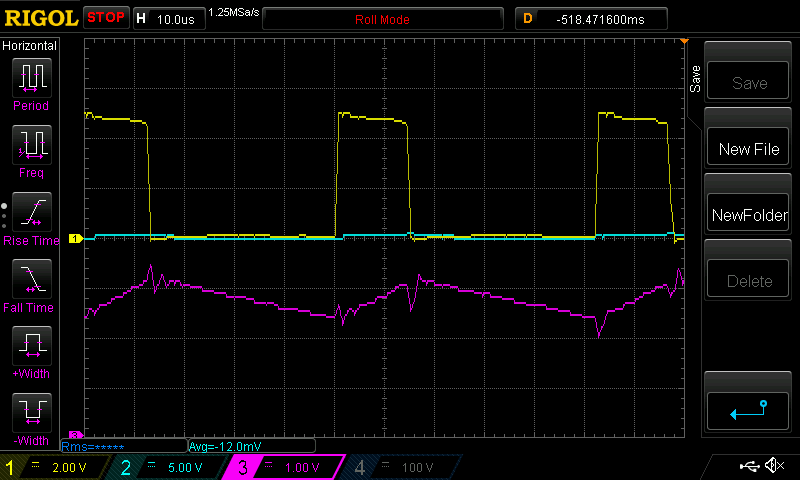

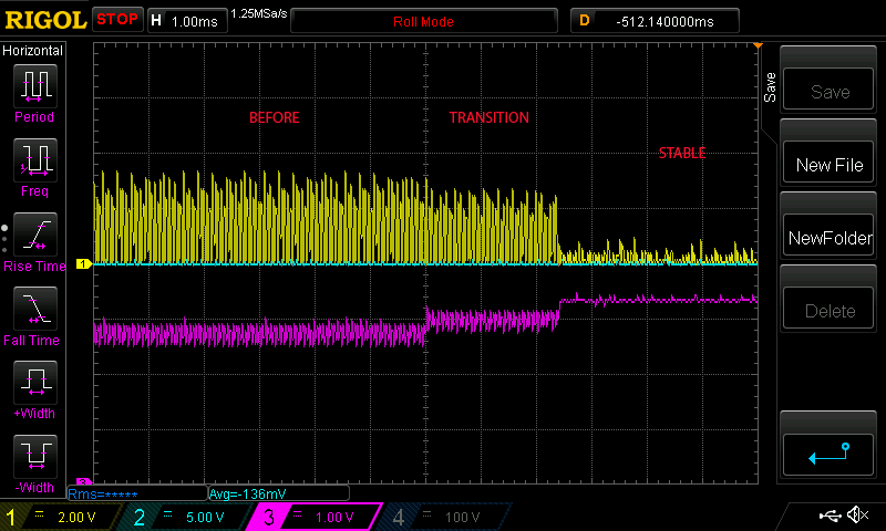

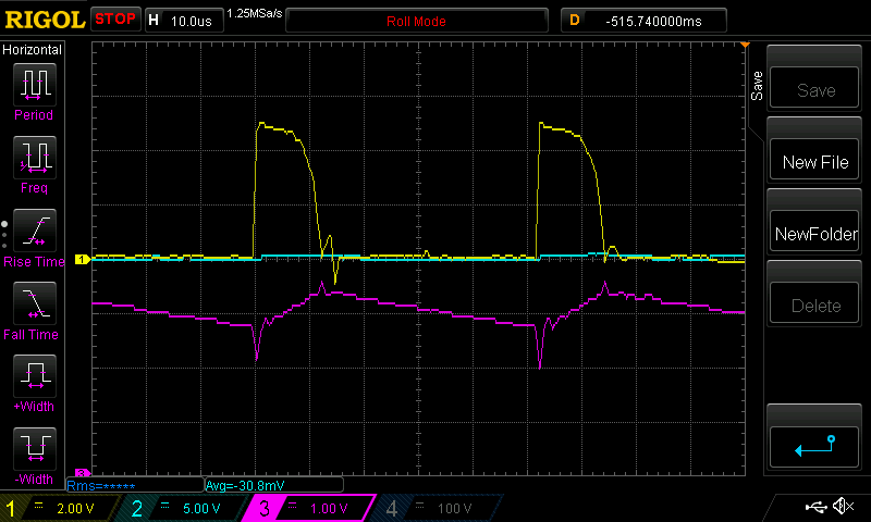

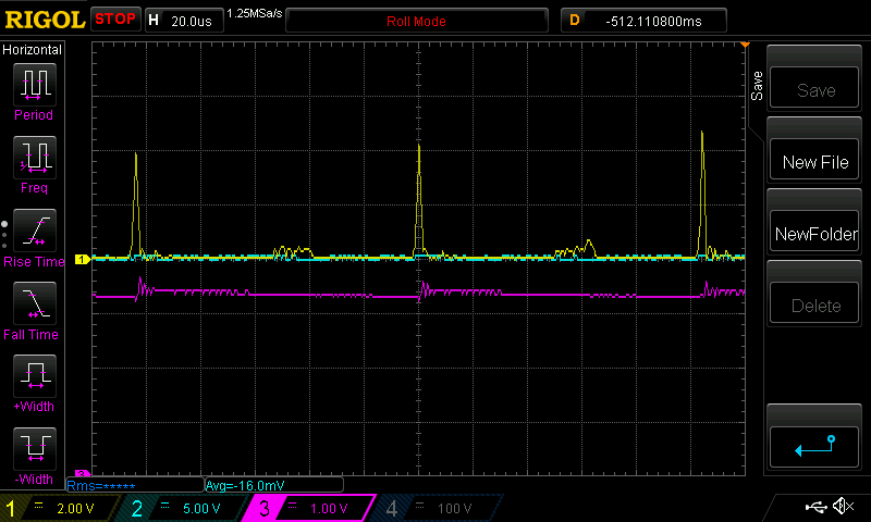

Here are some DSO captures of the short on the output event.
Yellow is PWM signal going to the TLP-250 input diode
Purple is the current sensor output after the trimpot divider,
which is also FET gate voltage.
Light Blue is not connected.
This is the event before & during the short.
The graph is not nice to see due to the huge time compression.
No idea why the current is constant during transition period.
Would it not increase steadily? (edit: this is due to the time taken
for the "switching" of the screwdriver short-out. Sometimes there is
no transition 'cos I was much faster with the screwdriver)
Close up of before short.
Transition.
Close up when things are stable. It's alternating a short pulse then
a nearly nothing pulse.
You can see the current sensor output/Gate voltage rise to the
required voltage for the IRFZ44N to conduct the 5V PWM drive
This voltage appears to be 3.3V or thereabouts.
The specs say 2.0 to 4.0 V. Ok that's a wide range..

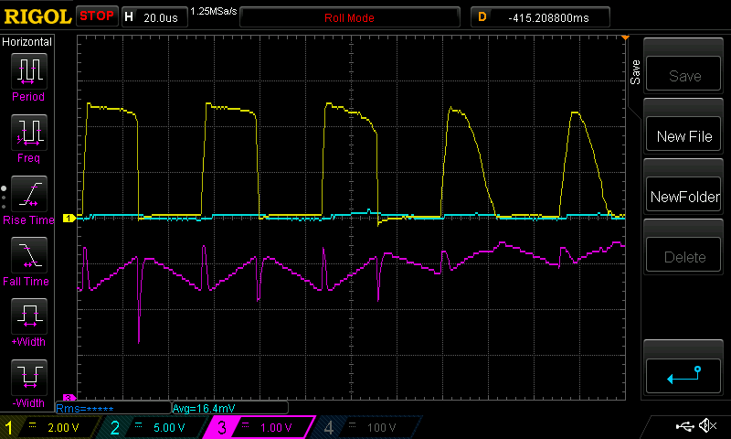

Finally here is a capture of when the screwdriver made contact.
(the Gate voltage now shows effects of too low drive current thanks to
the trimpot's setting. I had it set at about 35 Amps max current)
The left most pulses are when inductor current is below 35 Amps
The middle pulse is the first to be altered by the FET
And the last 2 are clearly getting smaller.
(For those who may not know, pulse width is proportional to inductor current.
Longer pulses means higher current)
Since the Gate voltage trace is 1V/div, and the threshold is about 3.3V
the equivalent current is 10 Amps/div approx.
We can see the current rise rise from about 25A to 35A over 5 pulses
or 250 uS
The combined response time of the LEM sensor and the FET seem to be more than
fast enough for this task.

Here is is again with output voltage in Light Blue.
This was a faster switch event.
Output voltage was 18V.
