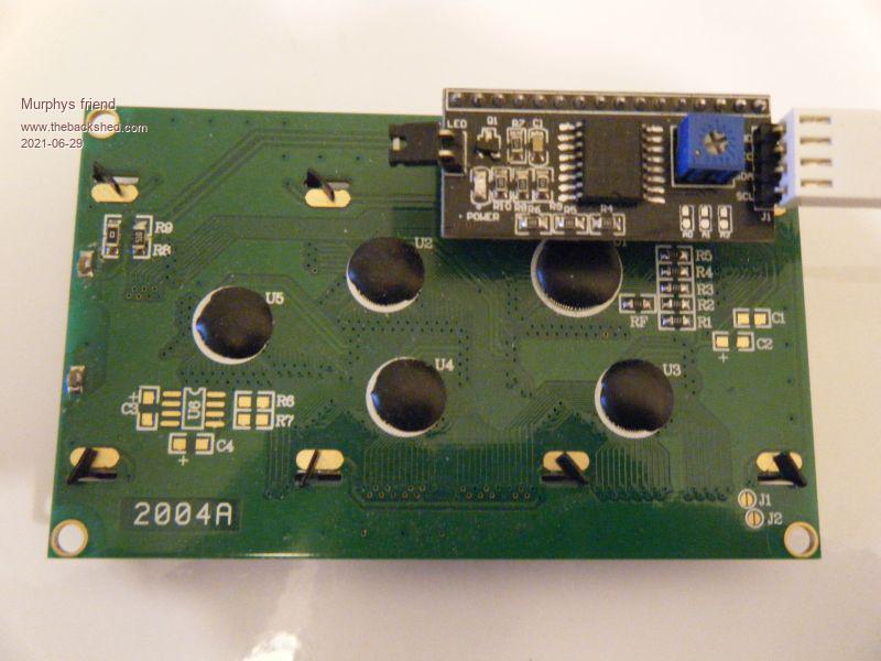

I'm looking for another project and this one looks a good candidate. Doing PCB artwork is something I actually enjoy so the boards will be my own design.
No doubt there might be more questions as I proceed, especially when it gets to programming that Nano, but for now those schematics and the 36 pages of info in this thread should keep me occupied for a while.
Thanks again.

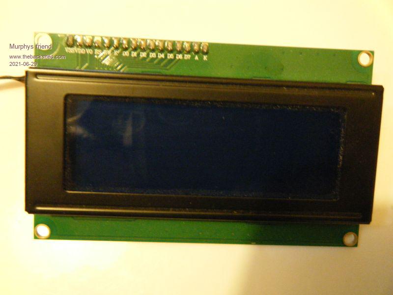

It looks as if I have a question already , I found this display panel;
It looks as if  it has that required serial port on the little piggy back PCB, would this be suitable for the home brew MPPT project?

It has the I2C port. 4 wires, 5V, GND, clock and data.
It is easy to connect this LCD to yet another nano, program it and then connect the nano to both the LCD and the mppt.

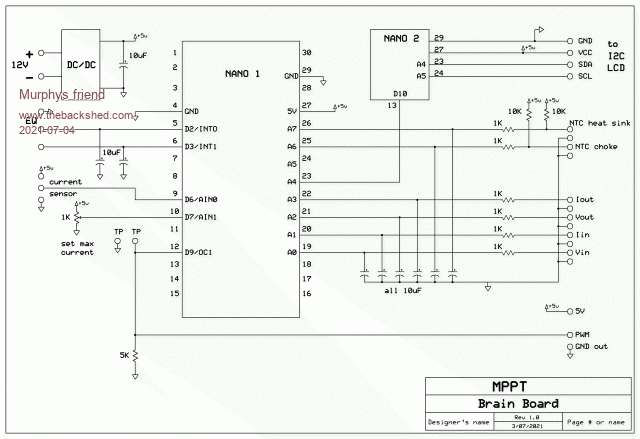

Poida, I took the liberty to re draw your schematic to include what you wrote in the post above.
Can you please have a quick look to see if I got it right or missed something? Thanks.
Note, There is no 10 pin connector, I don't like the ribbon cable idea. I made provision for shielded cable for the V & I in/out signals. I'm also using a small (3W) isolated on board DC/DC to get the 5V from a battery voltage to 12V DC/DC elsewhere.

it looks about right.
I would drop the current sensor (pin D6, D7) since I have little faith
it will work.
I do like how you have made a clear separation of the I2C and the Nano1 that drives the PWM.
The existing latest code will work with this too.
Make sure the 5V supply can drive the LCD and Nano2.
I would allow 100mA for that.

Thanks Poida, that was a quick reply .
I will drop D6 & D7, the less parts the more room for others on that PCB .
That 5v DC/DC can do 600mA, should be enough  for all the 5V requirement. Its a RECOM R13 Series isolated converter I get from RS components. Nice and small too.

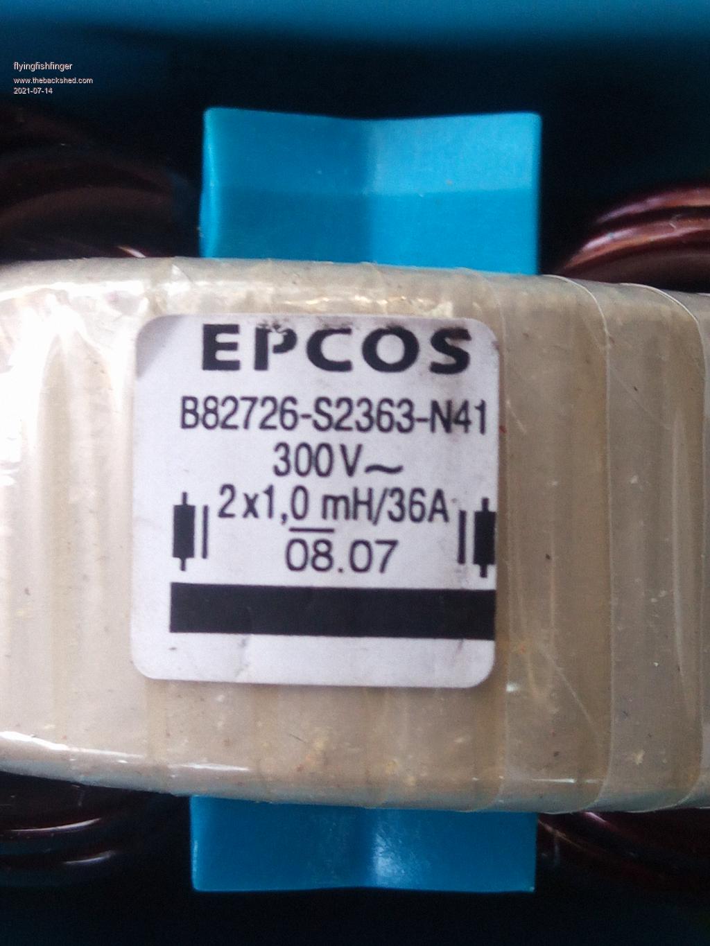

I got a busted Sunnyboy! It has 3 of these chokes in it, along with all the caps I'll need:
If I put all three (so 6x coils) in parallel, I get 166uH.
I'm not sure if the current rating applies to each coil or the whole part but either way that would make 108A or 324A current capability.
Sounds to me like this would work as a choke, right? I'll build it up later and try as well.

I don't think it would work,, those chokes you have are common mode chokes.
They are used to filter high frequency noise. Not suitable for energy storage.

I think one or more of those chokes will be useful.
Maybe do some saturation tests?
The choke's requirements:
my design running conditions are
100V in
50V out
20kHz PWM
45 Amp max output current.
100V down to 50V conversion means a 50% PWM width.
At 20kHz, this means the pulse width is 50% of 50uS
or 25uS
Delta V is 100 - 50 Volts and that is what the inductor is exposed to
for that 25uS.
inductor equation
V = L x dI/dT
re-arranging for L we get
L = V x dT / dI
dI = 15 Amps ripple, say
V = 50V
dT = 25uS
L = 50 x 25E-6 / 15 = 83 uH
In practice, I found something like
100uH to be good, which means about 15Amp ripple going into the output
capacitors.
More Henries means less ripple. It's a linear relationship.
Ensure the choke does not saturate too much at your required output
current. Some saturation, e.g. a 1/2 of inductance during the last 20%
of the pulse width is minor.
(that is, you will see the current increase 2x faster when measured and shown
on the DSO at the end of the pulse)
The effective inductance is the straight line of the current
through the inductor for the whole width of the pulse,
going from zero current to the end of pulse current.
A time averaged measure of the inductance over 50uS, for the 20kHz pulse
I found it very instructive to test the inductor in circuit, observing
the current through the inductor alongside the voltage at the switch node.
You will see the DC current and on top of that, the ripple current
at various operating conditions.
Posted: 03:53pm 14 Jul 2021
It may also be a good idea to run it for an extended time at very slight load and test for any significant core self heating.
There will be a considerable constant square wave 50% duty cycle ac voltage impressed across that choke, and volts per turn are going to create some significant ac flux swing.
Core losses will vary greatly with the material.
It could run stone cold, or it may get very seriously hot.
There is a big difference in running the same identical 100uH choke in an inverter with duty cycle modulated PWM at 48v, and at constant maximum worst case 50% duty cycle in a solar controller at 150v.
It will probably be fine, but a half hour run at low load current will definitely tell you.
