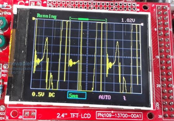

OK I found why it only gave one quick buzz and stopped last night, the control board lost the 18v, so after the zener was fixed it worked again.
Did all the other tests and it appeared to be ok so hooked up the toroid with a resistor set and fired it up.
There was a terrible buzz and the wave looked like spew.

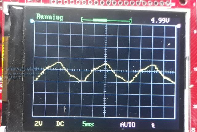

This was the wave under resistance fed supply.
Cheers Caveman Mark
Off grid eastern Melb

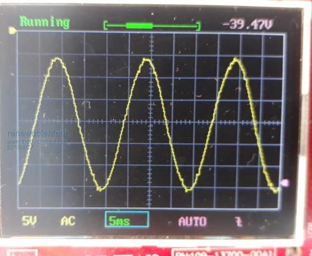

Posted: 08:24am 17 Jun 2018
What did the SPWM and square wave look like, the picture above doesn't look right to me. The voltage levels are lower in the pic above but should be more like this one you posted a while back.

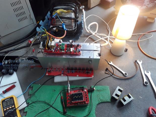

Posted: 03:59am 18 Jun 2018
Persistance finally paid off.
Need to fit caps and do a proper power test, but I'm happy it's running!!
Voltage is a tad high @280, I put in a 10k resistor instead of the 7k5 but will need higher? Or is something else wrong?
Cheers Caveman Mark
