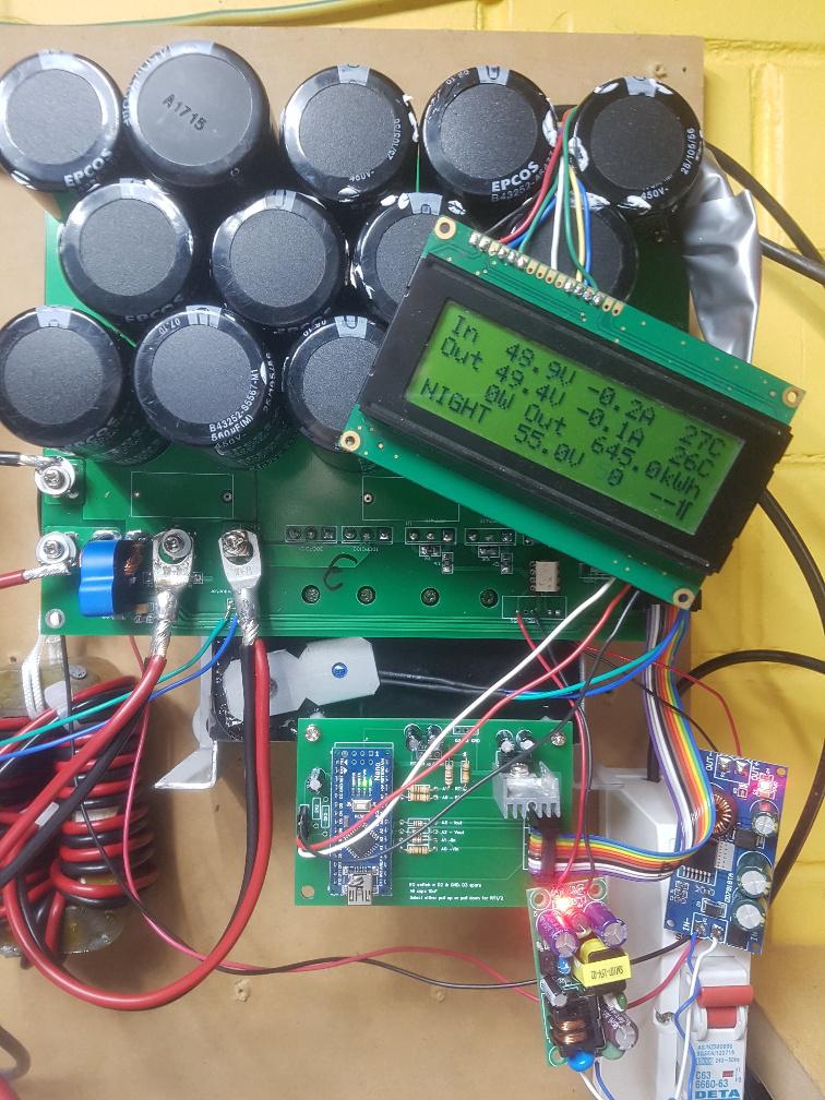

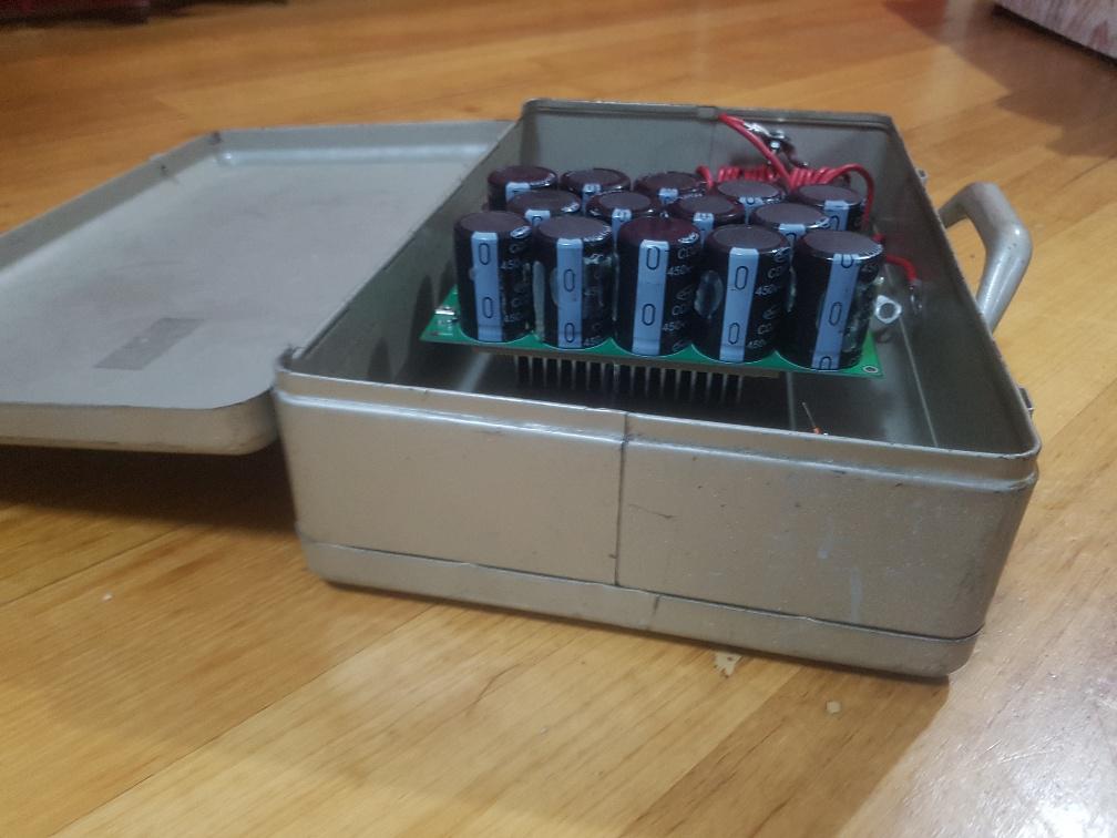

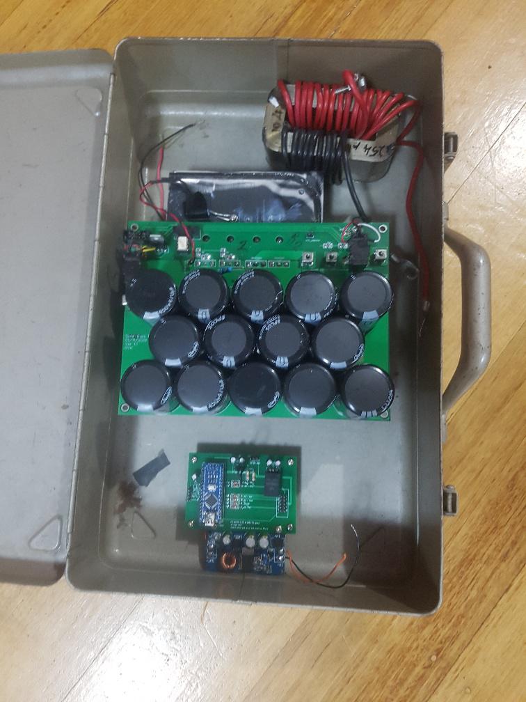

I found the ideal enclosure for a mppt build.
But it's pretty much rocking horse poo.
I have only the one.
perfect size, with a front door on a hinge for easy access and nice latches.
and by the way, the working mppt has got to 645kW.hr

Posted: 11:06am 17 Dec 2020
Peter, WTF gauge wire have you used on that choke?
It looks very thin.
The one in the box is different to the last pic you posted, that's just a test one right?
Edited 2020-12-17 21:08 by renewableMark
Cheers Caveman Mark
Off grid eastern Melb
poida
Joined: 02/02/2017
Posts: 1507
Posted: 11:14am 17 Dec 2020
2 x 4.5mm2
It does not get too hot when running at 2kW
I've seen 38C, never 50 or 60C
I should be using something bigger but I seem to get away
with murder sometimes so if I can, I will.
The cable is the so called "6mm2 solar" cable sold on ebay.
It has a thin black cover for both Red and Black conductors.
I strip that and use the inner cable.
It seems I get a very good copper area for the overall diameter.
And the PVC is much more heat resistant than the crap I got from Jaycar
as seen
https://www.thebackshed.com/forum/ViewTopic.php?FID=4&TID=12773
I have enough space to run 3x but 2x is enough for this with the big laminated
core.
Edited 2020-12-17 21:14 by poida
poida
Joined: 02/02/2017
Posts: 1507
Posted: 11:21am 17 Dec 2020
The one in the box is just a test choke. I used whatever cable I had to make enough turns to get to a useful test value of inductance.
I think I will use that core, but probably put 3 in hand windings through it
of that 4.5mm2 cable to get to about 100uH.
The choke in the picture with the box is 254uH so there is some room
to wind up something nice with a core this size.

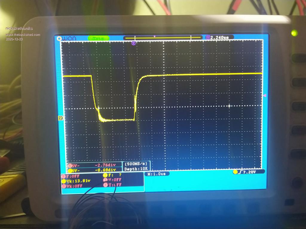

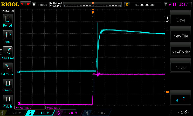

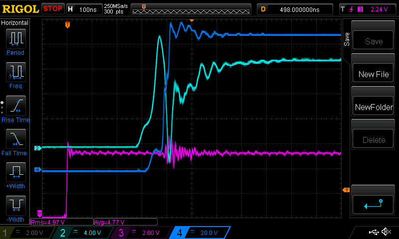

Posted: 08:58pm 22 Dec 2020
Hi all,
The new brainbord ( Poida’s pcb) of my mppt controller is doing great! And is approaching the 200kWh mark.
So, I started a new project (more on that later) and I was doing some research/experiments with gate drivers/mosfets,.. I tried more then 10 different mosfets with some different gate resistors in a buck converter testing rig. 30V 3A in , 14V 6A out. And each time I’ve got different results in the gate turn on and turn of curve.  When using for example 10R turn off and 20R turn on resistors I had some gate ringing around the miller plateau. And a rather strange turn off curve near the end. Choosing higher gate resistors helped reducing the ringing/oscillations. Ferrite beads were not helping most of the time, I only had 1 type. Adding gate/source capacitance like 4n7 was helping significant. I had the feeling that the higher (voltage) the mosfet was rated the better the curves were.
I’ve tested IXFH110N25T, IRFP4110, IRFP4468, IRFP4668, IRFP4868, HY4008, IRFP064, RFG75n05, STP15810, IRFP150
Even IGBT’s, some salvaged Ixys parts
I also tested a lot of diodes: RURG3020C,STTH6003, STTH6002,VS-60APU02-N3, 30CPQ100, 30CPQ150, MUR3020, 16CTQ100
Most impressed I was about the combination IXFH110N25T and the 30CPQ100, the ixys had little small oscillation around the miller plateau and a straight turn off line I never saw with the other mosfets I’ve tested. With the 30CPQ100 there was 15V shoot thru, the 60apu02 came close. The rest was around 20V, a ferrite bead helped at least 5V. But then there was more ringing during the turnoff…
So even for an old part like the 30CPQ100, it actually gave the best curves...
The igbt’s also impressed me a lot, they actually gave the best results, such nice turn on and off curves!!! But they produced lots of heat as well…
All the irf parts were oscillating as hell.
I must say it was just a small (though verry time consuming...)at only 100W...

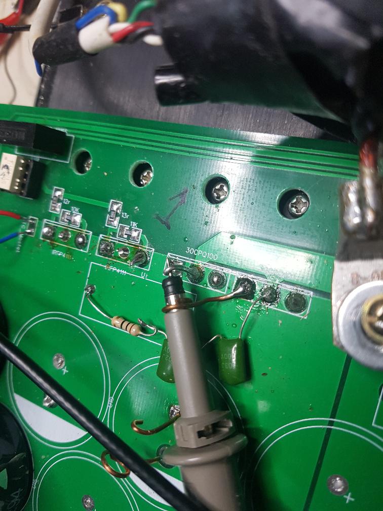

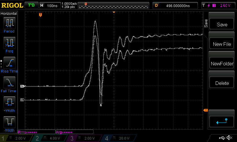

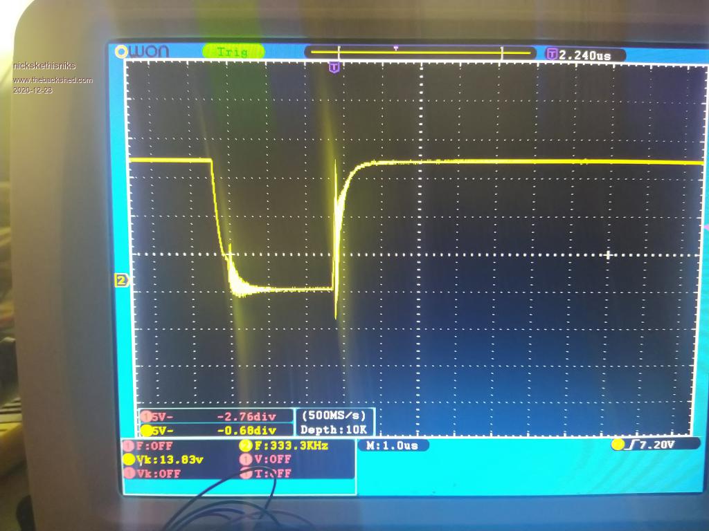

But then I was wondering, how were my curves on my mppt controller mosfets? And then I thought I never probed my second parallel mosfet in my mppt controller. Did you probed the second mosfet, Peter?
I saw pictures with your probes soldered on to the pcb, but if you would retest and had soldered your probes on the mosfet itself you would have had even better curves!
I noticed some serious difference between the 2 parallel mosfets, I’ve made a testing rig with my new pcb and with pcb terminals so I could easily swap mosfets and diodes out, and I noticed the length of the mosfet legs matter a lot. If I probe close to the mosfet things look already much better. I’m using probes with a 1cm stiff wire soldered to it.
These are pictures from my scoop on the mppt controller, I used 12R gate resistors, IRPF4110 mosfets and apparently more then 15V gate voltage. I think it was doing around 60A.
In my next pcb layouts I will place the drivers as close as possible and more symmetrical.
These are my results:
First mosfet closest to the driver:
Second mosfet:

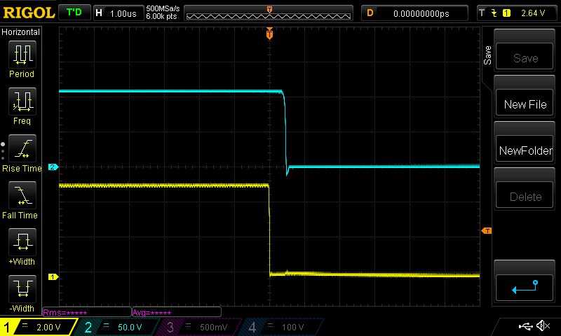

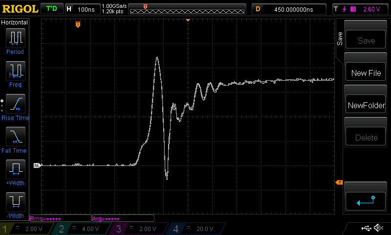

poida
Joined: 02/02/2017
Posts: 1507
Posted: 12:17pm 23 Dec 2020

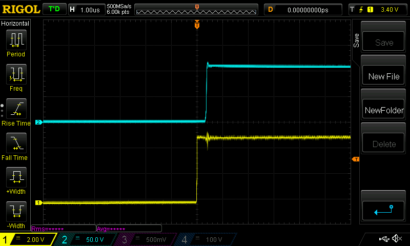

Nicks:
this is interesting. I am using one of your boards as my test mppt board on the workbench.
I am open to the suggestion that the MOSFETs can behave differently and can be shown to be different when you probe them.
If I was doing this I would ensure identical ground connections for both MOSFET's probes. Even 50mm long ground wire is a "too long inductor" ground wire.
It's probable you have good probe technique already here.
My best combination is HY5110 MOSFETS used as diodes and the
Fairchild FDH055N15A 150V MOSFETS as MOSFETS.

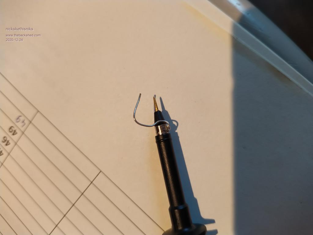

Here is what I see on the switch node (the point where the MOSFET's SOURCE is connected to one of the leads of the inductor.
Blue is switch node.
Yellow is gate drive out of the nano into the TLP250
105V input, 48V out at 41 Amps (2000W approx.)
I used the same horizontal timebase setting of 1uS/div
switch ON:
and OFF:
how I probe the Blue trace.
This is good probe technique. Very low inductance earth lead.
This probe location on the PCB lets me use DC ground as ground.
That sounds a bit silly but it's a nice low impedance ground location to connect the DSO probe ground to.
No ringing at all.
I have a small RC snubber on the switch node to ground.
You can see it underneath the probe in the above photo.
10R and a 102 and 103 cap in series.
It just seems to work well.
(2 caps in series? I must be on drugs. so it's likely a 10R and 103 cap in reality)
edit: NO. its 909pf or a little less than 103 on it's own
Edited 2020-12-23 22:24 by poida

Yes that is, I like it's big screen a lot. I'm used to work with tektronix at work so there is a quality difference. But the owon is good value for the money and more than good for what I'm doing. I'm using SDS7072 which can also work on a battery, but I was on a budget 8-10y ago so didn't order it, but I can think I can hack that part now . I will switch to a 4 chanel scoop in the coming years, sometimes I mis an extra input. And maybe an differential probe.
It was used for 5years in a not heated shed so it had a rough life temperature and moist, the potmeters/encoders for Volts/div and sec/div need to be changed. Sometimes if I want to adjust the timebase or amplitude it goes the other way around.
This is what I use for testing gate signals:
Peter I would like to see your gates/source signal, but you don't need to.
I'm just looking for improvements that can be made in my next designs, it's allways a trade of between lots of things .
In a next order I will try to order that mosfet you are using just to compare .
I will try testing the switch node, but it's a clouded day (200watts...)for this moment so probably not much interesting to see on the scope. I'm sure this signal looks much better than what I see on my mosfets gates.
Edited 2020-12-24 20:46 by nickskethisniks

Nicks:
since the SOURCE of the MOSFETs is at either input voltage or output voltage,
we can not connect it to DC supply ground. Which is also DC output ground.
Which is also 12V supply ground.
When probing the gate voltages of the two MOSFETs the probe "ground" is
DC+ supply or DC+ output so I use an isolated probe.
I don't want to float the scope since I am certain I will make a mistake
and be needing a new DSO.
here is the left hand MOSFET gate voltage and the TLP250 input.
I use the same timebase as you have 1uS/div
105V in, 2050W out at 40 Amps roughly.
It looks just like yours.
Pink is TLP250 input
Light Blue is gate drive.
I use the 12V isolated dc-dc supply
The differential probe does have good bandwidth suitable for
100nS/div so here is the same thing at this timebase.
Dark Blue is the switch node voltage which swings from
0 to 110V
The diff. probe inserts a delay of about 14nS so bring the Dark Blue
trace to the left about that to line things up - not that it makes much difference.
Having MOSFETS connected via their SOURCE pins to voltage swings of
0 to 110V rising in less than 100 nS puts a lot of strain on the
floating 12V supply, TLP250 output stage, and pcb traces connecting all that
and the MOSFET's GATE and SOURCE pins. The whole lot needs to swing up
to 110V and do it quickly.
I do not know what is real and what is caused by the huge common mode voltage swings.
I recorded both left and right side MOSFET gate voltages using this timebase.
One is above the other. They look the same but it's hard to see differences in
voltage.
Now I put one on top of the other, using identical probe setup
(which inserts identical spurious noise signals too)
and they appear identical.
I suspect that when you rework the PCB you will not obtain any improvement
in reducing the gate drive differences since to me there is none at all.
Edited 2020-12-25 16:01 by poida
