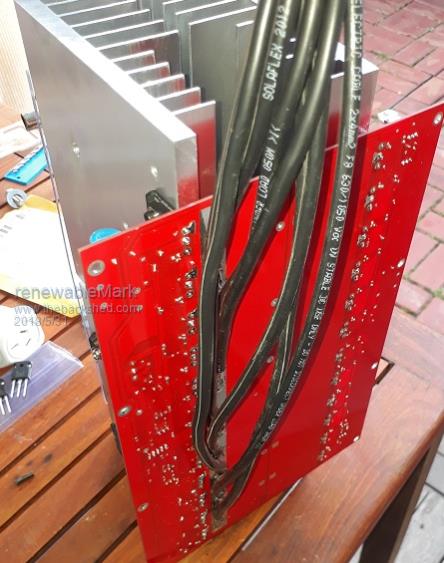

Posted: 09:19am 31 May 2018
Jeeez, really sorry for the slow progress and updates fellas, just finding it hard to get spare time.
Did the neg wires with 8x 4mm2 solar cable, I'm thinking that will be OK, sing out if you thinks it's underdone. It will be doing the 240w idle that the house does with no one home and the normal loads when we are home.
Now FINALLY it's ready for testing.

Edit... bloody goose ... did the math 8x4=32mm2, that's about half it needs.
I'll just test it like that for now and fix it later.Edited by renewableMark 2018-06-01

Posted: 10:53am 31 May 2018
Looks very professional Mark.
The Solar wire is designed to be safe at 1,000 volt so a lot of its thickness is insulation. However 200 amps through that wire assuming an average length of 300mm is only going result in 6.5 watts. You won't be drawing that much power through it for very long.

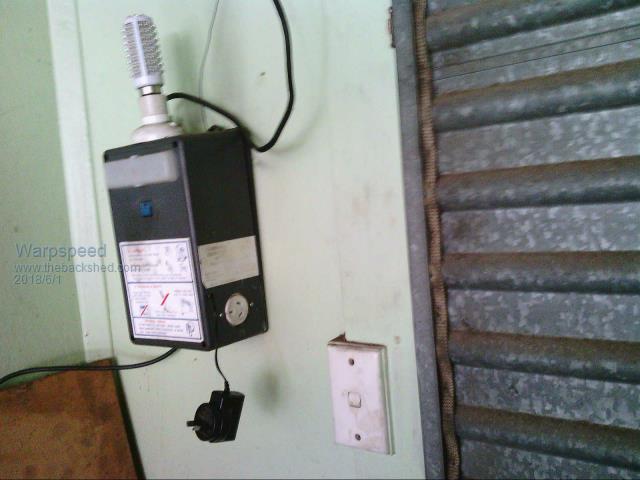

Posted: 11:57pm 31 May 2018
My garage door opener has two circuit boards inside. One is the radio receiver board that is some mass produced product the garage door opener company just bought in and stuffed into the same plastic box along with their own larger circuit board.
Its cheaper to buy a ready made Chinese radio remote, and receiver circuit board, than manufacture something like that yourself here in oZ.
Anyhow, this radio receiver board needs to be constantly powered with +12v and produces a relay contact closure when you push the button on the remote.
Doing that also turns on a 12v light fitted to the garage door opener that stays lit for a minute or two (useful at night).
So all I did was constantly power the radio board directly from a 12v plug pack.
That draws 1.8 watts instead of 16 watts for the original system.
When I push the remote button, that sent +12v to a solid state relay that connects 240v to the big main power hungry transformer, and the garage door would open or close normally. I also used the light circuit to keep power up to the solid state relay for the required minute or two. After that it just reverts to just the radio receiver running.
Cannot now remember all the exact details, I did all this over three years ago.
But if you get inside your unit, and figure out what is going on, some kind of demon modification may not be all that difficult to do.
One other thing I did was replace the pissy little glowing yellow 12v light globe with a real 240v LED light, wired up to the same solid state relay.
For some reason I cannot post a picture?Edited by Warpspeed 2018-06-02
Posted: 12:04am 01 Jun 2018
I disconnected the plug pack, as plugged in its almost invisible (black on black)

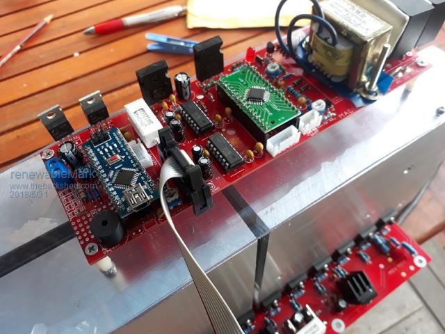

OK tested the boards today,
I got the control board to run fine, nice signals on the scope.
But when plugged into power board it kept popping the 8010 chip, which is a real pain to solder.
So I tested the Mad control board on the clockman power board and it ran, so at least I got that bit right.
Then found a solder short on one of the tip 41's on the Mad power board , it got too dark and I needed a beer, so I'll fix it later, might replace that and nearby caps just to be sure.

Posted: 02:36pm 03 Jun 2018
Are you sure about that Mark? That chip just shuts down if something downstream is not right, try it again when you fixed that totem pole short. Still in need of soldering lessons?
The only 8010 chip I managed to upset was when I got that LED connection mixed up, that function no longer worked then but the chip still produced all the correct wave forms for the 2110 drivers.
Posted: 08:01pm 03 Jun 2018
I have destroyed at least one back in my early days with these things. 48V came back via the SPWM, the electrolytic capacitors connected to the IR2110's exploded, IR2110's shorted out and the EG8010 died also. But Klaus is right the EG8010's don't normally fail.
Posted: 08:08pm 03 Jun 2018
  renewableMark said   OK tested the boards today,
I was really hoping for a trouble free test, but my track record doesn't really show that's likely
At least I built the control card well.
Getting one board right is a good start, the main thing is you are learning. You know next time it pays to check both sides of the PCB after soldering.
The capacitors should be fine, probably the TIP41C also, try connecting the 18V power on the power board to that gate and see if it turn on and off.

Posted: 09:04pm 03 Jun 2018
Looks like it, you can come over to Melb and give me some lessons, AND paint my house while you're at it.
8010, hmmm yeah I think they are rooted.
When it didn't work I put the 8010 card into the Clockman board that I knew was working.
Don't know how but when I looked for voltage at the back of the board, placed the multi meter on ground and got +5v on both sides of the red led.
8010 didn't get hot, but when soldering up and replacing the board it worked as expected again, so even a electronics numb nuts like me could surmise that they were indeed rooted.
Anyway I'm happy I got the control board right first go.

renewableMark
Joined: 09/12/2017
Posts: 1679
Posted: 09:58am 13 Jun 2018
Well, I tested the power board this afternoon before I got a hold of Mad's checklist for combined boards tests.
The control board was fine, that tested all ok by itself, I hooked it up to the power board without caps on power feed resistance, the torroid gave one short hum for perhaps one second, the cro showed the startings of a signal, then nothing.
Control board gives 4 flashes, tested all the outputs of the control board again and it was all fine.
I'll check over the power board closely and go through that checklist.
Unfortunately I already fitted all the fets. Reckon I'll leave them on for now, desoldering and pulling on fet legs can't be good for them.
Mad, are there any other checks I should be doing on the power board?
Should I be testing the tip 41/42's
I double checked all the colour coding of all the resistors, 100% they are fine, de fluxed again to make double sure, scratched a probe between all solder pads, got me stuffed what I rooted up this time.
I have a good few hours set aside tomorrow to sort this out.
