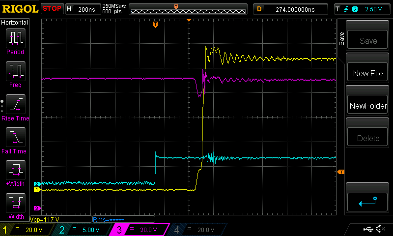

103.5V input, 1800W output into 45V
Without a 0.5nF/10 Ohm snubber from switch node to DC + input
and without it.
Yellow is switch node voltage
Purple is DC input
Light Blue is pwm control into the TLP250
First we see no snubber and HY5110-as-didodes
not too bad at all.

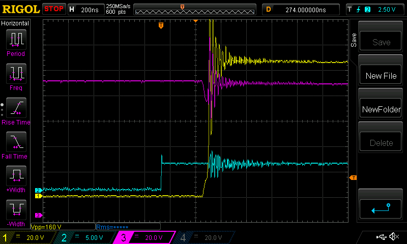

Now with the RC snubber
I retained the snubber and installed the
Now that is unexpected. I thought it would be a smaller spike, and not
very long lived oscillation. This is not very good.

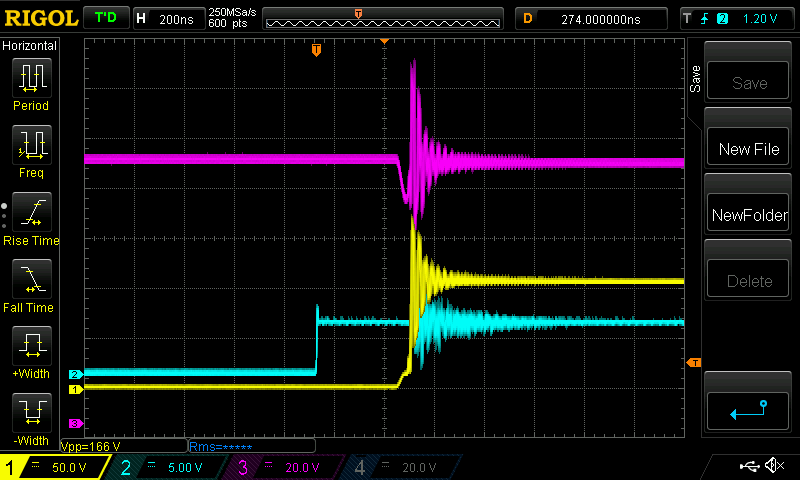

Last is the Yellow trace re-scaled to 50V/div
And it combines many traces so we can see the sort of average behavior
of this thing.
peak voltage exceeds 170V.
Having the HY5110 in place seems to tame this wild voltage oscillation
but probably at the cost of over volting the HY5110 body diode, which goes short circuit for voltages over 118V
I am thinking I will stick with the HY5110-as-diodes and of course use
the nice FDH055N15A MOSFETS for the switching job.

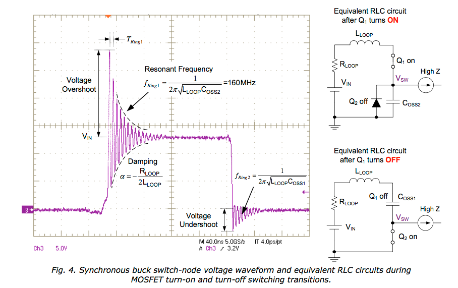

here are two pdfs I find most educational on ringing.
H2PToday1803_design_TexasInstruments_Part 3.pdf
and a practical worked example
AN045_EN.pdf
here are the gory details:
Coss2 is the diode capacitance. I suspect the HY5110 has a lot more
and so when in circuit the ring frequency is a lot lower.
But maybe the Q factor is lower so it does not ring so much.

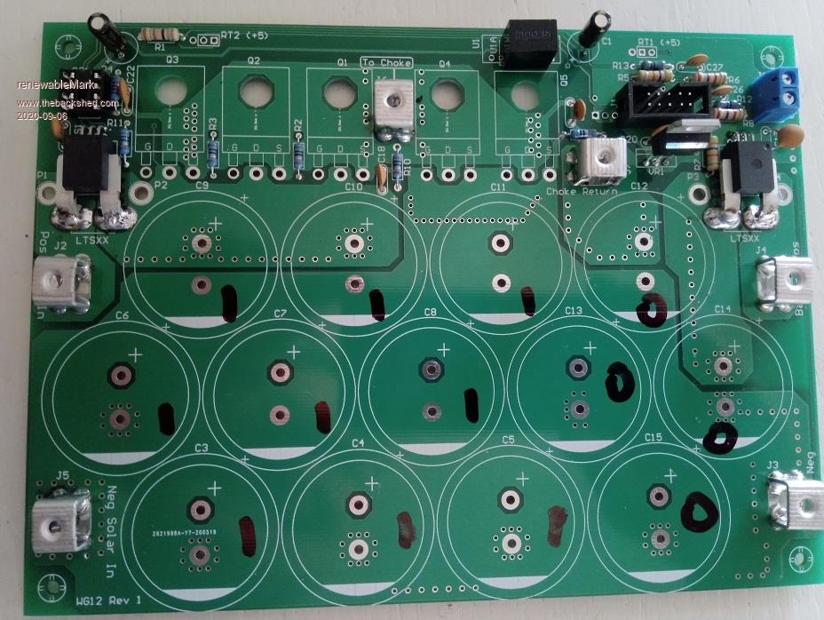

Peter, on P10 you said to use 9x 450uf on the input and 5 x 450 uf on the output.
But these boards have 4 on the output.
If I use the 470 uf I have it will be 1880uf compared to 2250 that you had.
Will that do?
Cheers Caveman Mark
Off grid eastern Melb
poida
Joined: 02/02/2017
Posts: 1507
Posted: 07:43am 06 Sep 2020
Mark:
not to worry. This project will work with just about any reasonable
collection of caps. No need to be exact.
I would fit 4 caps to the output.
The first board I built ended up donating all it's caps to the Wiseguy board build.
And so I thought, what could I get away with if I took an attitude of
"let's be stupid" when fitting caps?
