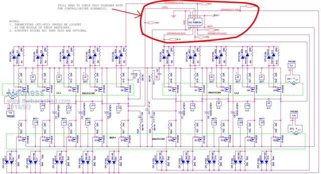

Odd, not so on my version. There is no way 50V from the drain leg (pos rail) can show at the gate terminal unless the mosfet is faulty or the snubber cap is shorted.
But then, I do not have a schematic for your board, about time one of you traces it out for the benefit of all newbie builders.

Posted: 10:46am 03 May 2018
checkout " A newbie ozinverter build" by tinyt
on page one tinyt has produced a very good schematic pdf file of
both the power board and the control board .
As Revlac has said the gate source paralleled bleed resistors
my power board gate source has a effective bleed resistance of approx 3k3 ohms
cheers john

Posted: 01:25pm 03 May 2018
cheers john
Thanks for pointing that out John, I must have missed the original posting.
Now I can see what you guys are talking about
That schematic version mad posted is a bit confusing with all these gate diodes, I think one Schottky diode is plenty here .
tinyt
Joined: 12/11/2017
Posts: 564
Posted: 03:20pm 03 May 2018
  Tinker said  .......
You are right to use the schottky 1N5817 instead of the signal diode 1N4148. Even though the schottky has a higher leakage current and slightly higher Trr, I think it is better for this application because of the lower forward voltage drop at higher forward current. The 1N4148 is a flow down from the EGS002 schematic and I just kept it.

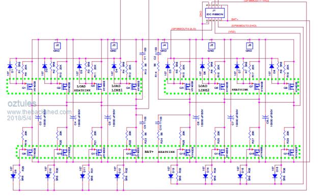

oztules
Joined: 26/07/2007
Posts: 1686
Posted: 09:05pm 03 May 2018
Doubt the forward voltage is important, as the HY4008 turns off below 2-4v, so the extra .5v is not material.
I would keep the 4148 and throw away the schottky. 4148 is 250% faster, so any hysteresis in the system will come down faster.... ie we are closer to real time.
Forward current pulse is 2000ma for the 4148, repetitive is 500ma.... and we are only getting rid of 31nC of charge... in parallel with a 5r6 resistor.... and we only need to get it below 2-4v for full turn off.
The EGS002 folks think the 4148 is fine.. and I think so too.
I like this one, but can't seem to see the 4uf bypass cap for the bulk caps
That cap is important.
.......oztules

tinyt
Joined: 12/11/2017
Posts: 564
Posted: 09:49pm 03 May 2018
  oztules said   Doubt the forward voltage is important, as the HY4008 turns off below 2-4v, so the extra .5v is not material.
.......oztules
I think this is my latest circuit trace of that design. This now has that missing capacitor.
2018-05-04_074827_Oztules_Control_PCB_and_Power_Board_Schematics.pdf

oztules
Joined: 26/07/2007
Posts: 1686
Posted: 12:39am 04 May 2018
Nice work there Tinyt....
I will steal this for my files... ... even if I think better with the circuit board view.
........oztules
