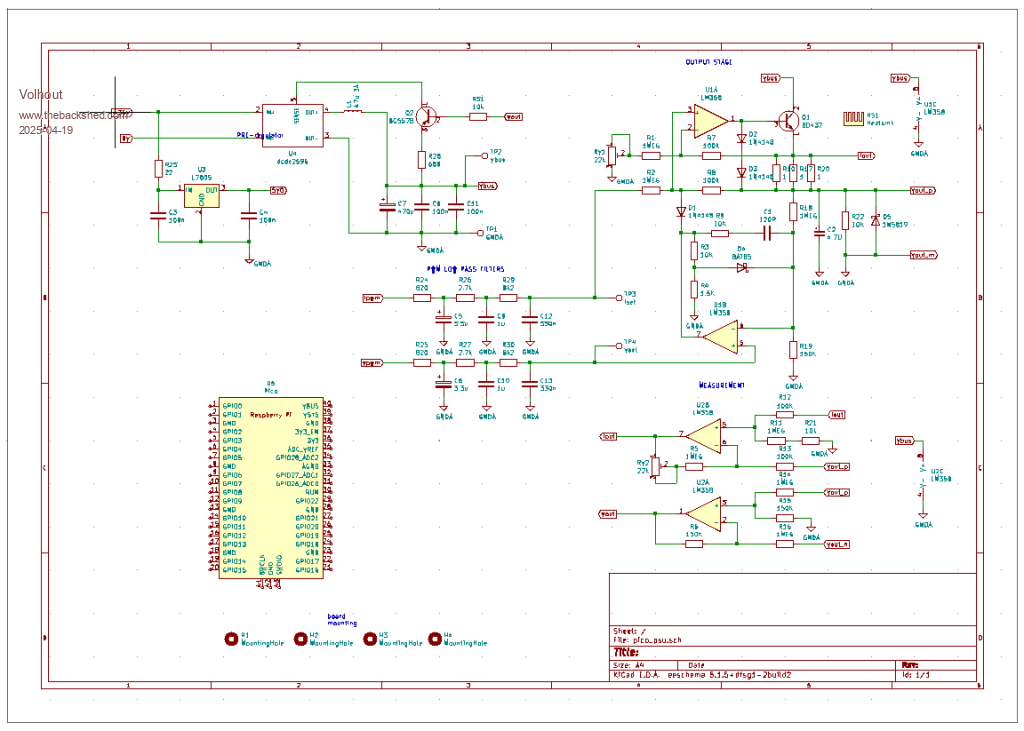

This is what I work towards, use it to your benefit, or not. The 22k optmeters are needed to compensate for the 1% tolerance of the 1 meg resistors. Adjustment procedure I can share when desired, but it can be done with only a DVM (voltmeter).
The circuit is prototyped, and works. It only needs the layout to be finished.
An LCD, a rotary encode, 2 buttons, and a 36V PSU (or 24V transformer, bridge and elcap). The 7805 will be stuffed with a switcher.
Edited 2025-04-19 21:41 by Volhout
