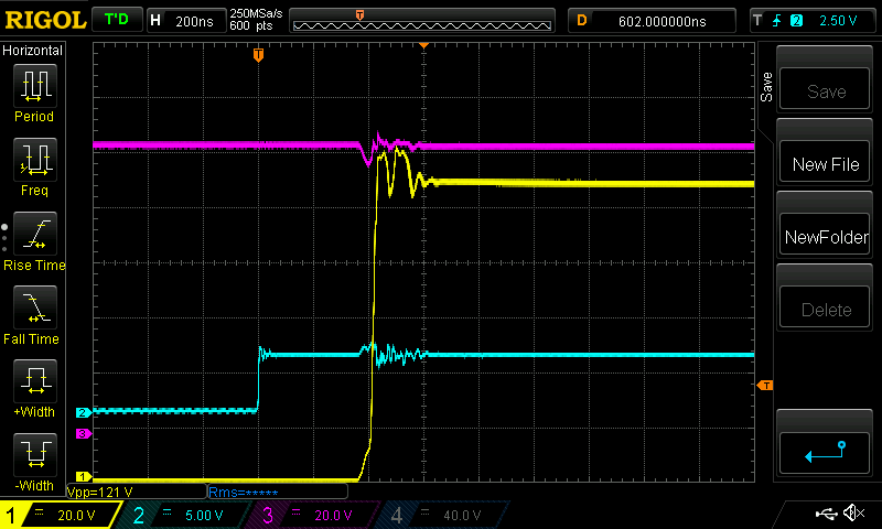

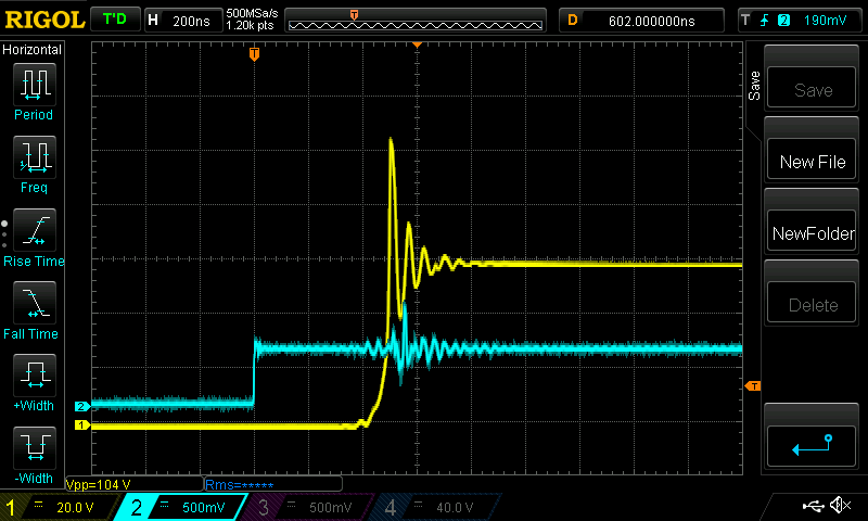

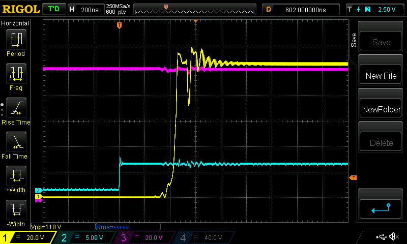

Just tying up one loose end here.
I have both Nicks power boards and one of Wiseguy's power boards.
I was wondering how they compare in one aspect only, which is
the high current inductive loop of the switch and DC supply caps.
Wiseguy chose very well some RC snubbers to be built into his board.
These are the 1nF cap and 10R resistors. There is one connecting the switch node to ground and one connecting to DC supply.
The switch node oscillates quite strongly when switched ON, sending current through
the inductor. The RC snubbers are used to reduce this oscillation.
I have seen the amplitude of oscillation to be a large fraction of the DC supply voltage, e.g. with 110V supply, there are peaks in the oscillation that will be 150V or even more.
Here is what it looks like with no snubbers, using Nick's board.
This is with 57V input and 38A output and 1470W load.
Both boards use the same MOSFETS and HY5110 as diodes.

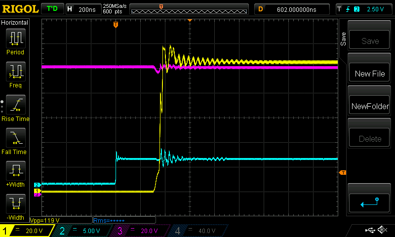

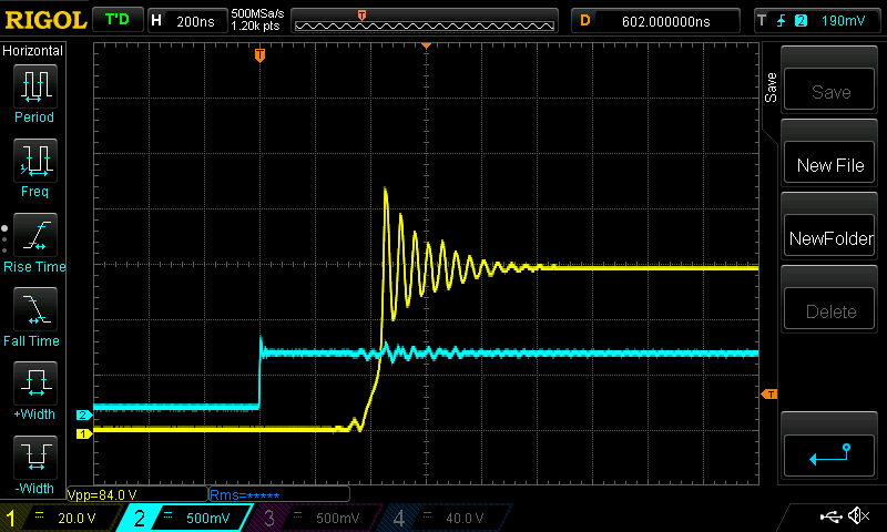

Now this is a very textbook example of damped oscillation. The frequency of this is about 18 Mhz.

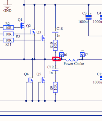

Here it is with a 1nF and 10R RC snubber connecting the switch output to ground and another snubber connecting it to DC supply.
much less oscillation. great. I could not detect any increased DC supply current when the snubbers were fitted.

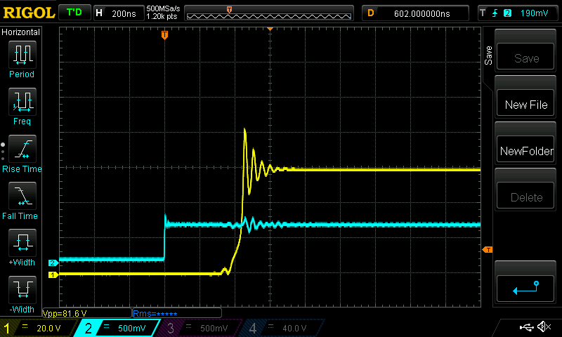

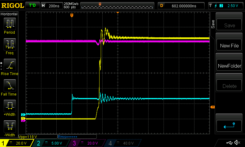

Now, when I built Wiseguy's board, I put in place the two 1nF/10R snubbers.
I can not show this board without them so here it is with them.
Same DC input and load

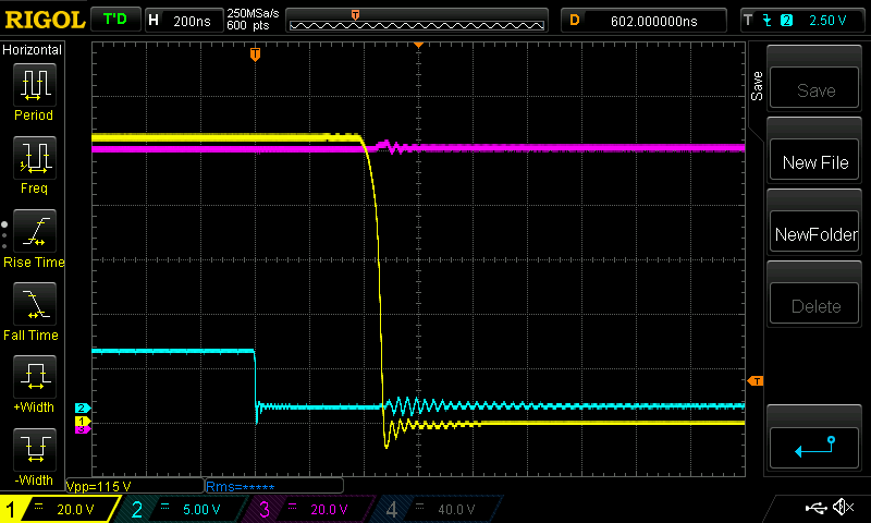

I was wondering how the HY5110 MOSFETs used as diodes would go with these
sometimes 150V peaks they see. I have tested the avalanche breakdown voltage of these
parts and they start to conduct strongly at about 117V and above.
I think during these peak voltages of the oscillation the HY5110 conduct the switch output to ground...that is short the DC input, through the MOSFETS, through the HY5110 then to ground. Not good for efficiency for a start and probably not good for
longevity either.

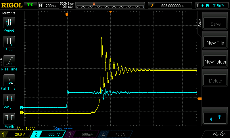

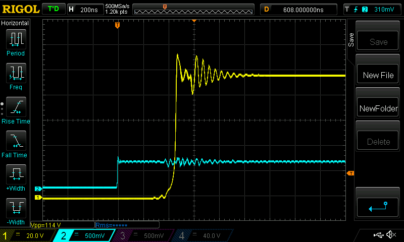

so here is a series showing the switch node as I increase DC supply, gradually
ensuring the HY5110 have higher and higher voltages to withstand.
57V input, 1730W, 39A ouput
85V input
94V input

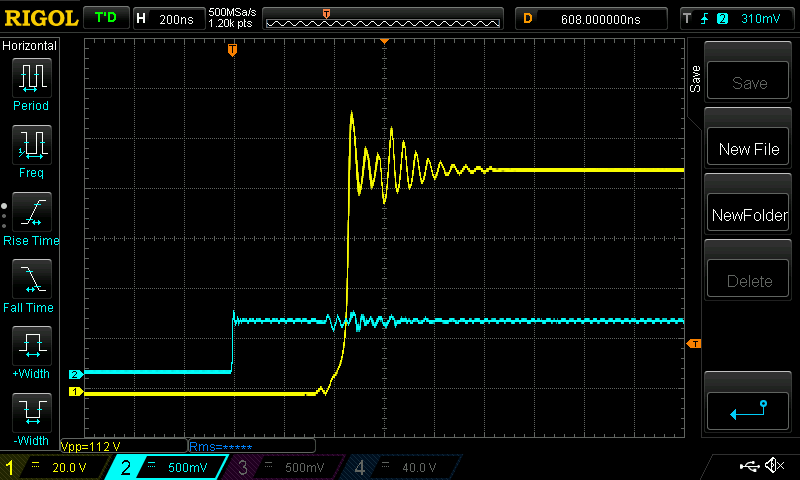

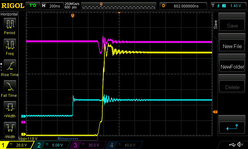

clearly the high peaks are clipped and the action of clipping makes for a diode
reverse recovery sort of behaviour.

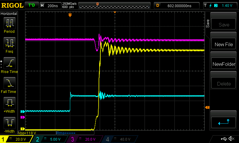

105.5V input

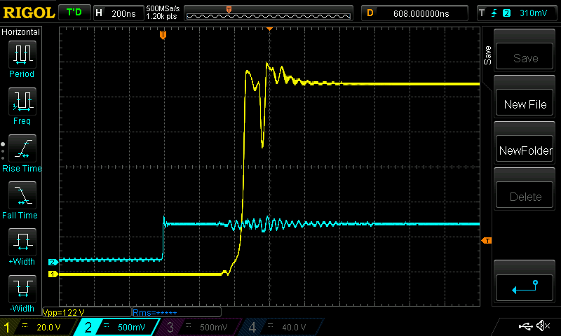

I think we need higher voltage diodes.
The HY5110 are clearly exposed to too high voltages for short periods of time
and so they go into avalanche mode (i.e. short circuit) and take a little time to come out of it. They permit about 115V to pass through them reverse biased but no more.
The mppt works well, that is for sure. But I don't want to see us build boards that
"worked well enough for Poida but mine seem to blow up too often"
What to do...
Get some TO-247 package switch mode supply diodes with more than 150V and 30A rating.
I assume there will be 2 diodes in each package so there will be 4 diodes conducting 45A. That is about right to my mind. And not use the HY5110 MOSFETs as diodes.
Maybe the MBR120150WT (60A, 150V) would be a good start point.
STPS60SM200CW are 200V 60A, and $5 each. This sort of thing.

Peter, what is the blue trace - is it the drive to the opto? Is the yellow trace on the Drain of the two upper switching mosfets ?
This looks very reminiscent of my post "what is the ferrite bead for". The oscillations I was looking at were ~21MHz. A ferrite bead on the drains stopped it in its tracks.  I know you got some results that implied the source was the best place for them, but I cant agree that the source having extra inductance is a good thing.
The first thing I will do if I have these issues will be to place a bead on the drain on each of the upper mosfets. If there is still an issue I will then look at a bead on the gate.
I also concur with your thoughts on using a diode instead of a lower FET. If trying to use a FET for the lower diode I would not be placing any inductance between the gate and the source (no bead on the source) I would want the gate either tied to the source as tightly as possible or even better have it biased with reverse bias.
You will have more chance to try the bead reposition before me - I hope you get the results I expect. (and that you would hope for)

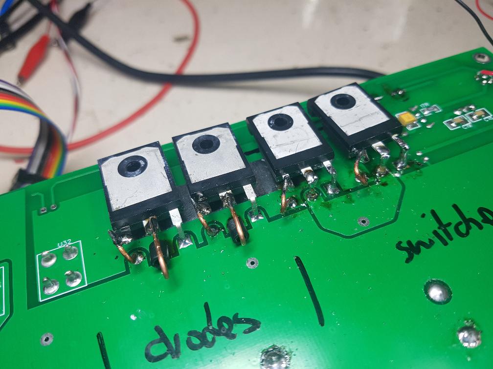

OK so there is one bead for the connection on the board (close to c17), and also for the fets.
What beads are being used?
Or shall I wait for your further tests?
The only ones I have are this type
Edited 2020-08-22 09:19 by renewableMark

  wiseguy said  Peter, what is the blue trace - is it the drive to the opto? Is the yellow trace on the Drain of the two upper switching mosfets ?
yes, Blue is drive to Opto.
Yellow is as shown below.
I call that location the switch node. Nearly any other location
is either DC input or DC output or ground.
As soon as I get the wood heater powered up I will do this.
5 deg C outside and rain.
I do recall the beads on the Drain tests you did. Time to see how they go on the powerboards.

  nickskethisniks said
Poida
So it seems the peak is less with my boards?
Are the gate drive (resistors and caps) and the buffer capacitors the same? It would be nice to see if you monitor the "bus" voltage (on the drain). I suppose the yellow trace is the measured GND-Source?
I believe both boards are using very similar buffer caps, the same 10R gate drive
resistors, the same opto drive IC.

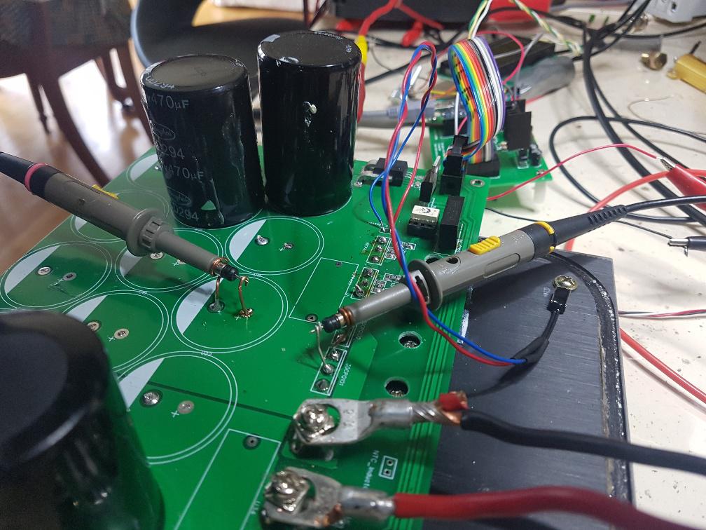

The yellow trace is the switch node (output to the inductor if you like)
with ground connected to the ground plane taken off a pin of one of the diodes.
I think the DC Bus voltage will be quite stable and all I will see with
my inferior probe technique will be EMI on top of the bus voltage.

First, this is the test power board. I don't want to keep hacking at the one and only Mike's board or the good Nicks board which I plan to replace the $1,000 Morningstar mppt with.
It also is a test bed for wrong capacitor choices. Only 4 x 470uf on the input and
one 10,000uF on the output. I wanted to see if my firmware would be upset by this.
(tests have shown there is no problems)
here is the board with the two test points (the switch node and the DC bus voltage)
and here are the results of various experiments and MOSFET change overs.
pretty ugly eh?
Yellow is switch node, Purple is DC bus voltage, Light Blue is opto drive input.
105V input, 1500W out,40V
Here are no ferrite beads on any pins.
this is so much better. I ask myself "why did I use beads anyway?..dickhead"
No nasty dip in the switch node voltage as the diode conducts due to over voltage
for the device.
Here it is with the 1nF/10R snubbers
Less of that high frequency ripple, which was not a problem to me anyway.
The 1/4W 10R resistor gets far too hot, I would use a 1W in this case.
Wiseguy, thanks for pushing me in certain directions.
I doubt I would get there by myself.
No more high voltage oscillation, no more shoot through. No more
likely damaging high voltage & high current spikes commuted by the diodes.
Here is Wiseguy's board with the beads removed. I built it with 2 MOSFETS and
2 HY5110 as diodes.
The switch ON event..
No evidence of shoot through, no significant oscillation.
Just really nice.
And the switch OFF event.
Just about as perfect as you could get.
So again I find myself chasing phantoms. In this case I chose to use
ferrite beads on certain pins. And saw the results and thought something
is wrong. And did not think it was the beads that were the problem.
But experiment after experiment lead me to a better place.
Eventually.

And for Nicks, here is his board, tested under identical conditions.
Same input voltage, inductor, but a bit more output power, 1800W.
First with the beads.
Which cause problems. one being the deep dip in the switch node voltage
just before the center line. This is due to the diodes having their
reverse bias voltage exceeded and so they conduct. Not good at all.
Now with the beads removed.
Much nicer.
And with the two snubbers.
and finally the switch OFF event, with snubbers.
This is the same as without snubbers.
I think I am operating at the maximum voltage for the HY5110 body diodes.
Even backing off 10 volts will be enough to prevent any issues of over volting
the diodes.
The 1/4W 10R resisitor gets so hot it discolours in 2 minutes.
I suppose some effort in choosing RC snubber values might be worthwhile.
These tests show Nicks' boards work well too.
