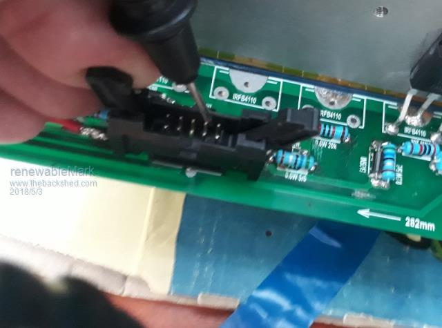

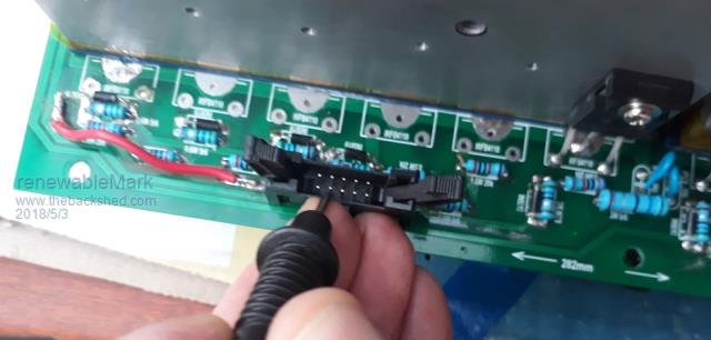

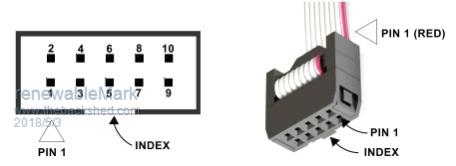

I think I have found a problem.
What I did is power the power board only by feeding the dc neg cables and pos heatsink with 50v.
Pins 3 and 8 both show 50v, from what I can see those pins go direct to the 2110 chips, correct?
Is that normal?
Cheers Caveman Mark
Off grid eastern Melb
Posted: 09:22am 03 May 2018
Mark, it is too bad nobody ever bothered to draw a schematic of those ozinverter board(s). With that people who do not have these boards (like myself) could give you better clues where to check.
The first thing I did before laying out my PCB is drawing the schematic - its not rocket science and there are free programs to do it on the net.
Now, assuming you *only* connected the battery to the power board you should see 50V at two of the mosfet drains and ground at the source of the two others.
I can't imagine why you measure that at the 10pin skt when nothing is plugged in there.
From what I wrote above, check how that 50V could get to the 10 pin skt by tracing back the PCB tracks.

Posted: 09:29am 03 May 2018
Gate to Source resistor.
Cheers Aaron
Off The Grid

Posted: 09:34am 03 May 2018
  Tinker said   M
I kept blowing 2110's and looked at where that could be coming from.
Cheers Caveman Mark
renewableMark
Joined: 09/12/2017
Posts: 1679
Posted: 10:00am 03 May 2018
  Revlac said   Gate to Source resistor.
Measuring in circuit all resistors look fine, do you need to desolder one end to check?
Cheers Caveman Mark
Posted: 10:07am 03 May 2018
Mark, I would suspect *all* the parts around the mosfets that blew. Yes, you need to unsolder one leg to test the resistors/diode.

Revlac
Joined: 31/12/2016
Posts: 1310
Posted: 10:15am 03 May 2018
No, the Gate to Source resistor bleeds voltage through from pos rail to those pins 3 & 8 through the gate resistor.
Just powered op my board with resistors in and no fets plugged in yet, same thing.
Normal.
Hope I wasn't looking at that upside down. Edited by Revlac 2018-05-04
