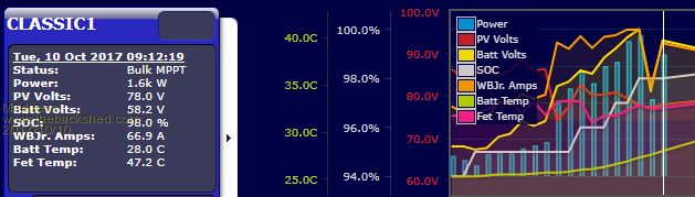

Posted: 11:30pm 09 Oct 2017
Hi Yahoo,
Initial startup seems to fine, the Zeversolar and the Aero-sharps take a few minutes to do their checks and then seem to ramp up by themselves. With my setup the GTI is on all day once it kicks off in the morning. This is why I set a minimum lower limit to the PWM percentage.
When it failed AC power was lost so the network also dropped out, here it shows the last bar on the chart with power at about 2/3 of maximum. This updates every 6 minutes so who knows where output went to after the failure. There was some cloud cover just before it stopped, prior to this it would have been very close to starting to reduce output looking at the voltage.
Tomorrow it will get up and running again, I found some more old FETs to salvage. I have modified the code to limit it to 50% PWM. So will see if it is happy at the lower level. Need to wait for new FETs to arrive to get the big inverter operational again. Small one does not seem to be compatible with near 3KW from the GTI.
