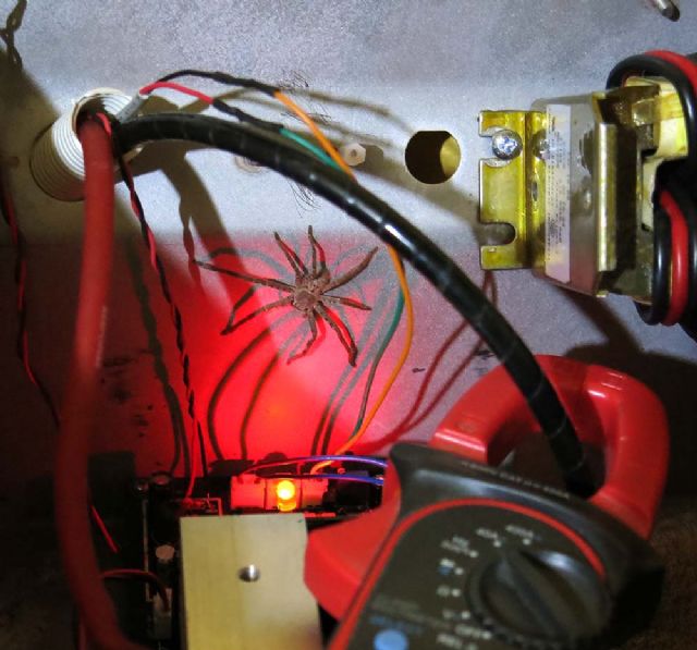

Someone seems to like getting close to action. Are Huntstmans conductive?

Might be your Gremlin :) Put your meter on him. Gekos can cause big problems here with electronics.

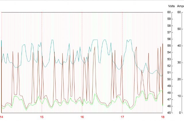

I have always been thinking how large the DC current peaks are when driving my loads at home.
Now I know.
The peak value is obtained from current sensor samples over 2 minutes,
the other current value is the average of all measurements
taken during that 2 minutes. I expect measurement error to be less than 0.5A
This data is from 2pm to 6pm last night.
Green is average current. Brown is peak current.
Blue is battery voltage
My home load includes 3 fridges and a few computers, two laser printers, 55" LED TV ...
The startup of a fridge motor is clearly a significant event.
I join the values of peak current together but it's a mistake to think this is
the continuous value of the current. I just look at the peak values.
These occur prior to an increase in the average current, as expected - the motor starts, then runs for a little while.
It seems to me a fridge needs about 30A to start then runs on as little as 2A
