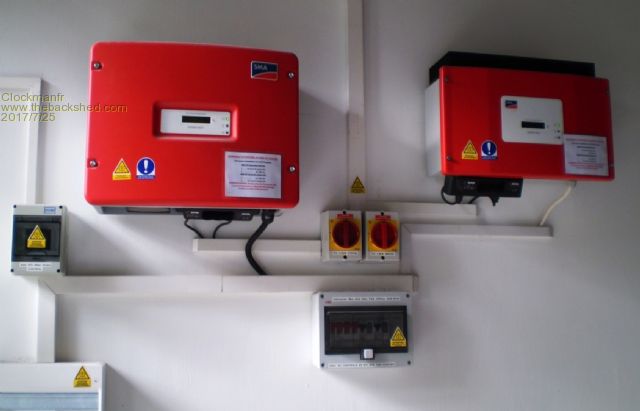

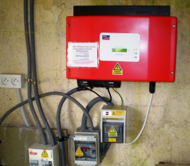

Clockmanfr
Joined: 23/10/2015
Posts: 437
Posted: 09:47pm 24 Jul 2017
Good morning Mulver,
Firstly, ….. the PJ boards AC output approximately follow the DC battery voltage rise.
The 8010 board only follows the DC battery voltage when the the Batteries are full, ie, the back charging has absolutely nowhere to go.
However, on a few murky days, my 3 GTI’s. (soon another 2 ), are all putting there 20% ish, of rated power in to the batteries. The sun comes out briefly, the PJ boards AC rises as it has a back load, tripping out a GTI, but the batteries are wanting that backcharge. The batteries are NOT charged up.! ie, the PJ board AC is too sensitive and up and down like a …...
The 8010 boards in this situation hold steady and allow all that sunshine created power to backcharge into the batteries, until they are full and I mean FULL and over cooking is not good for batteries. That’s if the sun keeps shining.
With the above considerations……
……… AC Load shedding, I use Hugh Piggotts method, http://scoraigwind.co.uk/tristar-follower-to-control-ac-heaters/
that runs from my DC Tristar load diversion controller. Works well for hot water, but over the past 8 years I have seen faults, and things can get mighty hot when you need to be dumping.
……….DC Load shedding, done with my 3 DC wind turbines, using 3off PWM Tristar diversion controllers, problem is, that sometimes these operate and try to dump the GTI’s output.
Conclusion……
I do like what Oztules is trying to achieve on the DC side of the GTI, as I start to realise that my UNIVERSAL BOX OZINVERTER GTI CONTROL for each GTI, is not going to work well on the AC side.
So at present its back to the DC battery state, either a MASTER control, as Oztules has created with charging algorithms, and SLAVES operating from a data cable or down the AC cable (please pretty please!), from the MASTER that shuts off the AC side on other GTI’s on the OzInverter.s Mini Grid.
My philosophy, keep it as simple as possible, ROBUST and solid, and as cost effective as possible.
Pics ... Fortunately I have the internal reset codes for these GTI's, so I have set these to trip out at the optimal 241vac, 242vac and 243vac, for testing the AC switching in real situations.
You can see which of my used/second hand, cheap as chips GTI's gets viewed by the Public.......
Edited by Clockmanfr 2017-07-26
Mulver
Joined: 27/02/2017
Posts: 160
Posted: 12:45am 25 Jul 2017
Hi Clockman! Both pictures look pretty good but the top one takes the prize!
