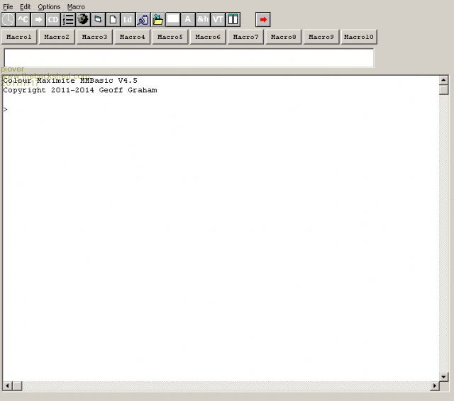

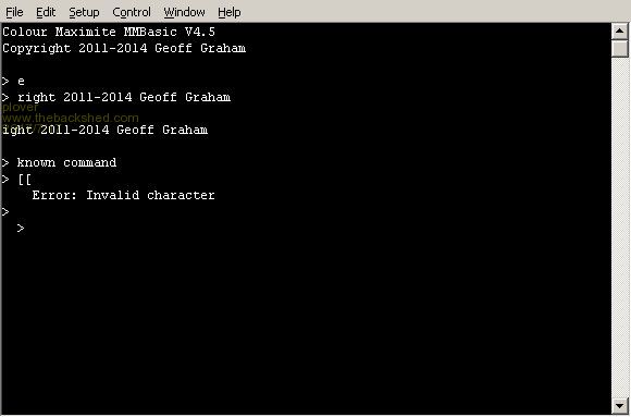

I am getting better at controlling the wine com links and when connected to the Maximite using MME I have now reliably used 'MM Files' to look at files on the SD Card and some of those files sent to MME edit window on PC.
If I open 'MM Chat' I now get a Banner, see pic below, this I think indicating that MME is working pretty well with the Maximite, and I know I have got the correct version of Maximite basic syntax set up, banner tells me it is ver 4.5
I can reliable open TT, but the Banner seems to double up or partly, perhaps as it is doing a double connection beyound me at the moment. The basic prompt '>' will show but typing any character is more than hit and miss.
In the pick below there is traces of the banner, I changed speed from 4800 and up, connection is not lost only lots of information gets lost.
I am awarding -.5 points as I think I have tried to change almost anything in the TT that can be changed (exasperation taking over my logic). I also believe the VT terminal in MME does a better job than TT.
I think I am coming to the conclusion that for me running Linux the best connection method will be MME. In a much older thread of mine where I battled initially with setting up in linux (PCLinusOS) and made connection with other terminals I seem to come to the same conclusion.

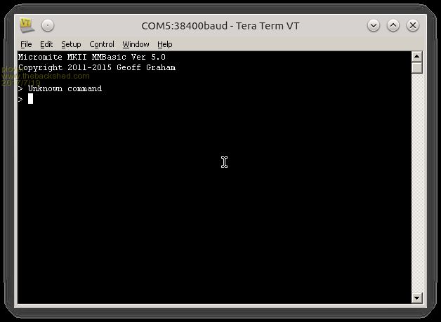

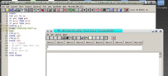

Now I have connected to the Mup-v2 with MME. If I use "MM Chat' I will get following picture.
In MME I have a program from BigMiks manual for the 19 LED test board piggy backed on the Mup-v2. The chat window when opened is empty and I expected a Banner? Am I wrong in my expectations?
The Mup-v2 actually has the program installed, using the 'list' command will print the listing.
I would like to know what version is actually flashed here. I think I have just about gone through all the syntax settings for the Micromite thinking that maybe only when the syntax matches will the banner show (I don't think I believe that either)

The banner only appears when the MM is first powered up.
PRINT MM.VER gives you 5 or 5.0 so you have version 5.0 installed.
If you can remove and reapply power to the MM without removing power from the USB-TTL converter, you will see the sign-on banner.
If the board has a reset button, you will see the sign-on banner.
If you unplug the USB while the Chat window is open, you will probably have problems.
The maximite behaves differently due to the inbuilt USB. It is also not a good idea to unplug or reboot while a program is talking to it.
JimEdited by TassyJim 2017-07-18

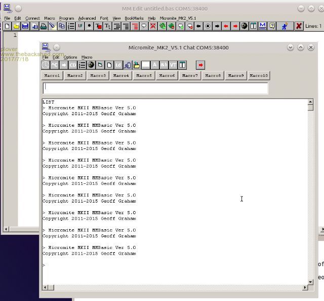

I am not thinking straight, it was first when I read your post that I pursued looking for 'Reset', I did remember that the board had ICSP connector. That should have emphasized in my mind there would be 'RST' or reset pin. Sure enough despite having a piggy back over over the DIP 28 covering pin 1, reset, this can be implemented on the ICSP which is right at the edge of the board.
I do have easy access to the pin 1 on ICSP, via simple mini EZ hook I can short to ground. See the blink on the MuP-TTL converter and Banner flips up. The mouse pointer shows on the snippet:
I have a mess on my desktop, a simple breakout USB board I used on the gas analyser to get access to the USB D+/D- lines, lying very close to the MuP-v2 board. Without me noticing the test lead on the reset pin flipped the bare end under the USB break out board and any little shake when moving the mouse actually produced a reset.
That is the cause of the repeated Banners. Need to tidy up the MuP-v2 either on a heavy base or a box.

Hmmm, Installed Playonlinux, did not work out well, set aside. The idea was it should be simpler to install and run but turned out I could not make head and tail of what happened.
I had downloaded the TT 4.95 hoping it would make a difference. Got it running but same problem can only get COM1 and COM2 and I want to run on COM5 in this exercise. Starting to wonder if I really need to install on a Windows 7 machine to test, that is hurtful
Funny, I started up the TT 4.88 using the forced COM5 mode. Connected to the MuP-v2 I did a reset, got perfect Banner.
Sorry must try and trim the pictures.
First action, reset, gets me the Banner and prompt '>' then I typed 'list' and got the second response.

I did a fresh install of Ubuntu 16.04 on an old netbook
Installed Wine
added the user to the dialup group
logged out and back in to get the new permissions to work.
mapped /dev/ttyUSB0 to com1
/dev/ttyUSB1 to com2
/dev/ttyACM0 to com5
/dev/ttyACM1 to com6
That allows for a few different 'mites plugged in at the same time.
Installed MMEdit by running the install package and selecting the memory fix option.
Tested OK on com1 and com5 to different 'mites
Getting MMEdit to 'search' for com ports is not a good idea and will not give meaningful results.
This is much better results than the last time I tried MMEdit under Wine.

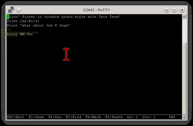

I have shown the Edit mode and the F keys work. Again I am working with my KDE 5 Plasma system and will go back and install Putty on the workhorse.
Now I should start thinking about running programs. The preferred procedure is: Use MME, a real dream, Putty as simple checking tool.Edited by plover 2017-07-20

Tested out Putty, when setting: serial option, comport to ttyUSB0 and speed 38400 and it works.
