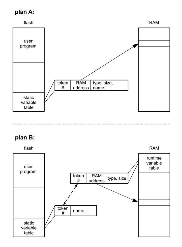

Posted: 06:06pm 06 Jul 2017
further thought has produced a solution that would seem to keep everyone happy and allow 100% compatibility with CLEAR and ERASE. see the below diagram:
"plan A" is what i had originally envisioned, where the entire variable table is contained in flash and constructed upon exiting the editor (or completing 'autosave'). the (static) variable table would contain entries of variable length, but because the length of each entry would be known it could still be searched relatively quickly for a given token. since all variables would be 'static' there would be no need for complex heap management.
the downside is that mmbasic would handle variables in a substantially different fashion, amongst other things no longer allowing re-dimensioning of arrays.
"plan B" involves splitting the variable table into TWO tables, one static (in flash) the other created at runtime in RAM just as the existing variable table currently is.
the static variable table (SVT) would just contain 16-bit token numbers (in sequence starting at, say, 64000) and variable-length variable names. it would exist solely for the purposes of 1. reconstructing the original source code when detokenizing before invoking the editor, and 2. converting tokens back into names for printing out error messages.
one key piece of information derived from the SVT would be used at runtime: the total number of tokens.
upon starting a BASIC program, a runtime variable table (RVT) would be created. the RVT would differ from a conventional BASIC variable table in a couple of key ways: each entry would be of a fixed length, and, the number of entries would be known beforehand (so the RVT would not need to be able to grow/shrink).
there would be no need to search the RVT, instead the base token number (64000) + fixed entry size could be used to index into it - strictly speaking the RVT would not even need to hold the actual token numbers. prior to being first accessed or declared, the RAM address associated with a given token/variable would be nil, and after being CLEARed or ERASEd would be set back to nil.
while the RVT would be of fixed size, heap management would still be required to allocate and recover the RAM used to hold each variable's content.
geoff, peter: does this sound more workable?
rob :-)Edited by robert.rozee 2017-07-08

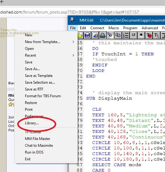

Posted: 10:51pm 06 Jul 2017
  matherp said
If this could be incorporated into something like MMEdit this could be hugely powerful - imagine a drop down list of library routines that you select from and that automatically then get loaded....
It comes close...
Just needs people add routines and keep them updated.
