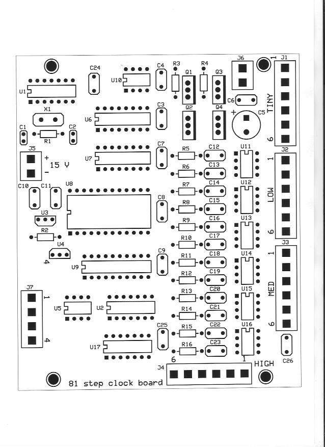

What I have at the moment is one fully functioning 27 step inverter, plus one bare empty spare circuit board.
My 2.9 Kw 81 step inverter is now complete with metalwork, transformers and wiring, but without any circuit boards for it.
I have the artwork file here ready to go, but just have not got around to getting any boards made. There is always something more urgent to spend money on around here.
I am about to pull the trigger on buying a 6Kwh Lithium battery which will wipe me out financially for a while, so no plans to get any of these boards made in the very near future.
If a few people are interested we could share the costs on some boards and do it that way.
Also, I can program anyone's 27C16's with 81 step data if they supply the eproms and return postage, and I will toss in a 3.2768 Mhz crystal for free as I have a hundred of them here I will never use.

May I ask for a schematic what is connected to J1 to J4? I know its the mosfets but I like to study how you did that.
Oh sorry Tinker I almost forgot.
J1 to J4 are the outputs to each of the four inverters.
Pins 1 and 2 provide +/- 15v at 50 Khz continuous square wave power to provide isolated dc voltages for the mosfet gate drivers via small pulse transformers.
I did it that way because I already have a quantity of suitable pulse transformers I wished to use up.
There are different and much better ways to do it, but it suited me to do it that way at the time.
Pins 3 and 5 are drive to the inverter which could be half bridge, full bridge, or push pull topology.
Pin 4 drives the zero volt clamp, it provides the third "off" state for the inverter when it is not being driven "on" in either direction.
The whole thing has been an evolving project, and originally I planned to use push pull inverters with a floating clamp winding. That meant all my mosfets would have had grounded sources, and this clock board could drive the mosfet gates directly.
A much safer way, especially for higher voltage or higher power, is to use the outputs of the ICL7667 mosfet gate driver chips to drive opto isolators, they are perfect for that. and that is how I recommend all the mosfets be driven.
If every mosfet gate has its own fully isolated gate driver, it solves a lot of grounding and noise problems. It also minimises fault escalation if something blows up.
Nothing worse than having +48 volts find its way back to the +5v rail through a chain of exploded chips. If the power stage is isolated by optos or pulse transformers, any destruction stays pretty well localised.
I tried to post the schematic of my power board, but the server comes up with an error.
Will try again later.Edited by Warpspeed 2017-03-20

Tony, you answered my questioned regarding the 7667s before I asked it
Posted: 02:24pm 19 Mar 2017
Those 7667's are really good to use, the input logic threshold is 1.5v not 2.5v as is usual for most 5v cmos logic chips. That enables us to use a simple RC integrator to generate dead time without needing a diode. The output switches very fast rail to rail and has a ton of drive capability. They do however invert the signal, so data in the eprom has to be the compliment (inverted) to what we eventually require.
Output at the J1 to J4 connectors is the more useful logic hi = mosfet on.
mackoffgrid
Joined: 13/03/2017
Posts: 460
Posted: 02:54pm 19 Mar 2017
That is cool, I've used them in my solar regulator. I did wonder why you didn't have diodes there.
Did you do any cross conduction protection on the FET board?
Posted: 04:33pm 19 Mar 2017
Those 7667 chips also have a Schmidt trigger input for jitter free dead time.
Cross conduction is only likely to be a problem during power up and power down, when the various power rails are slowly changing in an unpredictable manner. Undervoltage chip U4 holds the main counter in reset at 4.2 volts and under. Do not leave this feature out !!!
If doing all this inside a microcontroller, power up and initialisation of the port should be pretty straightforward. But powering down may have some hidden problems.
Careful thought needs to be given to what happens if you reset the microcontroller with the software running. It should be o/k but it is something to think about.
I found a sneaky way to add cross conduction protection to the opto isolators on the FET board.
Will try again to post the circuit.
I think the Forum server needs its nappy changed.
Edited by Warpspeed 2017-03-21

Now one of the three (four) power boards.
Notice that the opto isolators are connected in inverse parallel between the +ve and -ve drivers. It is impossible for both to turn on together. The NAND gate U2 on the clock board pretty much guarantees that the clamp cannot operate if either +ve or -ve driver is active. Its the last line of defence for a spurious cross conduction accident if the eprom data corrupts.
Here is the 81 step schematic again, it might come out a bit higher resolution.
