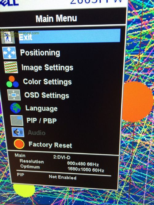

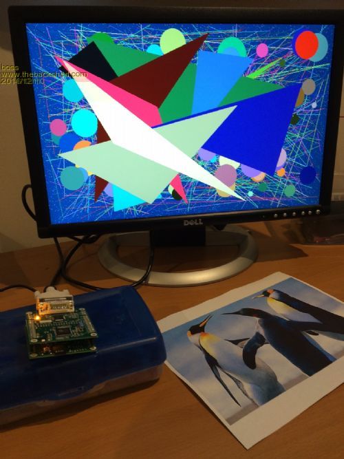

@WW,matherp
do you remember this SSD1963 to DVI shield I presented couple of years ago?
Use SSD1963 chip in 8bit mode and support 640x480 and 800x480 mode.

Posted: 12:06pm 10 Dec 2016
@WW
Some time ago I got request to replace couple of obsolete DEC REGIS devices. Unfortunately in these days I had only relatively "slow" 28pin uMite. The device resolution was requested 800x480 @16bpp with DVI output working with standard industrial DVI monitor.
I start searching on Web and found a PARALLAX enthusiasts working on very similar project. We join our knowledge and developed this shield.
I have full right to manufacture and even modify the shield if necessary.
The device with uMite and shield itself is working very well with requested resolution for more than one year in the heavy industrial environment.
I have full documentation and still have few pcs of DVI shield available for tests.
The 32MZ chip and the the shield could be good solution.
Bo
