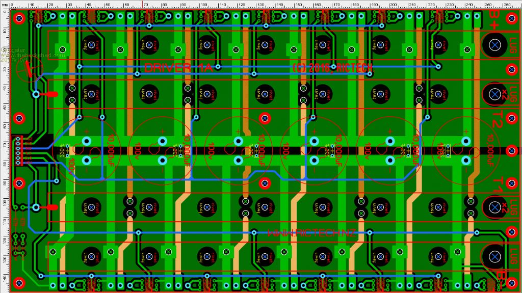

I have just got my build running See here it is on 2 OZ PCB I etched myself, had it running for some time today at 2400W and everything is 2-3 degrees above ambient temperature with no cooling. this is the design I am using now. I made it to fit on 250 X 150 PCB blanks I already have.

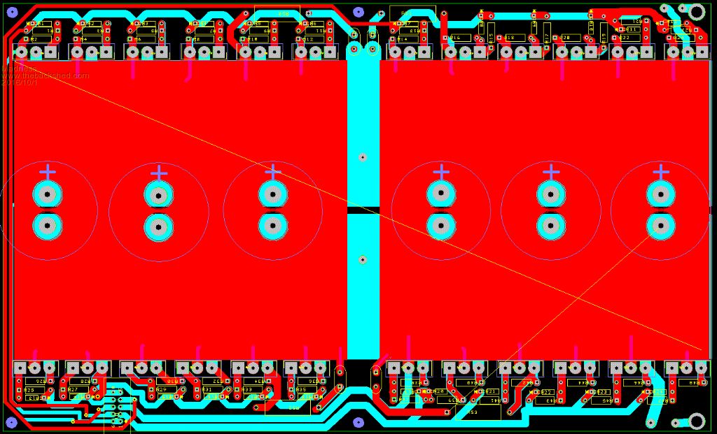

My altered one:
Back to two big ground-planes(one positive, one negative).
This version only has 16 links to make with 3mm copper rod, instead of about 30 or so with the image on the previous page.
I am seriously considering 2-ounce now, and perhaps another layout reshuffle.

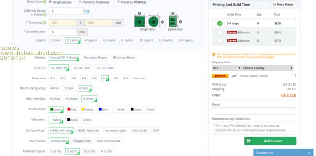

the mob I use allows 5 boards of larger size 2oz for a full size 15kw powerjack/clockman size... 300x200 $110usd gets it for 5, plus shipping. Note: Don't use DHL if in remote area, they add $30 extra.... use EMS... faster and same price more or less without the $30 excess... 5 boards this size and thickness are quite heavy.
You will use probably 2-3 for you, and have a few spares.

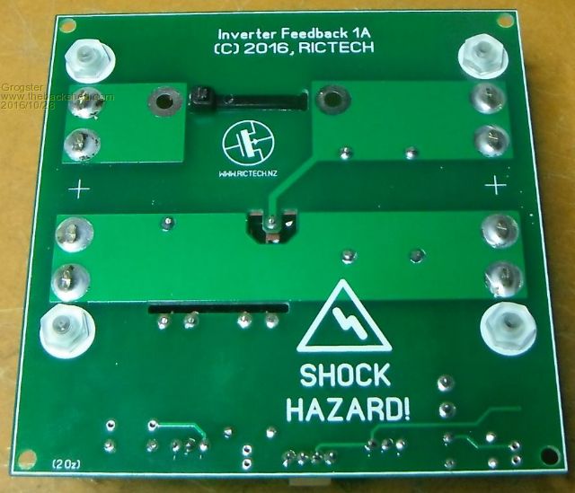

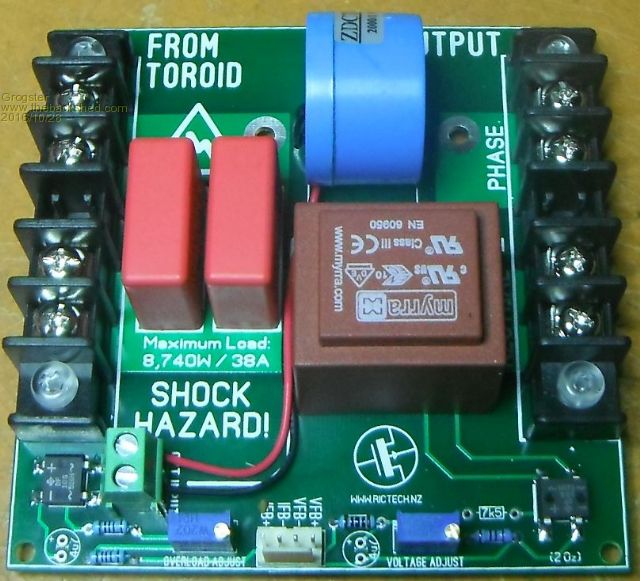

However, I was able to find about 30 seconds tonight to assemble the feedback board:
This board is designed to be capable of well over 8kW if ever needed. In my intended setup, this won't be required, but it allows me to upgrade later and keep the feedback board the same for pretty much any size inverter I ever plan to make.
Note that in these photos, I have not fitted the 7k5 resistors for the voltage feeback as I don't have any of that particular value, and also the thick wire for the phase through the C/T is not installed - perhaps tomorrow.

The 7k5 is not terribly critical, and in fact is what I used as my excess/spare transformers were around the 14v mark... if yours are 12v, then the value may need to be changed to get the small AC range where you want it. With the components I used, the pot range was about 30vac for full 270 degrees... ie 220-250vac.
..........oztules
Posts: 10084
Posted: 12:26am 28 Oct 2016
The transformer is 2x 12v windings, but only about 1.1VA(90mA), but I expect that to be fine, as we are only wanting a reference voltage and not really any current to speak of.
I have left off the caps - did you or everyone else ever decide if those caps were to stay or go in the end?
oztules
Joined: 26/07/2007
Posts: 1686
Posted: 12:51am 28 Oct 2016
Yes it uses virtually no current... it is the range that I was referring to... you may have to change the 7k5 anyway with 12v transformer.
Caps are required to stop spurious operation.
........oztules
