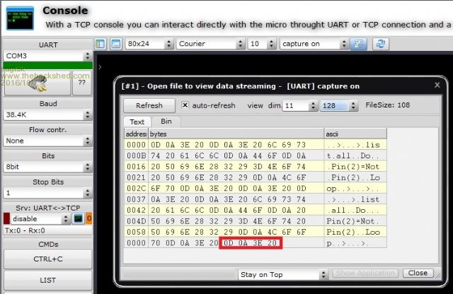

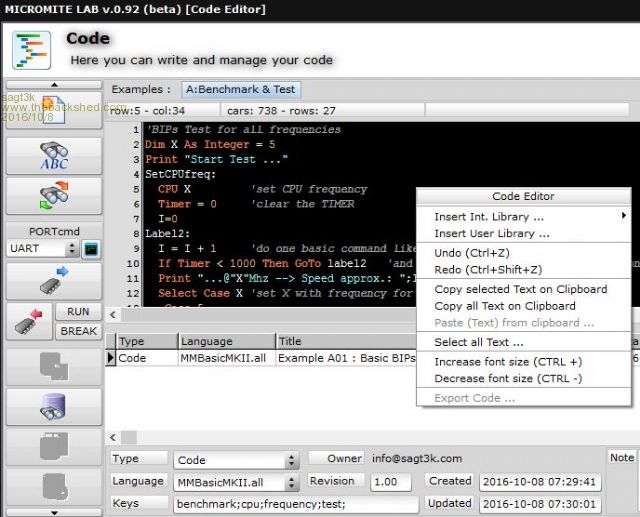

Matherp... anyway, In form console there is a combobox "capture/log off". If you choose "capture on" and after goto in BIN sheet and check "auto-refresh" we can see what happen.
Posts: 12185
Posted: 12:11am 07 Oct 2016
  Quote   check "auto-refresh" we can see what happen
I can't find an auto-refresh checkbox - which page is it on?

I confirm that to send/receive the code, first send 0x03 and later 0x0D 0x0A, and wait after 0x0D 0x0A 0x3E 0x20 as in image ...

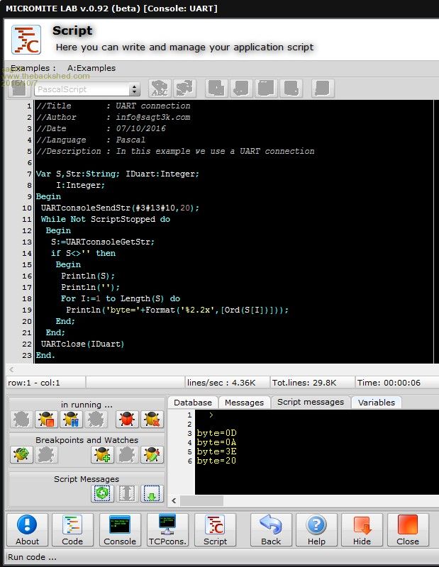

... or we can do this test. Just get connected CONSOLE (with green light) and try this script...
...Go on SCRIPT to create a new one
, choose PascalScript and
...write the code ...and start the code
after goto to the SHEET script messages ...
Here the code .. and the image of SCRIPT module ...
Var S,Str:String; IDuart:Integer;
I:Integer;
Begin
UARTconsoleSendStr(#3#13#10,20);
While Not ScriptStopped do
Begin
S:=UARTconsoleGetStr;
if S<>'' then
Begin
Println(S);
Println('');
For I:=1 to Length(S) do
Println('byte='+Format('%2.2x',[Ord(S)]));
End;
End;
UARTclose(IDuart)
End.

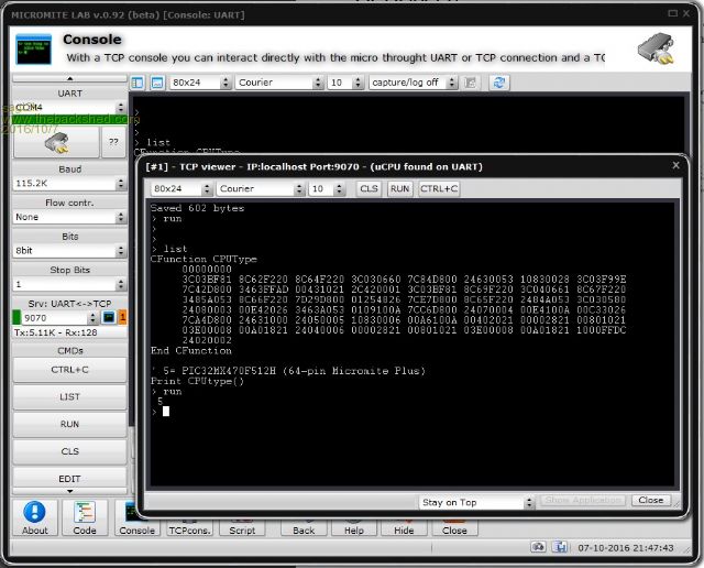

I have fired up my 100pinner with the CP2102 converter and it all works happily.
@Peter, The Silicon Lab driver I am using is version 6.7.3.350, 28/03/2016
I did the tests on the 100pinner without any peripherals connected.

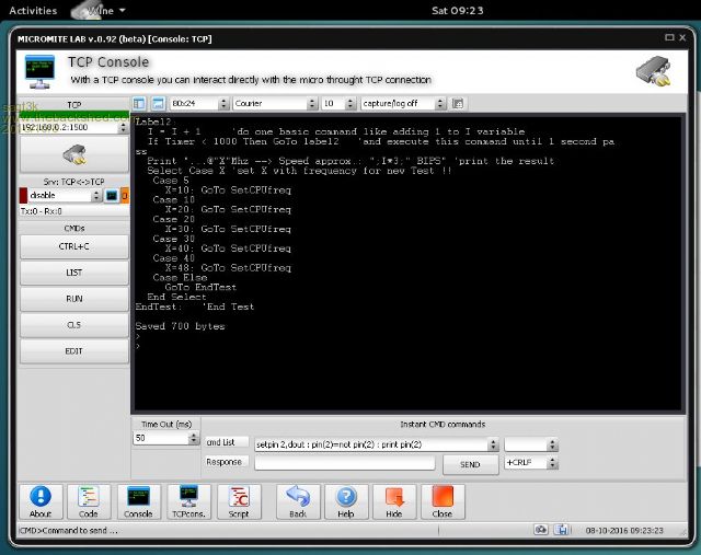

MicromiteLab is fully compatible with Linux/Debian through WINE.
For now in TCP / client, I just have to solve the problem of convert and read the regedit/wine and communicate properly with /dev/ttyUSBx in COMx.

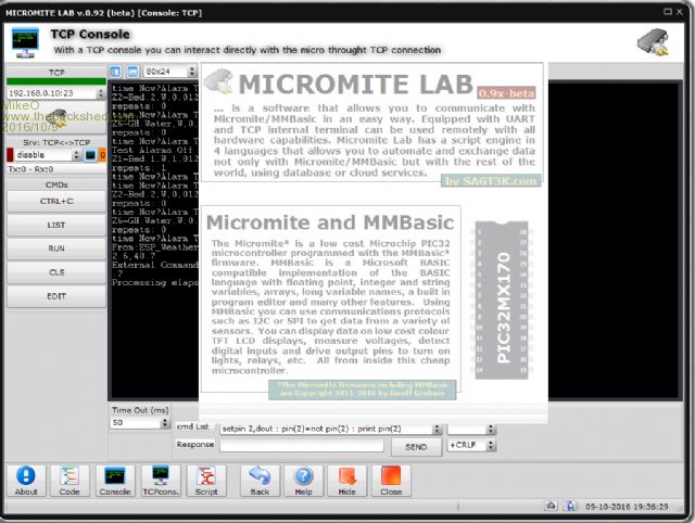

I had this "bad behavior" experience when starting up. This information page didn't close and remained as the top of the application, in fact on top of any application I opened even the browser and the backshed page I started to write this report. I could not close the Microlab application normally i had to use the task manager.
I am using Windows 10.

In order to help me to understand, who have problems to up/download code, could You follow these actions? And let me know?
  sagt3k said   ... or we can do this test. Just get connected CONSOLE (with green light) and try this script...
I:Integer;
Begin
Begin
if S<>'' then
Begin
Println(S);
Println('');
End;
End;
UARTclose(IDuart)
End.

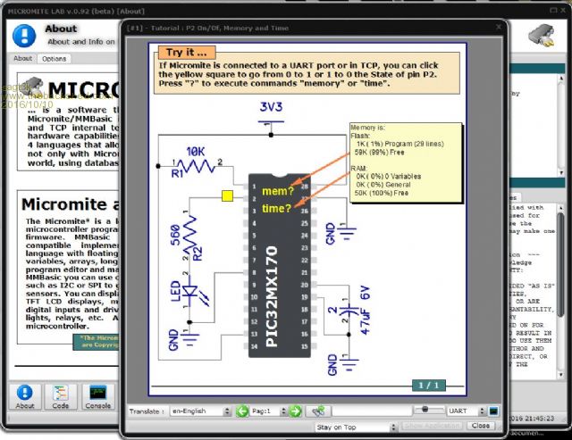

To continue with the MicromiteLab's features you can follow interactive tutorial. Through the interface You can interact directly with the hardware.
Here you can download a little tutorial MicromiteLab Tutorial 0001

first: your nice gadged from the tutorial with "Mem" and "Time"Report works fine
