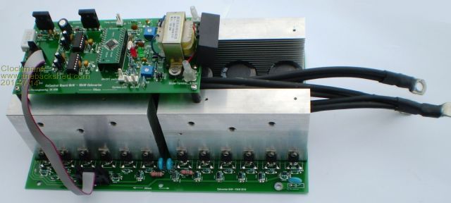

Posted: 11:39pm 13 Jul 2016
Its a dynamic project. And others have gone off in slightly different directions. Getting everything together and sourcing is always problematic at the very beginning.
Here's my latest, Mid July 2016, published lists.
2016-07-14_093005_PCBOzContrlBrd10aList.pdf
2016-07-14_093204_PCBPowerBrdList2.pdf
Trust this helps.

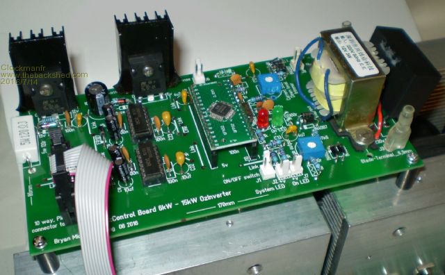

Posted: 11:51pm 13 Jul 2016
e cores if you are not going to scavenge them.
there is a led next to the 12mhz crystal on the control board
there will be a separate parts list if you build a fan controller
the 4410 TO-220 is a buy in bulk and check/grade them for the inverter.
I think you are still short some of the other items on the power board
photo:Clockmanfr

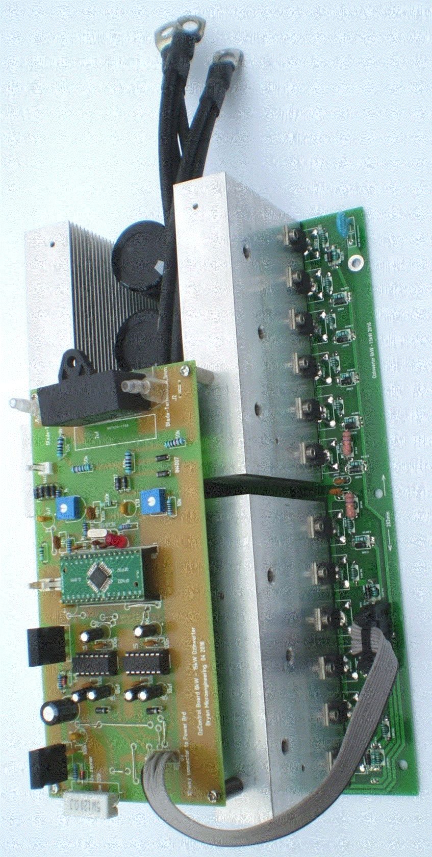

Posted: 12:04am 14 Jul 2016
Yahoo2, that is the Overtemp On/Off model.
This is my latest Mid July 2016. Pin 6 on/off amendments. But those 2 off TIP35 now have Heat sinks.
I will re-print the PCB Supplement glossy photos to show the New.

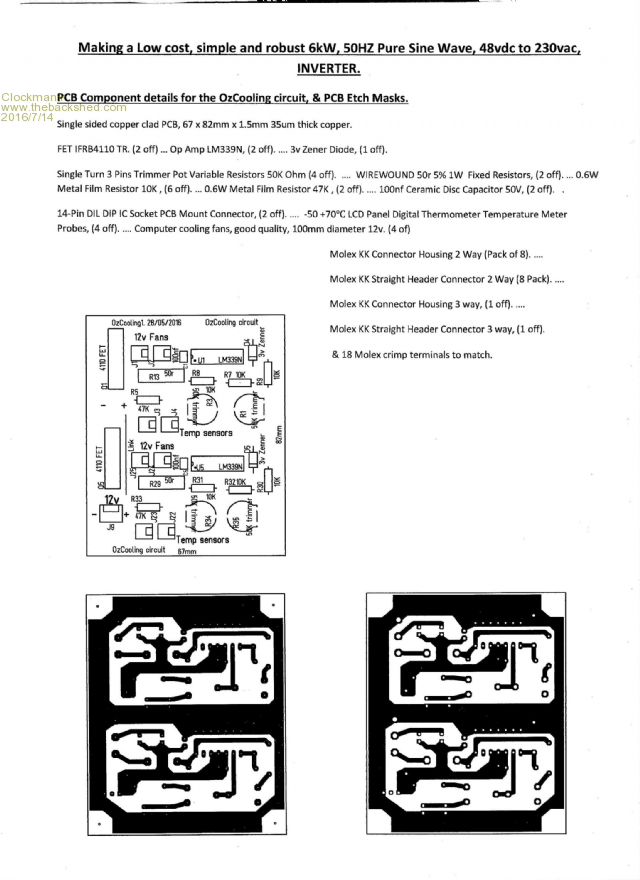

Posted: 12:10am 14 Jul 2016
OzCooling board and list.
Not sure if these images are coming out here?

Posted: 12:25am 14 Jul 2016
thanks clockman. I see an extra led and the jumper pins have moved as well.
I was using the photo to mentally tick things off Phill's list.
I noticed Oz had put a heatsink across both TIP35 and I wondered if they had been shuffled around on the PCB so they line up.

Posted: 12:41am 14 Jul 2016
Yes, both TIP35 on that new board, now line up.
I have put these heat sinks on, readily available and cheap.

Posted: 12:47am 14 Jul 2016
Images...
The French authorities here are blocking some Aus sites, so I use a Proxy server in Germany.
However my French Satellite system sometimes throws stuff out if its slightly largish.
I will try again but size down a bit?
