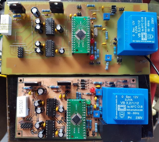

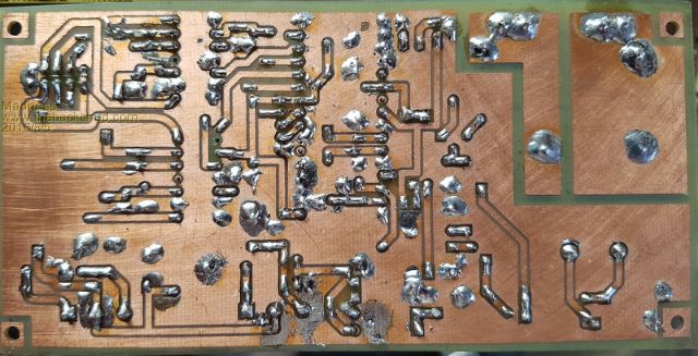

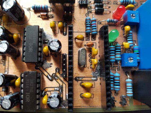

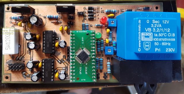

Been busy with work but have made some progress, I have redesigned the control board. My plan is to get a few made professionally, so I have made it double sided and reduced the size so it will keep costs down. The only change I have made to the circuit is to add pins to connect an LCD display, I figured this may be helpful at the testing stage if nothing else.
Finally found a reliable method to do toner transfer for etching.
1 Print top and bottom onto glossy paper with Laser Printer
2 Staple the 2 sheets together with toner on the inside and perfectly aligned
3 Clean PCB with fine sand paper
4 Cut the leading edge of the paper so that just the edge of the PCB is exposed when PCB is in the correct position
5 Run this through a laminator at maximum temperature and minimum speed a few times, leave the laminator running
6 Then put the pcb with paper still on in the oven preheated at 165 degrees for 5 minutes
7 Put straight back through the laminator several more times while hot
8 Soak in water with a bit of detergent for 10 minutes
9 Rub off the paper with your fingers, if done properly the toner will have stuck very well and won't rub off
10 Dry it out and etch, I use 2 parts 3% peroxide to 1 part hydrochloric acid
11 Once etched clean off the toner with Acetone
12 If you want a silk screen repeat with a sheet on the top with silk screen printed on it
The oven stage could be eliminated if you can get the lmintator to a higher temperature
As yet I have not put power on either board, trying to find a supply of spare smoke before jumping in the deep end.
My Mosfet board is almost completed also, just adding wires for power in and out for testing, once again it is only a prototype and will get some of them manufactured also.

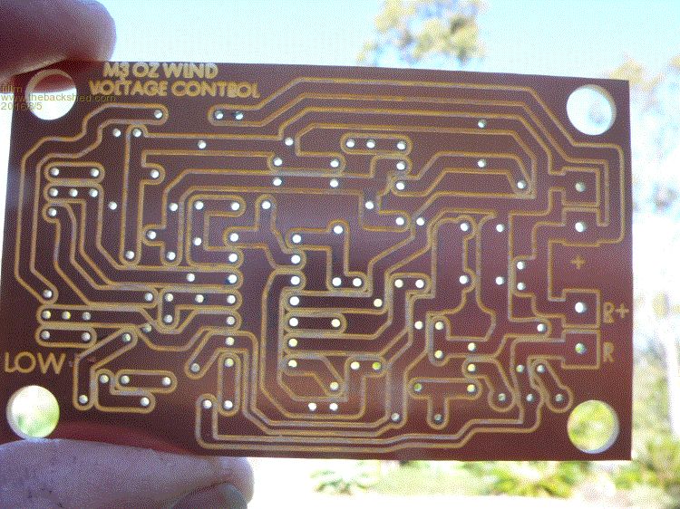

Looking good, mine has come to a halt for a bit but on the subject of PCBs. I have done mine in the CNC but its a pain to get from express .pcb or gerber into DXF.
Below is a pic of a Wind Control board I was doing a couple of years back but have a far better solution now.

Posted: 12:14am 06 Aug 2016
Md,
The CNC is fast and exact as you would of course know but I dont think punched tapes is CNC ( Computer Numerical Control ) . Then a workshop full of highly qualified machinists is now replaced by one person looking through a window of an enclosed cutting booth. A good friend has a very large hydraulics workshop full of CNC machines. The last one he bought was well over $300K and it does not bat an eye lid at 10mm cuts.Its mind blowing what is out there these days
Anyway the main problem is the material left , as you can see the fine copper lines
between cuts and it can take a lot off the neighboring track and also leave a copper fiberglass powder in the track. It has to be cleaned and checked. This was just one method I was playing with and in Cambam it will cut with a PCB isolate style but what I can gather from the Gurus is that you just draw the circuit with in CB.
I have not explored it all to far but it would be better to be able to convert gerbers ect ... But having time to try and get it sorted ..one day.

Posted: 02:58pm 07 Aug 2016

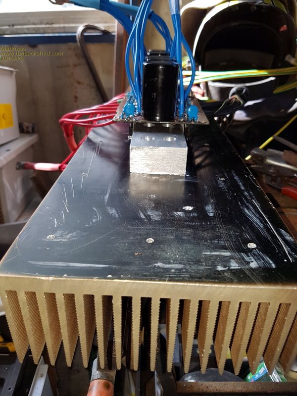

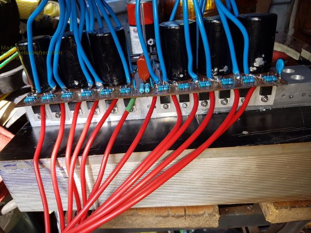

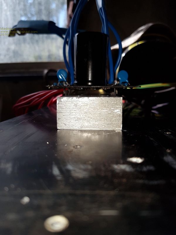

A little more progress, I have now attached the power PCB to the heatsink. This was done with a 50 X 25 X 300 mm piece of aluminium, it is screwed to the actual heatsink with 12 6 mm Allen screws with thermal paste in between to get a good thermal transfer. Drilling and tapping 24 M3 threads for the Mosfets was a slow job as the drill bits wanted to clog, so had keep cleaning the drill about every 1 mm of hole depth.

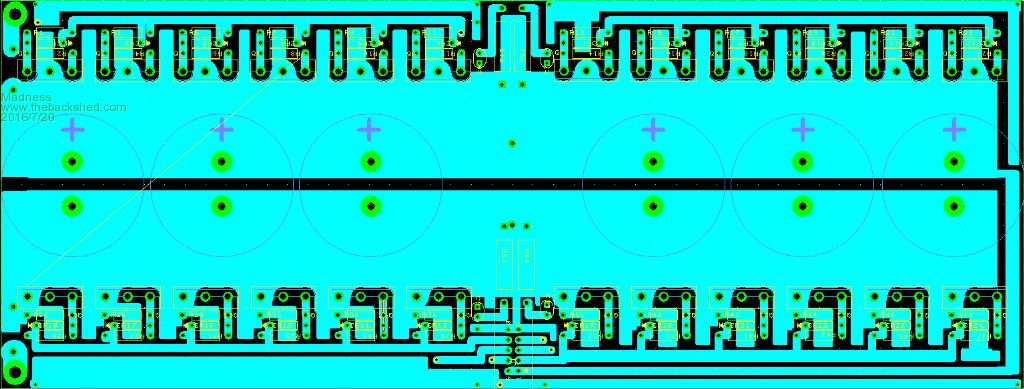

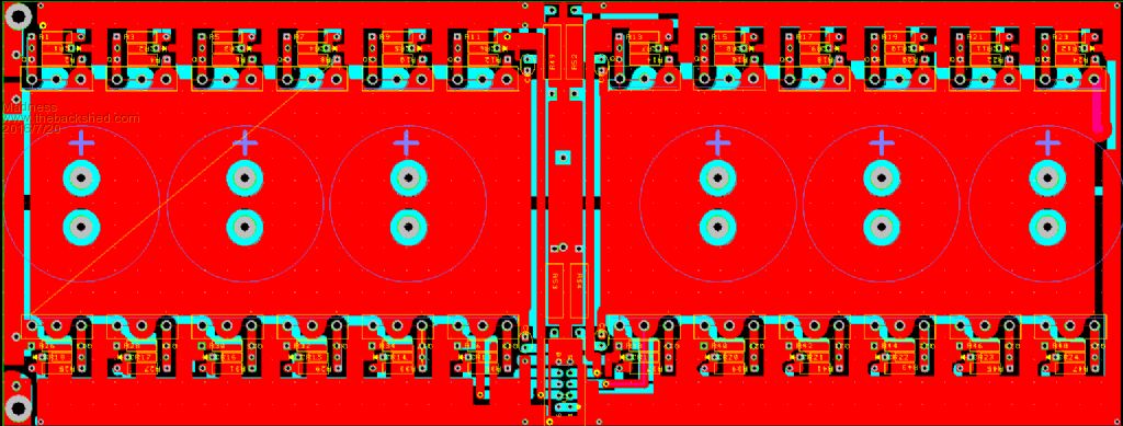

This PCB will be replaced with a new one with copper bars instead of all the individual wires, also with IRFP4110PBF MOSFETs. The PCB has the pin spacings to suit the heavier duty MOSFETs so they will have a minimal lead length to the PCB.
This build of the PCB is more of a prototype to check the design before getting some manufactured.
