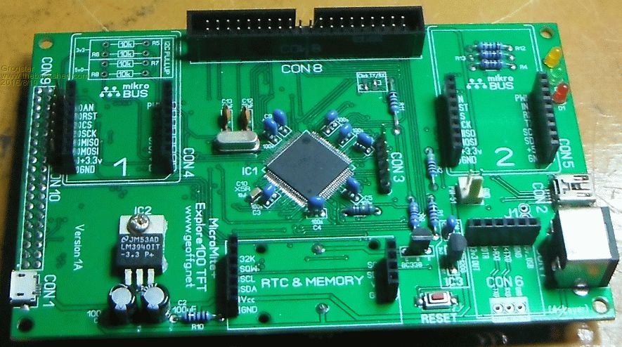

Pin-51 is input-only, and was spare, so it was routed out to that header along with a ground pin, just so you can use Pin-51 if you want to. Better to route it out then leave it buried in the 0.5mm pin-pitch, then people can at least use it if they want to.

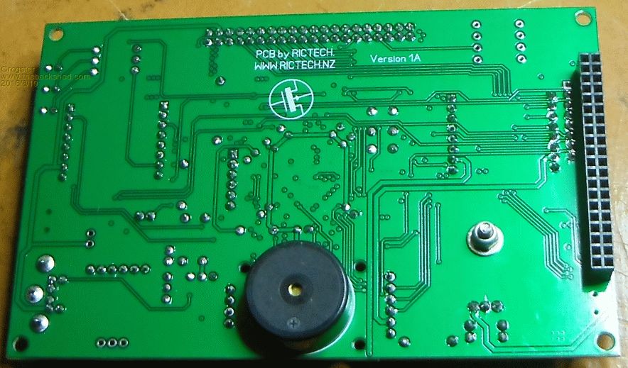

CON9 - Female header is meant to mount on the same side as the Piezo, so that you can plug an LCD directly on to the back of it. That is how it was designed to stack anyway. You COULD put a box-header on the top side, and use a ribbon-cable to link to the LCD if you prefer.

You're right - the box around CON9 on the top is a little confusing. I will remove that in any future version of the board, and make sure that is on the other side.

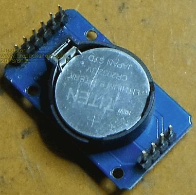

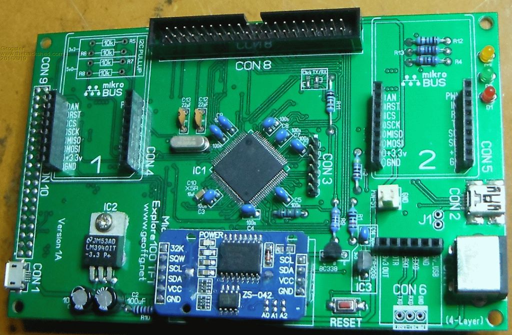

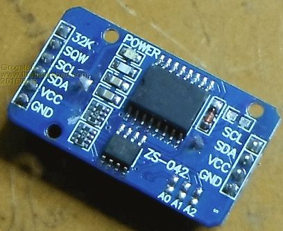

Female headers on the RTC, and you remove the right-angled pin-strips on the eBay-type RTC module, and replace them with straight pins, and then the RTC can plug directly into the board.

for the misplaced connector, use a pair of snipe-nosed pliers to grab the pins one at a time, heat pin and pull out. the connector will be somewhat destroyed, but the PCB will be unharmed. then use solderwick to empty out the holes, or just heat and tap GENTLY on the edge of your bench (my preferred method).
edit: i was looking at the connector on the top edge of the board. i would still favour destroying the RHS connector (though this will be a bit harder) so that the pins can be removed one-by-one.
unless the piezo is active (ie, a fixed frequency device containing a transistor oscillator and driven by DC), it will be unpolarized. the housings often have a polarity mark simply because it is cheaper for the manufacturer to make just the one type of housing and use it for both active and passive devices.
the 4 pins on one end of the RTC module are passthroughs from the 4 similarly marked pins at the 6-pin end. grogster: might i suggest removing the text markings from the 4-pin end on the next revision of the board, as these pins are just being used for mechanical support?
