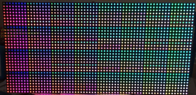

A better picture showing 4 blocks of all 512 colours.
Still not full justice to what I am seeing on the actual panel. There is much more distinction between the colours than you see in the above photo; especially the Blues and Greens towards the top right corner.
For anyone wanting to try this out, here is the code:

Posted: 11:41pm 14 Jul 2016
Thanks WW, I'll hook mine up later and give that a try, it looks pretty good already in the picture
Posts: 2998
Posted: 12:39am 15 Jul 2016
@lew247
Make sure you are using Peters latest RGB333 driver
i.e. last post on Page 3 of this thread. Don't be confused by the comment near the top of his code which states RGB222 Edited by WhiteWizzard 2016-07-16

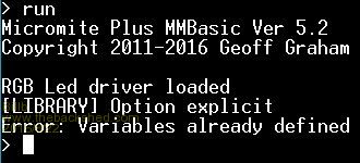

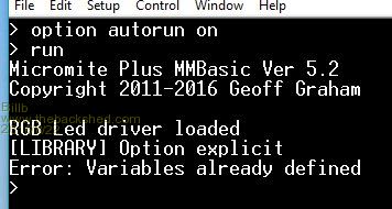

Posted: 12:31am 22 Aug 2016
Hi Peter
Just loaded your RGB Driver into my explorer 64 and connected to a 32 * 64 display.
All worked OK.
My problem is I wand the program to auto run at power up.
inserted option autorun ON in the program, This does not work.
Removed and typed option autorun on at the command prompt then ran program,
repowered and the program did not auto run.
typed run at the command prompt - worked OK.
The following is the error message received on both occasion.
hope you or any one can help.
Regards Bill

The driver should be loaded into the library as-is with nothing else (or with additional subroutines that only use local variables). The main program should be in normal memory. Include autorun on at the top of the main program. Restart, should be no errors. Then run the main program by hand once. After that it should autorun on restart. If this doesn't work you are going to need to provide program listings of the main program and whatever you have in the library in order to help further.

Posted: 11:13am 22 Aug 2016
Hi Peter
Thanks for the reply.
The only program in library is the RGB driver.
to ensure, I reloaded ver 5.2 and saved the rgb driver to the library.
The program I used to test is your demo with the autorun added.
The results are the same as before.
[code]
Option autorun on
Option explicit
option default NONE
dim integer i,x,a
cls
TEXT 2,16,"geoffg.net",lm,8,1,RGB(red)
DO
FOR x = 64 to -60 STEP -1
TEXT x,6,"Micromite+",lm,8,1,RGB(green)
a=4-x
TEXT a,26,"Micromite+",lm,8,1,RGB(magenta)
box a-64,22,64,8,0,0,rgb(black)
pause 50
NEXT x
LOOP
[/code]
Posts: 12176
Posted: 09:33pm 22 Aug 2016
I can replicate the issue exactly as you report. I've reported this to Geoff as I can't make any sense of the problem. I don't think you are doing anything wrong or abnormal in any way.

If you change mm.startup from
sub MM.startup
const OE=21
const CLK=51
const LAT=52
RGBled64(LAT, CLK, OE)
font 8
end sub
to
sub MM.startup
RGBled64(52, 51, 21)
font 8
end sub
I think the problem goes away. Please substitute your pin numbers and let me know
Definitely one for Geoff!!!!!
Edited by matherp 2016-08-24
Bill.b
Joined: 25/06/2011
Posts: 249
Posted: 11:41pm 22 Aug 2016
Hi Peter
Applied the change you suggested.
Now it is working OK.
Thank you
BillEdited by Bill.b 2016-08-24

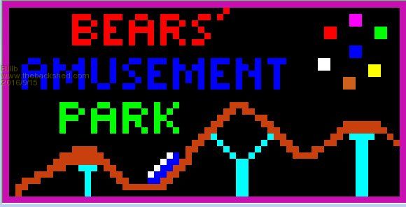

[/code]
The images are created in Paint Shop Pro on a 32 * 64 pixal page.
