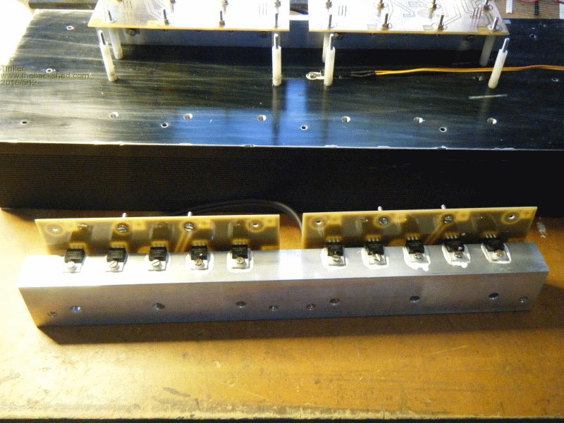

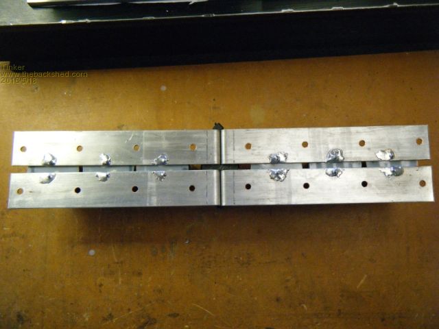

A little more progress with the build:
This is one of the two sub heat sinks. My design idea requires the mosfets to be fully insulated from the heat sink. I used mica washers and plastic screw insulators. I also tested each one with a home made 80V test lead (just a LED with a series 5k6 resistor) as testing with the usual low voltage multimeter buzzer would not do in this 50-60V application.
Plenty of heat sink compound at the mica washers and between the sub and main heatsinks.
A strict sequence of assembly has to be employed with this idea. Also the holes have to be drilled quite accurately so everything lines up on assembly. A hint if anybody is thinking of copying this; make sure holes drilled into the main heatsink go in between the fins. It is so much easier to tap a through hole than a blind hole.
I used 6 x M5 hex bolts to screw the sub to the main heat sink. These are accessible from the side of the PCB above them, other screws would not be.

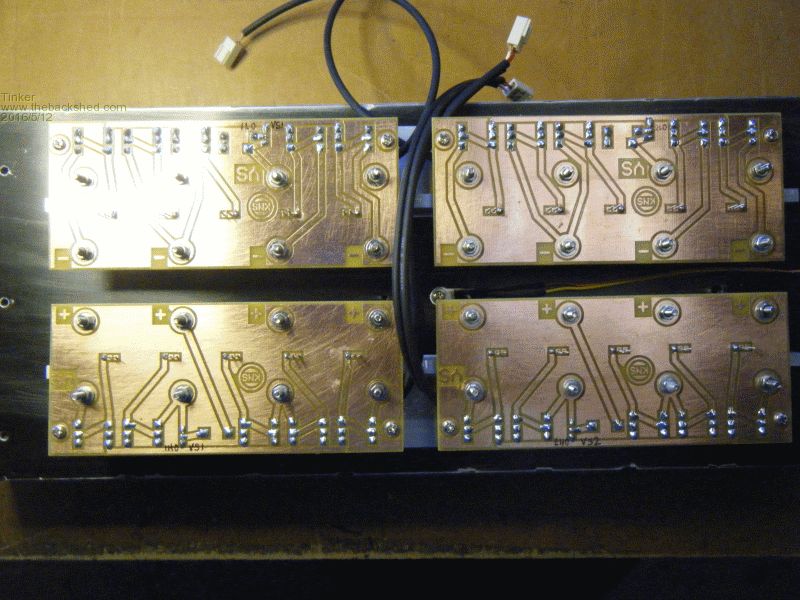

Here are the 4 boards in place with the gate leads soldered on:

Fiendishly good engineering there Tinker...
It deserves to work very well.... there's plenty of good work in there, and significantly better than I would try and do.

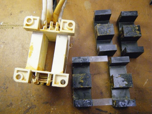

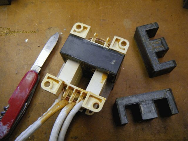

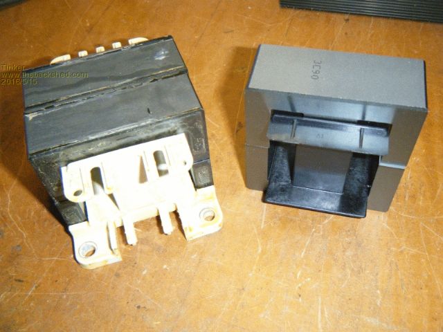

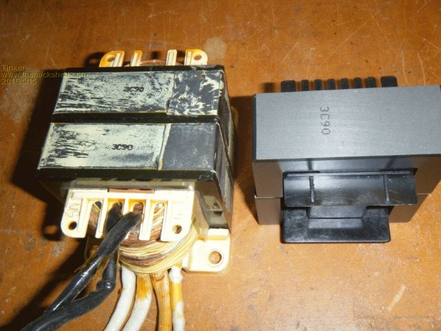

A few days ago the ferrite E-core which I had ordered on e-bay (from Bulgaria) arrived.
By sheer coincidence yesterday I found an alternative to this US$25.- option when I dismantled a junked 2.5KW Fronius IG 30 grid connect inverter to see if any useful parts were inside.
And I spotted this transformer:
It has the same number stamped on the core as the newly purchased E core pictured next to it. So I assume its magnetic properties are similar. But its a dual (stacked) core with a considerably bigger (875mm sq against 529mm sq)cross section. I think that should work even better, bigger is better I think .

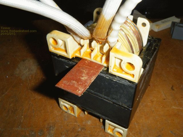

Unfortunately this transformer was lacquered solid so not easy to get apart. But I knew just the trick. I required a big opening screw top container where the whole transformer could fit inside. Found a plastic one and tested first if acetone attacked it - it passed this test.
So about 5mm acetone was poured in, the transformer followed (it remained above the acetone pool on a central raised part). The idea is to soak the lot in acetone fumes overnight, hoping that softens the lacquer, which it did.
Next morning the first job was to knock out the presspahn piece that jammed the bobbin against the core:
This came out quite easily with a 1mm thick brass strip being carefully tapped in from one side.
Now the bobbin was loose and I had to separate the two E cores:
I used an old swiss army knife and tapped its blade carefully in the groove where the cores met. Ferrite is *very* brittle so great caution is required to do this.
But they popped apart relatively easy.
Next the E core halves needed to be separated. There is no groove for the knife there and the mating surfaces are ground flat with a very thin plastic shim between.
Carefully knocking on the whole core with a fist sized lump of wood eventually popped the halves apart with no damage.
The HF litz wire windings came off quite easily, there were not many turns anyway.
Now, after a little cleaning, I had another E core to try out.
The winding area on this bobbin is a little bigger, 14.5 x 35mm against the 11 x 40mm of the purchased item. I will be using enameled copper strip wire and should be able to fit 4 turns (3 in hand)giving around 70mm sq total copper section on it.
The best part about this bobbin are the mounting holes, no need to make a fancy collar to secure this ferrite choke.
I will secure the core halves together with epoxy once the correct plastic shim size had been found experimentally.
There is also a smaller ferrite core transformer in these inverters which might be useful.

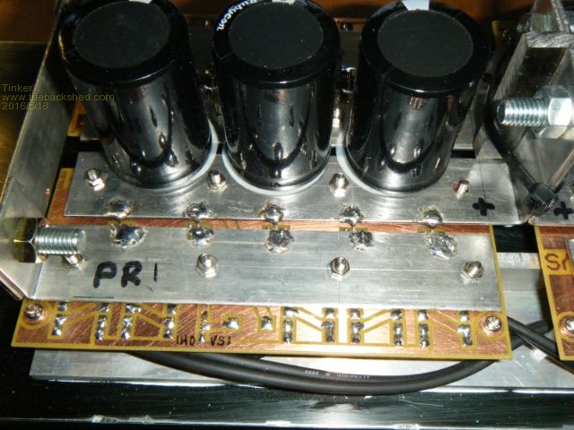

OK, more progress pictures.
The 6 x 10,000uF/100V capacitors had arrived so I could solder them onto the copper strips.
This turned out to be trickier than anticipated, a 25x1.5mm copper strip sucks heat away really fast. I used a 80W non temperature controlled iron which is a bit on the small side. I think a 100 or 125W iron would be much better. Anyway, I managed after giving the iron a short reheat spell after each solder joint.
I made plastic disks to fit in between the cap bottom and the copper strips for extra insulation. I really do not want the cap housing short out the battery supply.
To avoid cooking the cap insides the copper next to the cap terminals was heated until the solder flowed freely, only then the terminal was soldered. This produced joints looking a little messier than as is my standard but making sure its not a dry joint.
Next was to fit the capacitor assembly to the 4 PCB's. Despite me aligning the copper strips carefully while soldering the caps some of the screw holes used to mount the assembly required a little visit with a small round file, I suppose that is inevitable with this method of mounting.
Now the drain and source pins of each Mosfet were bent over their respective copper strip and soldered. Again, a bigger wattage soldering iron would have been nice.

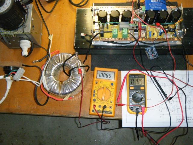

So, after fitting the 230V board and EGS002 motherboard everything was ready for testing.
I had the EGS002 board unplugged for this stage.
First off check the 55V to 12V DC to DC converter - OK
Next check the 5V supply - OK
Then set the current overload potentiometer for shutdown at 8KW. This setting is very easy to change later should it be required.
It required 10A AC to pass through the C/T hole. My little test toroid (1.2KW) was used to get the 10A. A single added turn to the toroid passed through the C/T hole and was shorted with a 10-A AC amp meter.
The toroid's 230V winding was fed by a variac transformer, this then just required increasing the primary voltage slowly until the meter showed 10A.
I set the current adjust pot for 0.15V at the EGS002 current sense input.
Now my inverter is ready for load testing, which I will do tomorrow.
Posted: 11:04pm 18 May 2016
It worked, me is very happy now
I used the same small toroid shown above to test it and this was only good for about 1Kw. The driver board shut down promptly when I connected a 2.4Kw load as the AC output voltage just collapsed with that overload.
The dual stack big toroid should fix that limitation .
The AC voltage adjusts nicely and the soft start switch works perfectly. Thanks oztules for pointing me in the right direction with that one.
