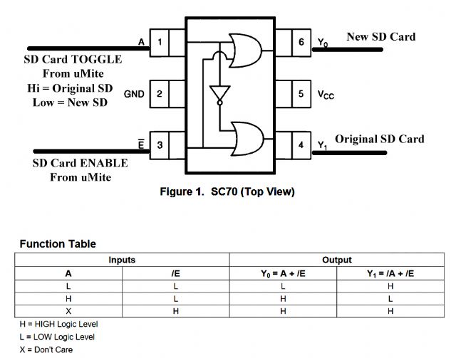

GDay Kon, All,
Why not use a small bit of hardware to do it instead? I don't know about the complications in the software with files open etc but to put an idea into the mix something like this very cheap chip ($0.11ea from Element14)
NC7SZ19P6X
They are also very small at 1mm x 1.5mm in size.
You could set an extra uMite pin as a toggle and wire it like this:
Then it is a simple matter of setting the TOGGLE pin HIGH for the original SD card and LOW for the NEW SD card. If necessary then close any open files before doing the toggle.
Anyway it is an idea that may fix your issue.

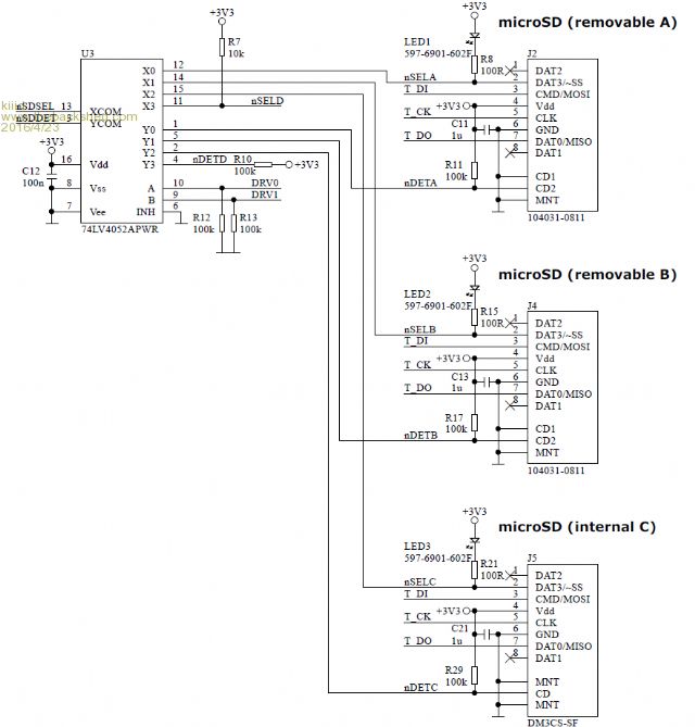

kiiid
Joined: 11/05/2013
Posts: 671
Posted: 09:02pm 22 Apr 2016
Hi Mick, this is somewhat similar concept to what I am using. It is possible for me to modify the MMbasic so it can support more devices. I am reluctant to do that though, because once out of the mainstream development, I would need to do that with every next revision which Geoff releases, and speaking in more general terms, I would much rather stay on the hardware side.
http://rittle.org
Posts: 3372
Posted: 09:37pm 22 Apr 2016
That looks like a pretty good solution Kon. Where is the problem? Do you want to support more than four SD cards?
kiiid
Joined: 11/05/2013
Posts: 671
Posted: 09:55pm 22 Apr 2016
Hi Geoff,
I don't think anyone ever would need more than four devices. In another device which is also built around the MM, I am using two cards, each one of them selected by its own CS. Obviously one of them is currently not usable because OPTION SDCARD can specify one pin and from that point it is driven automatically.
This part here with the multiplexer is an extract from the schematic of my ELLO 2M computer (which I am planning to release public pretty soon, once I announce it officially). Of course I can drive 'manually' the DRVx pins to select the needed device, but the reasons why I am still not doing that I explained in my previous post.
PS. There is another little function which I think MM is currently missing and I only discovered that yesterday when I actually needed it - the equivalent of ~ in C. Maybe something like NEG()?Edited by kiiid 2016-04-24
http://rittle.org
Posts: 3372
Posted: 10:04pm 22 Apr 2016

Posts: 3372
Posted: 10:14pm 22 Apr 2016
  kiiid said  Of course I can drive 'manually' the DRVx pins to select the needed device, but the reasons why I am still not doing that I explained in my previous post.
Ah, that would be the perfect application for a small BASIC sub placed in the library.
Something like this:
Sub SDCARDn as Integer
Port(pin, 2) = n
End Sub
You would then have your own command (SDCARD) without hacking the source.
