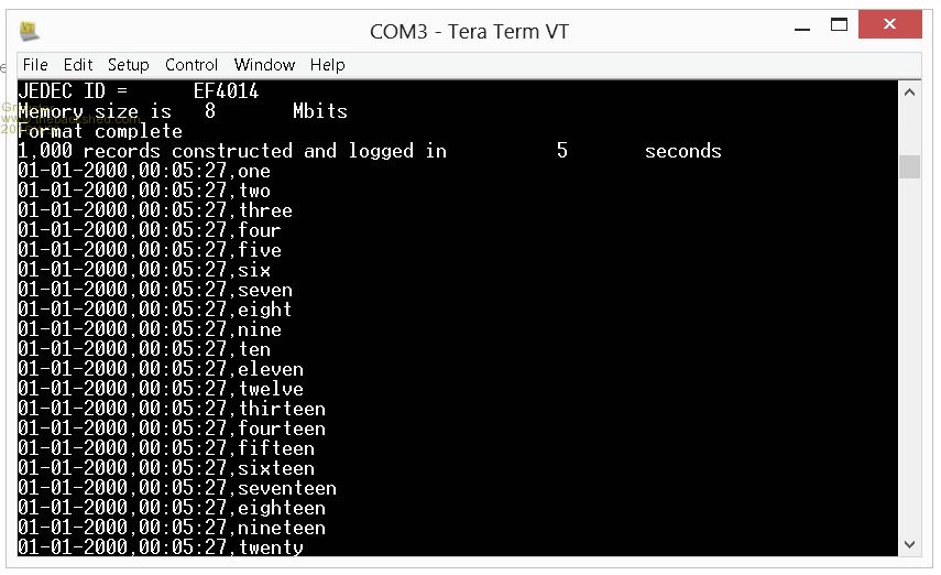

I'm impressed with the demo program - 1000 records written to the SPI memory in five seconds. 200 per second! That's really quite impressive on the speed. I don't think you would have a hope of getting that kind of speed out of I2C would you? Even at 400kHz. I know there are high-speed I2C EEPROM's now, but my new love in memory is SPI type.
Wow.

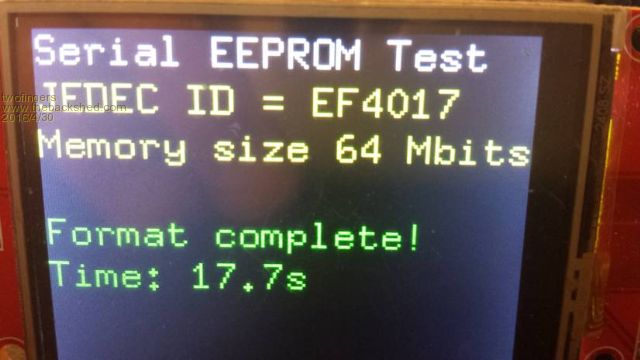

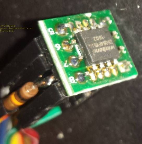

I use a MX170/28PIN/48MHz (Micks Backpack170) + W25Q64FVSSIG (8MB) and I needed only to make one very little modification.
Sub formatlog(cspin As integer) 'erase the chip and set up the page index
Local integer i,bytecount,r(2)
Local s$ length 10
Timer=0
SPI open 20000000,3,8
Pause 100
bytecount = getpagecount(s$,cspin)*256
gives me this:
JEDEC ID = EF4017
Memory size is 64 Mbits = 8388608 Bytes
Format complete! Time: 17.837
1,000 records constructed and logged in 7 seconds
01-01-2000,02:11:41,one
01-01-2000,02:11:41,two
01-01-2000,02:11:41,three
01-01-2000,02:11:41,four
01-01-2000,02:11:41,five
01-01-2000,02:11:41,six

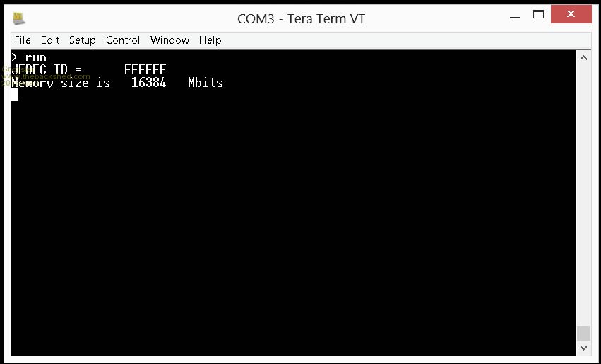

without the PAUSE command I got something like this (after a rerun):
JEDEC ID = FFFFFF
Memory size is 16384 Mbits = 2147483648 Bytes
My MX170/28 connections (CS=24)
' pin 1 (chip select) - connect to any Micromite output capable pin MM-24
' pin 2 (Data out) - connect to the SPI-IN pin on the Micromite MM-14
' pin 3 (write protect) - 10K resistor to 3.3V MM-VCC (10k)
' pin 4 (GND) - connect to ground MM-8 (GND)
' pin 5 (Data in) - connect to the SPI-OUT pin on the Micromite MM-3
' pin 6 (Clock) - connect to the SPI-CLK pin on the Micromite MM-25
' pin 7 (Hold) - 10K resistor to 3.3V MM-VCC (10k)
' pin 8 (VCC) - connect to 3.3V MM-13 (VCC)

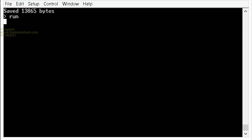

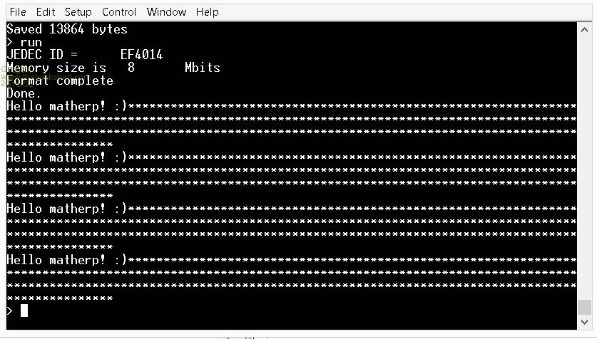

matherp - I cannot make these routines work when separated from your example code.

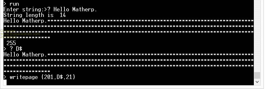

Trying to call WRITEPAGE crashes the MM+ and I have to press reset - CTRL-C does not get me out of this issue.
Initial test code ran first, and that completes fine, and reads back fine, so I know that the MM+ is indeed talking to the SPI memory.

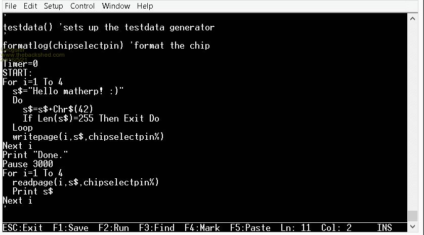

My test code is:
...and the results are:

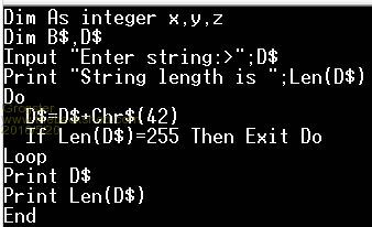

Note that I am building a string with a length of 255 bytes to write to the SPI memory with the writepage sub. This is shown on the console.
As soon as I issued the writepage command, the MM+ crashes.
Can you offer any reason for this?

Posts: 10116
Posted: 05:12pm 20 May 2016
Cheers, I will try that out and get back to you.
With the above example of mine in mind, and bearing that it is 255 bytes long, can you state if my method at the command line SHOULD be working but isn't, or do you happen to think that this would not work anyway?
IE: Can the Csub's for read and write be run from the command line? Perhaps they have to be inside a running code - I have not tried that, so I will also test that theory.
I believe that I have the command syntax correct, and D$ in my example is 255 bytes long, so that should keep the CSub happy, I would have thought.....
EDIT: I found something. By changing your example code line-by-line, I have found that inserting my code example into your loops works, and reads back.
The key is that if you DON'T allow formatlog on line 12 to run EVERY time you run the code, the writepage routine crashes the MM+. If you let formatlog run as part of the code, then it works, but I can't have the code erasing the chip everytime you want to write something to it.
Comment-out line 12, and run the code you sent me - you will see what I mean.
Do you have any idea why the writepage CSub would care about the formatlog routine needing to be a prerequisite?Edited by Grogster 2016-05-22
Posts: 10116
Posted: 07:30pm 20 May 2016
Here are some screenshots.
My code changes:
The result of four write/reads:
Now, if I comment-out line 12:
Posted: 01:48am 21 May 2016
The SPI channel needs to be open to use read and write page commands. This is normally done if a TFT display has been enabled (OPTION LCDPANEL ...) or if you call getpagecount. If not you need to explicitly open the SPI channel. In the case of the example you could do this with
SPI2 open 10000000,3,8
The assumption was that any program would call getpagecount so you know what size flash you are using
