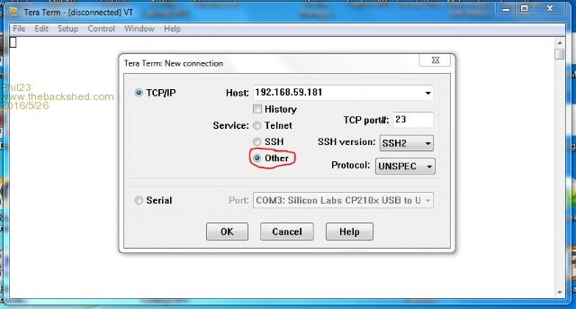

Hi Mike,
I also had issues connecting to it with Teraterm.
It would connect, then drop me back to a prompt which was not the MMbasic prompt, but a prompt that talked to the ESP8266.
Got it working fine now & all I changed was service type in the Teraterm connection setup.
Don't know what it really means, someone else can maybe explain.
Cheers.

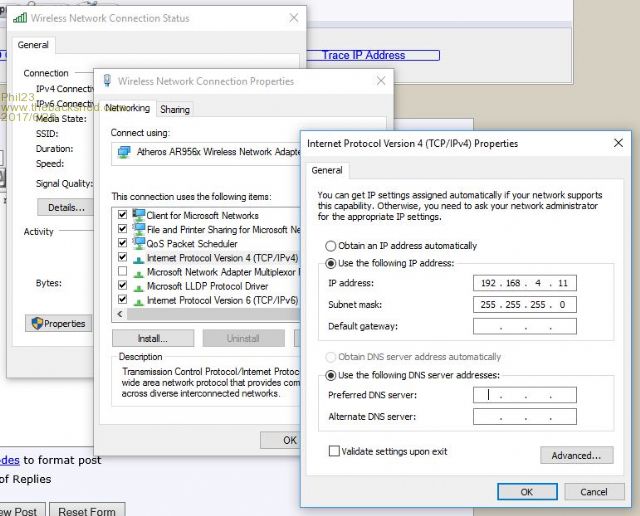

So you will need to set the IP addresses manually yourself.
Bit like this.
In your case I'd be setting the PC to say 192.168.4.11 and then giving the ESP an station address of 192.168.4.1. (So it has the same IP when it switches to station mode).
Neither the PC or the ESP will need a gateway address, as that is the address of the device that connects to the internet.
So once all that's done, you will be able to connect to it In MMedit with 192.168.4.1.

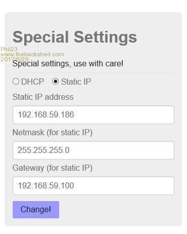

So by setting your IP's as static, you will be able to connect to it in both modes.
I've got 9 ESP's running here & they are all have Static IP addresses.
192.168.59.181-189.
They connect to Micromites 1-9.
So all I do is choose the appropriate IP to connect.

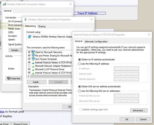

Phil23
Joined: 27/03/2016
Posts: 1667
Posted: 10:38am 29 Jun 2017
This is what you need to reconfigure on your PC,
The IP4 settings.
Phil.
davematt
Joined: 27/09/2011
Posts: 55
Posted: 02:28pm 29 Jun 2017
Success!
Many thanks Phil. Setup exactly as you suggested and now working just fine.
What a handy little widget!
Cheers, David
