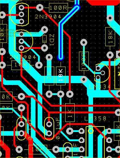

ERRATA
I've just built up the complete PCB by moving the components from my prototype.
There is one silkscreen error. The resistor shown in the picture is marked as 10K but should be 18K
Other than that the board works perfectly. Note R25 and R47 should be 100K as per the schematic. For some reason the value didn't make it to the silkscreen.

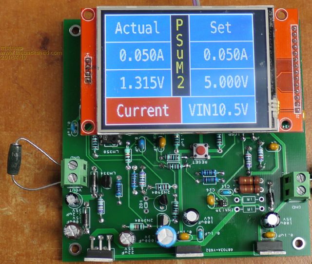

How critical is the resistor I have built the board with the components as marked, difficult to remove components from plated through holes.
Just wondering is this the board I sent you.
Cliff.
Cliff
Posts: 12185
Posted: 02:31am 19 Apr 2016
  Quote  Can you look which package of the LM334Z
This one
  Quote  How critical is the resistor I have built the board with the components as marked
Critical I'm afraid - this resistor sets the opamp gain. To remove just heat one pad with the soldering iron and then pull that end of the resistor with a finger nail. Then hold the resistor and heat the other pad to remove. To clear the holes heat with the soldering iron on one side of the board and then with your mouth close to the other side of the board (but not too close ) blow hard as you remove the soldering iron - this will leave the hole clear for re-use.

Here is my board up and running - thanks Cliff

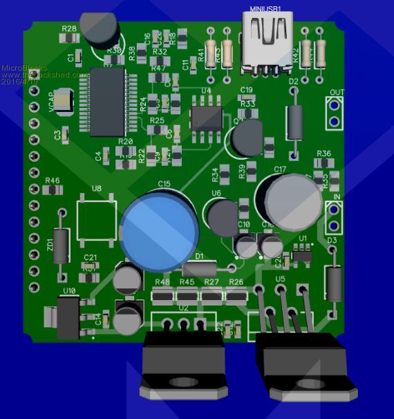

@Matherp,
I am busy with laying out a small pcb. I like to mostly use SMD parts.
Looking at the resistors i noticed that many of them will not have much current going through them and it would be possible to use a 0.1w smd versions.
Higher wattage is difficult to source.
Could you help me out and specify which resistors would absolutely need to be 0.25w.
The 1 Ohm current sense resistors i already have 1W versions and also for the backlight i am using a 0.5w. I am just wondering which of the rest that are currently 0.25w could be substituted with a 0.1w.
I am also going to use it up to maximum 16v/1A output using a 19v input, if that will make a difference.
Would that be a 27 Ohm resistor as the load?
Maybe a nice add on feature to measure resistance, with a low enough current set it would be save to do.
This is my progress so far (50x50mm)
Edited by MicroBlocks 2016-04-20
Posts: 12185
Posted: 09:21pm 19 Apr 2016
  Quote  Could you help me out and specify which resistors would absolutely need to be 0.25w.
0.1W is probably fine for all the others except perhaps the 10 ohm resistor feeding AVDD. You would have to look up requirements for AVDD in the Microchip datasheet
  Quote  Would that be a 27 Ohm resistor as the load?
Yes
  Quote  Maybe a nice add on feature to measure resistance, with a low enough current set it would be save to do.
That is doable, you could also display power. I'll leave it up to all you good folk to add features to the Basic code as you wish

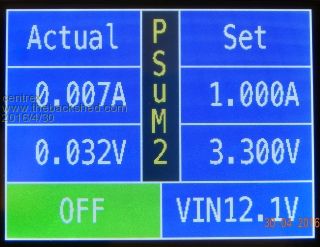

I have the power supply running and calibrated as best I can.
I have noticed a couple of things.......
There appears to be a residual voltage and current shown on the display and it also appears across the 10 ohm load measured with a multimeter this is with the unit "OFF".
Also if I turn off the supply to the unit, when I turn the supply back on I have to reset the current section otherwise it goes direct to the current limit mode.
Perhaps this is normal, maybe Peter can give an answer.
Other than the above it works very well I am most pleased.
Cliff
Cliff
Posts: 12185
Posted: 08:59pm 29 Apr 2016
  Quote  I have noticed a couple of things.......
PWM is switched off when in this mode so it must be that the 0V output of the uP is very slightly above GND. If you are worried about it I can only suggest putting a relay in-line with the output and switching it with a spare uP pin driving a NPN transistor.
  Quote  Also if I turn off the supply to the unit, when I turn the supply back on I have to reset the current section otherwise it goes direct to the current limit mode.
This is the bug I posted a fix to in the second post of page 5 of the thread
