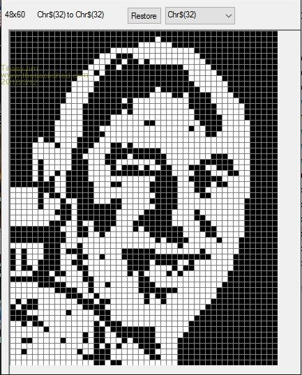

Posted: 08:03pm 11 Mar 2016
Working on the next step:
The image is of a 48 x 60 character but the font below is 64 x 80
cls
text mm.hres/2, mm.vres/2, " ",CM,8,1
end

Trying to get a decent black and white from a photo can be challenging and takes a bit of tweaking.
