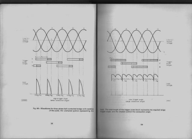

Here are some voltage waveforms for a three phase half controlled bridge.
With very late triggering (and a low output) the SCRs operate independently pretty much as you would expect.
As you advance the firing angle to be earlier, a curious double hump appears beyond sixty degrees and the whole nature of the waveform changes.
The waveforms below are for a resistive load.
Its a very difficult thing to visualise or to explain, you really need to watch it happen on an oscilloscope.
There are many waveform variations possible, a bridge can be half controlled or fully controlled, and the load may be resistive or inductive or a mix of both. There may also be a flyback diode fitted, and sometimes not.
And the waveforms can totally change their shape at some point in the control range.

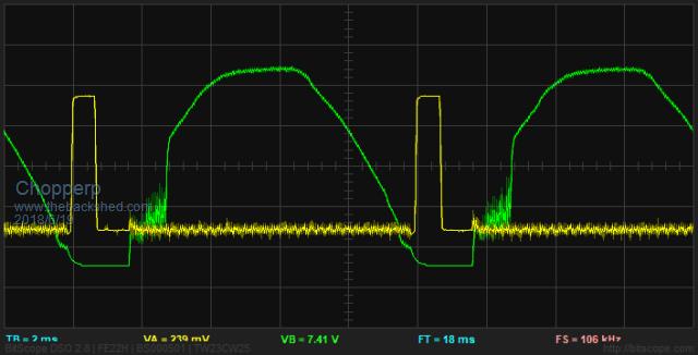

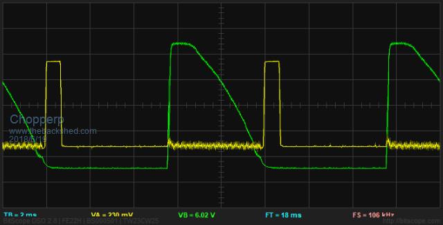

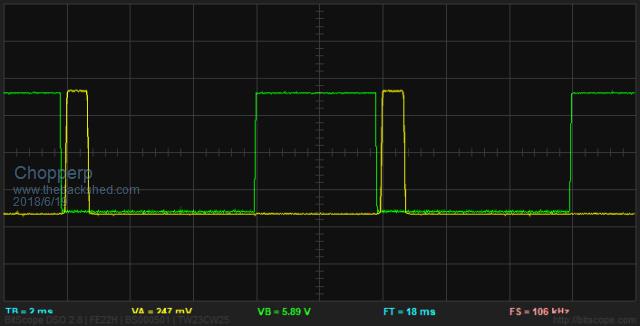

Update: My Mains triggered Phase Control progress.
From matherp's Csub Here , I've had some success in getting single phase PWM working.
The "oneshot" function gives the delay & width & with a bit of math in the program I was able to get the main pulse occurring ending just prior to the next trigger & working backward from there.

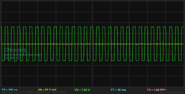

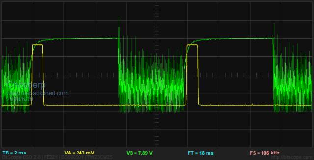

I also gated in 15000Hz pulses for high freq transformer triggering of the SCR.
The first main problem I came across was that the two pulse trains continued when the program was stopped. This is normal operation but not good for this situation. After a fair bit of head scratching & experimenting, I ended up having a signal O/P generated by the program, AC coupling it to a rectifier which supplied volts to a transistor which kept the gating circuit energised. If the program stopps, the gating pulses also stop.
The other thing was to set the limits for the delay so false triggering would not occur & the pulses occurred within the correct time frame. Also the delay & width variables have to be integers.
The gated output is fed to a driver circuit which feeds a small transformer with it's secondary connected between the gate & cathode of the SCR. The SCR was connected in series to the output of a 4A (nom) battery charger with about a 30 ohm element for a dummy load. This load was a bit light on for the SCR used. It's holding current was too low at the low voltage ends of the input.
I've only implemented manual control over the output width at this stage. Both o/p voltage & current feedback (among other things) are still to be implemented.
The ultimate goal is for a 70V, ~20A battery charger & a high current power supply. (Yes I know SMPS's is probably the better way to go but this is fun)
Code, some Photos & rough circuit shown following.
Thanks to all especially to matherp for the lightning fast Csub.

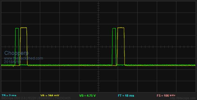

Oneshot pulse (green) occurring just before the next trigger pulse (Yellow). Min O/P

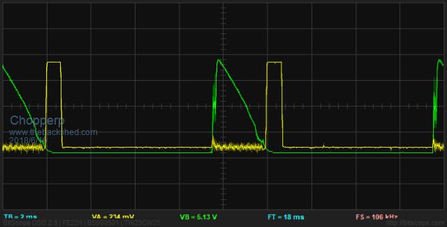

Oneshot pulse at about 50%. About half power

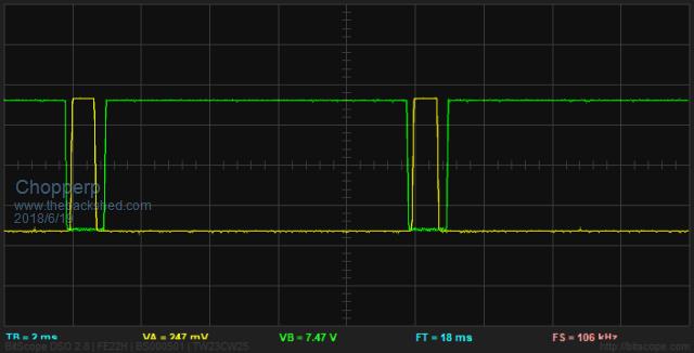

Oneshot Pulse occurring just after the trigger pulse. Near full power
The PWM O/P Trigger signal (15000kHz)
Combined (gated) Oneshot & PWM pulses at about 50% (inverted)
SCR output pulse at about 25%
SCR Output at about 50%. Note flat top AC
SCR Output at about 80%.

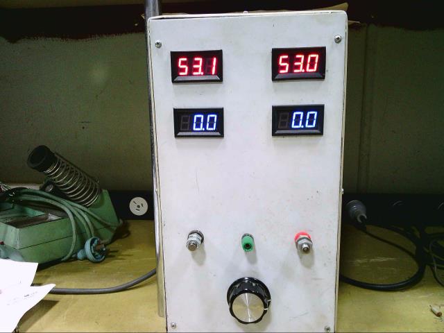

I built a Frankenstein bench power supply into an old computer case.
0 to 100v (+50v and -50v) at 25 amps.
It just has a big knob and uses phase control on the mains side of the transformer.
As rough as guts, no voltage regulation, no current limit.

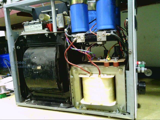

Its a centre tapped transformer with a bridge rectifier. Two chokes, and two plus two 22,000uF 63v electrolytics to give me positive and negative supplies with respect to ground.
This is a real junk box hot rod special, only things I had to buy for it were the digital panel meters and some 12v plug packs to supply dc to the control system and panel meters.
I don't worry about fine details like like voltage regulation.
Just wind up the wick until the load comes to life, and that is about it.
Its only ever used for those quick dirty jobs....
The chokes were made for me by a long term mate that has a transformer winding business. I don't know what they are worth, this was a freebie return favor job.
Each has a one and a quarter inch stack of two inch laminations with a 1.5mm air gap.
There are 72 turns of 6mm x 2mm rectangular copper.
No load inductance measures as 4.24mH
It still has 3.07mH at 25 amps dc.
If I ever did measure the saturation limit, its not on my now ancient scrap of paper in my file.
Thought this might interest some of you blokes that probably have a mountain of similar old parts out in the shed just sitting around.Edited by Warpspeed 2018-06-21
